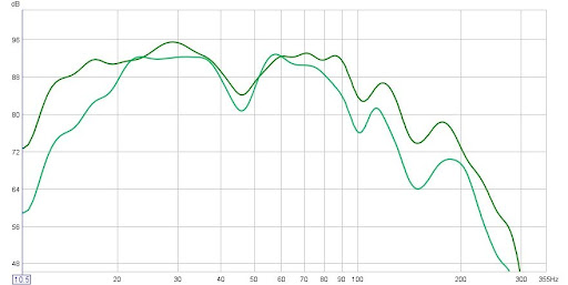

My sub measures like so: dark green with eq, light green without. The dip is a room artifact, it becomes a boost by moving the listening position a foot and a half or so...still, that's a +/- 5dB graph from 15 to over 100Hz....it's actually a little worse, this is 1/3 octave smoothed...
But I saw the pics of the construction of your place...much more solid than the sheetrock/stud/osb/siding combo I have...which means more room gain for you...

Bottom line: For the money, the THT is the best thing going that I can think of, subwoofer-wise. If someone else has a sub they made or bought for less than $450 (with amplifier) that can belt out 115dB 11 feet away with less than 5% THD, I'd like to know. I'm sure there are some tapped horn designers who could get something like that, but most folks don't want to design something from the ground up...the THT's instructions are very good...
JSS
I'm in.
I was persuaded early in this thread.
But, what sealed the deal was your post of the TT/THT data (post #44).
The only reason I haven't placed my order yet, is I need to compile a shopping list for PE.
I'd better hurry though, I have a feeling that the Dayton DVC 15s will start flying off the shelves soon.
I got wood already.
Let me rephrase that.
I got plywood.
Thing is, I have some other projects in line, but it is hard not to get excited about this.
PassingInterest is offline   Reply With Quote

Mine is 36"x24.5"x36". Which is the "Standard" sized THT. There are slimmer and wider options though. Some have used the LAB12 driver and made them 18" wide.
mynym is offline   Reply With Quote

Is it reasonable to expect (based on the strong points of a THT versus an LLT design) for the THT to perform better than the LLT in the sub-20 Hz range, given similar box sizes for both ? For a reference point, how do they compare at a box size of 25 ft^3 = 707.921 liters (given sensible choice of drivers for both designs) ?
That really depends. How many drivers in the 25 cu foot traditional enclosure?
The facts are my 14 cu foot LLT with a high performance 18" and 1000 watts can't do what my THT can do with a $150 15" Dayton DVC and 28 watts. Not only in output but distortion levels. I estimated I'd need at least 5 or 6 of my LLT's to come close to the performance of the THT. (Basically would need 84 cu feet of LLT) which would also require alot more amplification and a alot more room.
