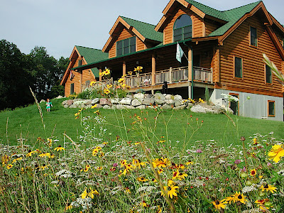

We built our loghome and move in May-2002, here it is, front and back showing walkout view:

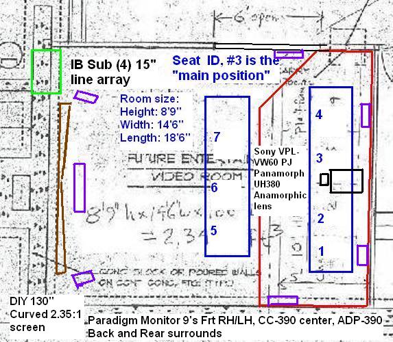

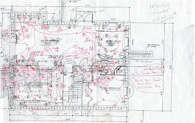

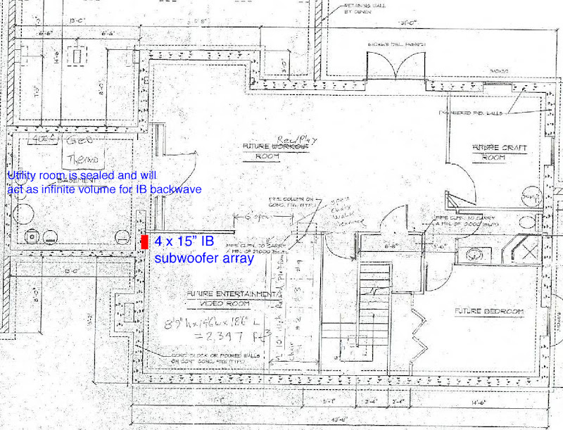

Here is basement layout, almost 1,300 sq feet includes:
-Full 9' high ceiling
-Craft room for my wife (11' x 12')
-Full 3rd bath
-4th Bedroom (12' x 14', nice for company)
-Huge walk in closet under the stairs
-Big openplay/rec room for kids/family activities (15' x 30'), includes refrig/sink/microwave area for snacks, lots of storage space for kids "stuff"
-Home Cinema room (14'6" x 18'6" ), I hate the usage of Man Cave for it, and Home Cinema is appropriate since I'm going 2.35:1 screen instead of 16:9 screen
-Utility room where the GeoThermal heat pump is and all mechanicals is isolated from the main basement area as shown in the layout.
Walkout layout has French doors for easy access/movement of stuff (that is west wall), while the craft room has 2 windows and the bedroom has 1 window, short wall is north facing.
I can control/manage the lighting pretty well in the home Cinema room, since it has no windows.
HT Layout:
Basement layout:

-Dec 2007 thru Now (Feb 2008); Plan and did all Electrical (almost 2,000 feet of 14/2, 14/3, and 12/3 romex), ran 500 feet of 14/4 speaker wire for Home Cinema room + Zone 2 and Zone 3 speakers in rec room and Craft room, cables/Cat5 wire for Frt Proj/subwoofer ran, decide to add sink to rec room, cut concete floor and plumb for drain and supply, contracted drywall was started on 12/27/07 and they just finished Friday 1/18/08. We are just painting rooms now, I'm hooking up electrical sw/circuits.

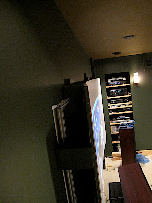

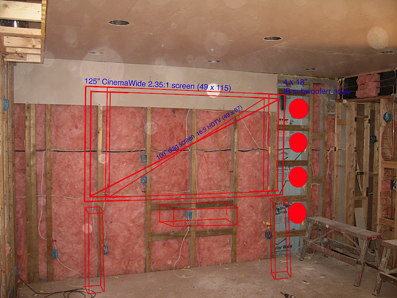

Here is Home Cinema front wall image:
Holy cow, after I typed the above realize still lots of work left, yet I can see the light coming closer to the end of the long-long 3+ year tunnel.

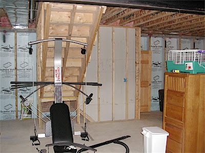

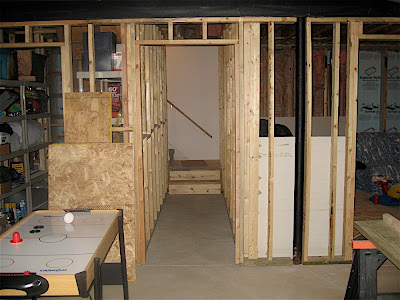

-Dec 2004 thru March 2005: Plan & design, changed the stairs going into the basement from a "L" layout to a "U" layout, frame all the walls, tighten log wall rod spring system

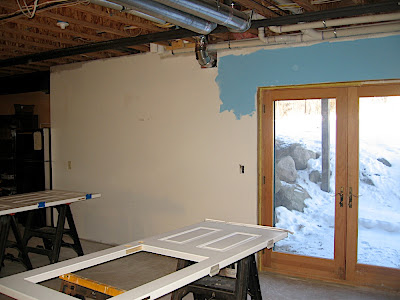

Before: Big/open 1,300 sq feet basement
Have a plan, transfer that plan to the concrete via snapping chalk lines, confirm plan to reality.
We modified the plans a few times based on chalk lines and just talking things thru.
a) initially the HT room went E-W instead of N-S like it is (our home faces East), but because it was next to the Utility room I was concerned with HVAC equipment noise, so changed it as shown. That also made me change the downstairs from a "L" to a "U", which meant the very first thing I did before putting up walls was actually tear down walls and built stairs. Also, added the 45deg corner on the craft room for better walk flow into the bathroom/bedroom. That also will make it easier for bedroom furniture movement, plus when the drywallers put the 12 foot sheets in the bedroom that allowed for them.
Measure twice, cut one. Even then occasional FuPau happenes. No problem, almost every piece of wood was used, very little scrap.
Plus, my kids were able to "play builder" with all the small wood pieces I kept and entertain themselfs while I worked.
Changing stairs from "L" to "U":
Before, "L": After, "U"

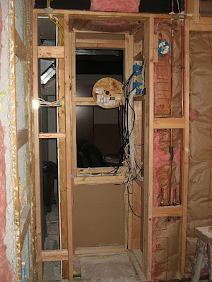

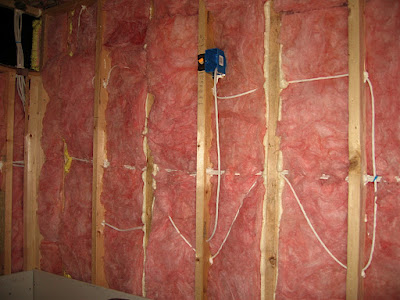

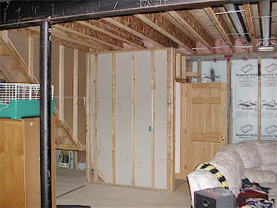

I built all my walls "in place", i.e., put the top and bottom plates on first then the individual studs.
Others build a wall on its side and lift into place.
I used wood studs instead of the newer steel studs, just felt more comfortable with them, my friend used the steel studs and loved them, no warping.
I used std 2 x 4 wall construction for most of the walls, the Home Theatre inside 2 walls I used 2 x 6 top/bottom plated and then staggered 2 x 4's for more sound isolation. The outside walls are Michigan Superior Concrete walls.
More on that in year 4.

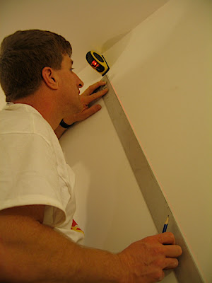

That is Year1 very briefly, cut lots of wood, love the Paslode framing gun, nice to have my dad over at times for that 2nd hand, when nobody was around Iearned other techniques (temp nail, clamps, etc).
I loved this phase, OJT and very visual to see progress as studs went up.
Nice to have a simple $40 laser also for long straight run check.
Next post will re-cap Year2.

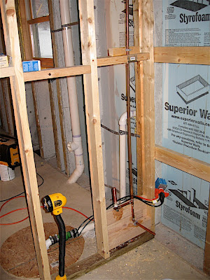

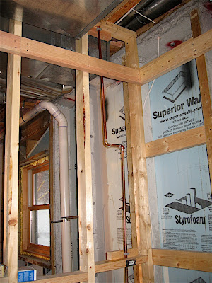

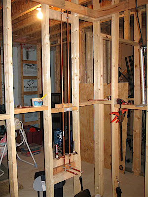

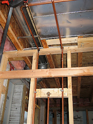

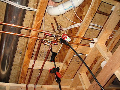

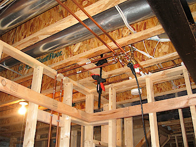

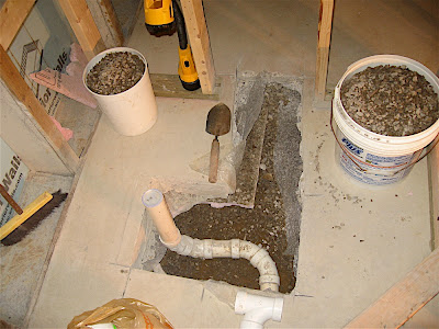

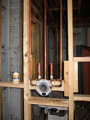

-Dec 2005 thru March 2006; Bath copper plumbing, re-do shower drain (add P-trap)/partial HVAC runs (I ran both hot and cold air supply for each room reciric)
I've never really sweated copper pipes before, etc. So, did a lot of reading, planning, made a 3D sketch (by hand) of the new Hot/cold supply routing. Made a BOM, added 10%, did a Home Depot run, ended up using about 87 feet of copper piping, at least 70+ fittings (90 deg, 45 deg, etc). I got pretty good a sweating the copper. Use H20 air hammers everywhere so no noise issue, maybe a little overkill but only $12/each.
My DIY plumbers Secret:
Pressurize the system with air and test for leaks before sweating final hot/cold joints.
I used a simple $4 1/2" faucet w/compression joints that has a schrader valve on it, would attach that to the pipe supply, pump it to 40-50 psi, take soapy water, brush it on the joints I sweated, and hopefully no bubbles (no leaks).
Of the 70+ joints I sweated found 1 leak, quickly re-sweated it. This took 15 extra minutes but gave me, a DIY plumber a sense of confidence.
This picture shows the temp faucet (has compression fittings) at the old/new pipe junction.
Future toliet supply:
Future sink supply:
Future shower supply:

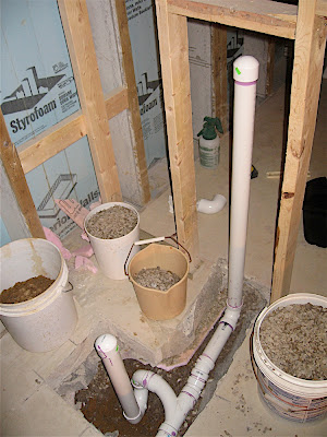

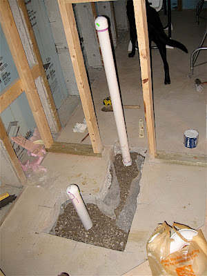

In a log home difficult to rech vent pipes, so air intake vent are used (and approved by code in Livingston county, Mich). However, I was concered that my builder did not take that into account for the shower drain, venting, so I realized I needed to "cut the concrete" to vent that drain. In doing so, I also found out he (the plumber) did not install a p-trap beneath the shower drain, w/o that septic gas would have seeped into the shower, stinky. Therefore I fixed that and added piping for air intake.
Before showing shower drain wrongly done by original plumber w/o p-trap.
I added p-trap and routed for air vent.

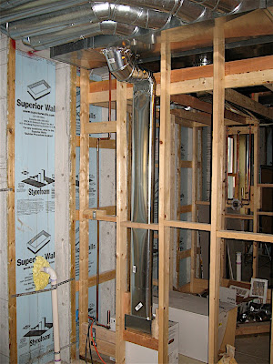

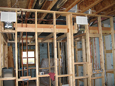

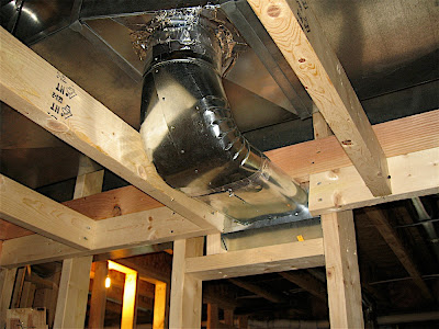

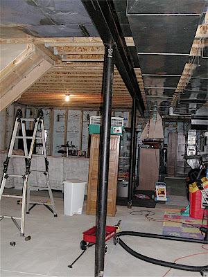

-HVAC supply/return runs each room
-foil sealed ALL seams on HVAC runs, including existing HVAC,

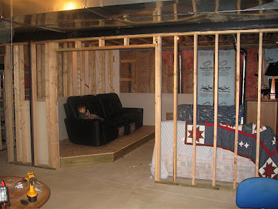

-built home theatre seat riser section (gave HT room some image to theatre now)
-sealed bond areas around total perimeter of home (8-10 cans of foam sealant)
-re-tighten log wall rod spring system
This picture shows the current log home tightenting system, effective from 2003 models, mine is similiar but the spring is on the bottom (in basement) and requires tightening 2-3 times over a 5 year period while the logs settle.
(Heritage Log Home systemHeritage Log Home system)
The close loop GeoThermal system was properly sized for the additional basement load when I built the home.
As a matter of fact, we even had in floor heating in our original home plan, but took it out during building because we went over budget.
I put traditional supply vents on the bottom and return vents on the top in each room for air circulation.
Yes, I do realize that looking at HVAC vents is kinda boring for an AVS topic, but you never know, others are in their process and this might help them imagine some method for their project. I do look at others in process stuff to gather my ideas.
I always balanced same supply/return for each room, and further put "closeable" grilles on each so I could balance each room.

Just a few picts:
Return vents in 4th bedroom
Bathroom view of craft room return vent
Bathroom room supply duct, view from craft room:

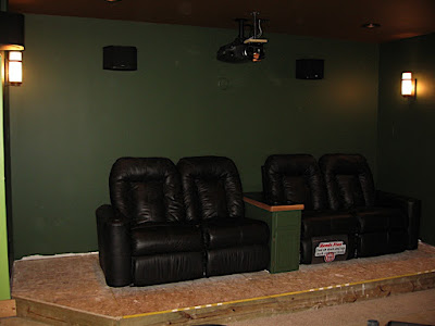

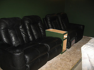

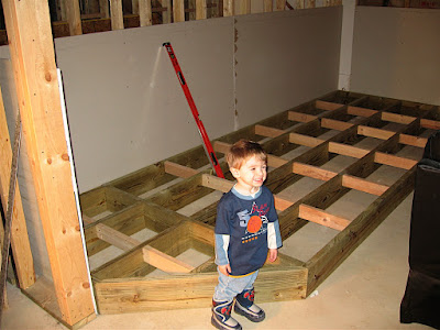

Home theatre riser, egg crate similiar to other risers, built in-place so put lower sheet of drywall in 1st:
(there is a 1/4" gap to the drywall so no vibration transmission, I put soft DAP there, it will be covered by carpet)

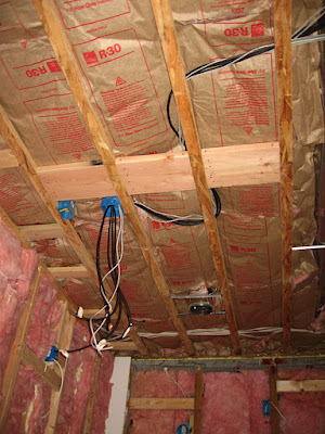

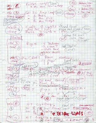

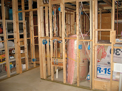

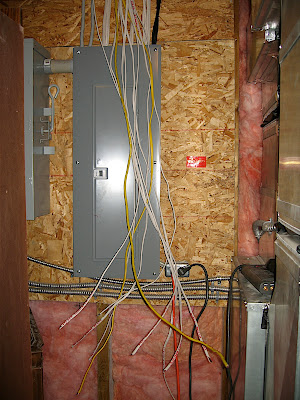

-Plan and did all Electrical (almost 2,000 feet of 14/2, 14/3, and 12/3 romex),
-Electrical planning and layout:
Tapped into 3 existing circuits and added 10 new circuits:
Overview schematic of wiring:
Home runs at main panel waiting to be connected:
After working so hard on the wiring phase, I understand the term "home run", felt for each circuit to run that final length.
I have (2) 200 Amp supply panels, my home is 100% electric, no gas/oil.
One panel is dedicated to the GeoThermal unit and the H20, while this one is the main home supply panel.
I really respect tradespeople who do this for a living.

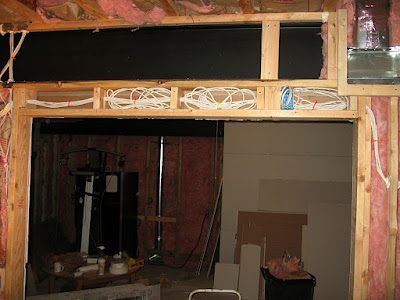

-ran 500 feet of 14/4 speaker wire for Home Cinema room + Zone 2 and Zone 3 speakers in rec room and Craft room.
Empty spool of 500 ft 14/4 wire in A/V closet after many long nights.
The A/V closet had "back doors" for easy access from the rec room side, no need for any sliding system.
Speaker wires kept 2 feet from high current wires, crossed at 90deg when needed. Tied and secured for no rattles, used 100 zip ties, quite handy.
All holes sealed.
Equal length runs for rear surrounds bundled above door header in random circular pattern.

-decide to add sink to rec room, cut concete floor and plumb for drain and supply,

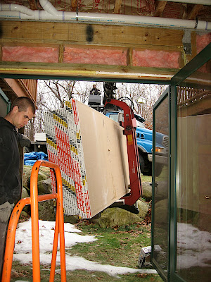

-contracted drywall was started on 12/27/07 and they just finished Friday 1/18/08. 96 sheets of 10, 12, and 14 foot drywall.

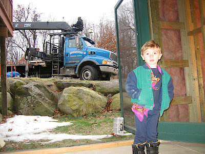

Actually pretty neat watching them unload the drywall into the walkout basement via the french doors.
My son like watching them also.

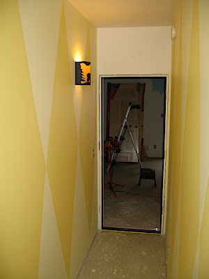

My wife felt our hallway from the stairs to the open play room needed something, so she came up with this diamond pattern for painting.
Of course I had to do some layout work, he is my 2 year old helper getting in on the action:
This $40 laser I bought from HomeDepot 6 years ago has come in handy so many times, it has this push pin feature for sticking onto drywall and shooting straight line at any angle, really neat, it does not fall off.
Check it out at the ceiling pointing down at an angle.

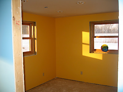

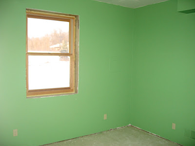

We wanted our various rooms in the basement bright and feeling "outdoors-inside", so my wife picked these playful colors, says "we are a family, come play and live here."
Our son's helping out:

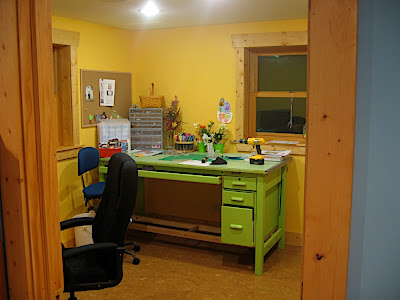

Craft room:
Bath Room:
(I have some shower/floor tile work to do shortly, I kinda like doing tile work, guess I'm just a..DIY'er)
4th Bedroom:

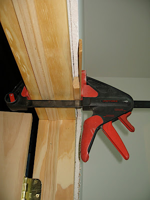

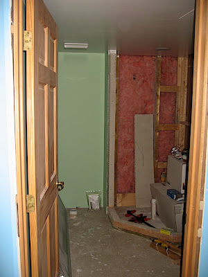

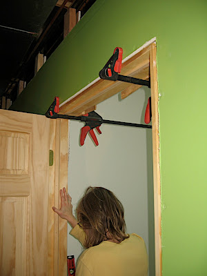

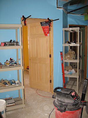

Hanging doors in the basement rooms.
My wife helped getting the door sorta set, then with clamps I was able to finish the rest myself, not really hard at all.
Had to shim the drywall somewhat on one wall due to warp boards, so you can see I went flush to the main side of the door frame and will need to rip some trim/filler boards for this gap.

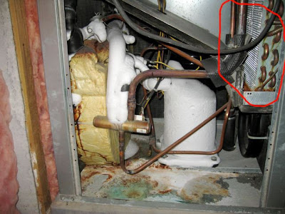

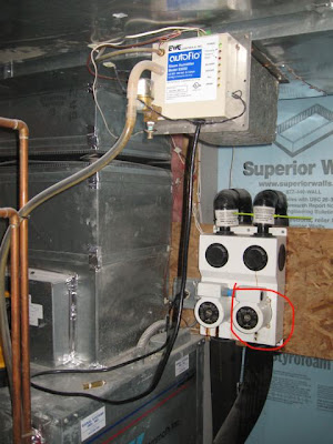

My GeoThermal system crapped out friday evening 2/29, the closed loop pumps/flow center went bad, so I had to sink $1.5k for that .
Will delay my HT purchases, rats
(still need Blu-ray, OTA separate tuner, IB subwoofer speakers/amp)
Here's a GeoThermal heap pump not working like it should, even after I cleaned the filter AND took off the return boot to totally clean the evap coil shown still not worked.
Turned out my flow center was the culprit, bad pump, I replaced the whole unit. Of course this happens on year 6 of a 5 year warranty, so 100% my cost.
Flow center just before replacement, 1 of 2 pumps bad, but install labor is so much more than capital I just replaced the whole unit.

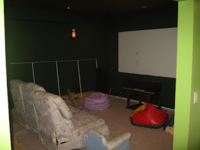

We are having the big MSU vs Penn State party this weekend in there,
Go Green Go White.
On my "to do" list:

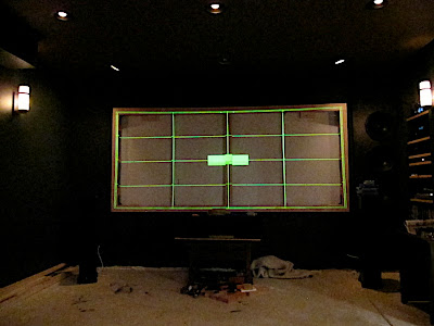

-finish 2.35:1 curved screen (Thanksgiving Sat/Sunday project)
-re-do my rear riser, make it into a broadband bass absorber (between Thanksgiving and xmas)
-Make a small stage in front (I've gone back/forth on this, I like the feeling it impacts on a HT) (between Thanksgiving and xmas)
-Carpet install (over xmas -new years break)
-Front/side hang on wall acoustic treatments (Jan 2009)
-Possible rear corner bass traps (Jan 2009), after room acoustic measurements

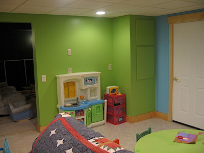

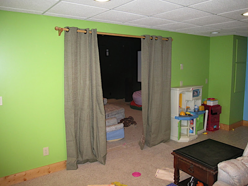

Basement progress picts:

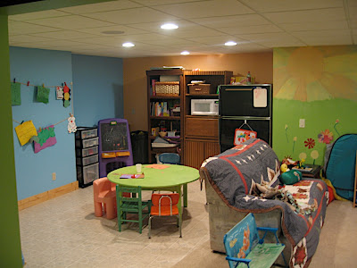

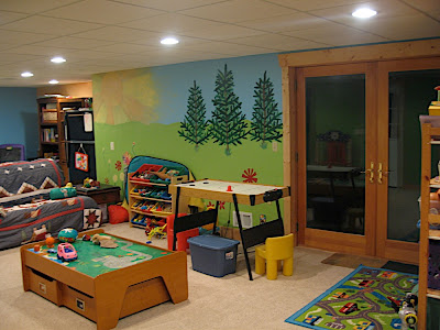

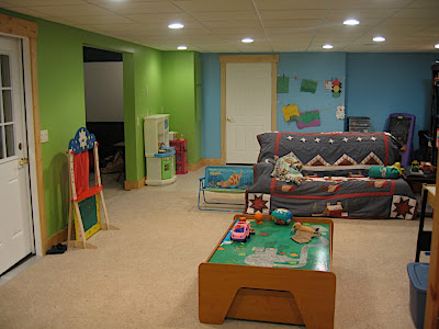

Kids rec/play room, they love it.
Over Christmas I'll be installing sink cabinet here with microwave cabinet above.
On the RH side those doors are the backside of my HT A/V closet:

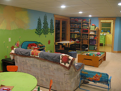

Wife's craft room, she can do "stuff" here with the kids nearby in their play zone:
A Mini-project for the HT in process now, I'm turning a 12" w x 34"h x 24" l base cabinet into a 12" w x 24"h x24" l dual cupholder with drawer/storage:

More progress:
Cupholder/storage for 2nd row seats finished just before Thanksgiving:
Cup Holder Solution for Current Chairs - with base cabinet
DIY screen is finally-finally coming together, ongoing details here DIY Curved Screen with structural extruded aluminum metal framing:
Laminate and border should be done by this weekend.
PanamorphUH380/SonyVW60 combo need fine tuning, still neat to see it.

Quick re-cap of "Usul" the subwoofer.

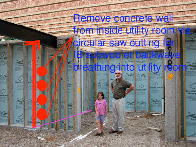

Quick re-cap of "Usul" the subwoofer. (this was finished 7/21/08)
I have a build thread at The IB Cult forum, however I want to post here my finished product.
(well, I have to make the rectangular speaker cover still)
Here is my line array built with 4 x AE IB15's, my first DIY speaker project.
I've named this IB subwoofer "Usul", because I had to cut thru rock (concrete foundation wall) to make this project a reality:
wall acoustic treatments are coming in near future.
Yet I am so please with the sound quality, clean, powerful bass presence.
Anyone considering to build a IB sub I highly recommend the AE IB15's, great value for the $$'s.
My total investment is around $1.3k, speakers, amp, EQ, mounting boards, hardware, speaker grille cloth, etc.
I am driving them with the Behringer EP2500 Europower Power Amp, EQ Behringer FBQ2496 Feedback Destroyer (not dialed in yet)

DIY screen hung, 1st viewing
I just hung my DW 128" diag 2.35:1 screen this morning with my wife's help before I went into work, we watched the morning news downstairs.
Tonight she took our 6 year old on a Brownies field trip, so a "boys night home".
I did a quick calibration via DVD, then we watched Blu-ray StarWars: The Clone Wars with my 2 young boys, put them to bed, then popped in Blu-ray Casino Royale.
Here's the screen hung, black velvet border is this weekend project.
Also, now that the screen is hung and 95% done, it's time for center channel shelf
(I put 2 rows of studs behing the drywall so I could hang the center channel so it will appear to float in front of the wall, at least that was my thought 11 months ago, weekend of 12/13 project)
Side profile:
more details / screen shots here http://www.avsforum.com/avs-vb/showt...4#post15186244
A few screen shots:

Yes, no HT doors at this time, we've opted for a 6' wide opening for the time being, keeping it a family open space. In 4-5 years then we'll put a door there for more sound control.
We are watching movies/using the room daily as I get more done.
