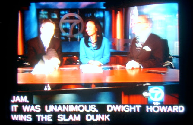

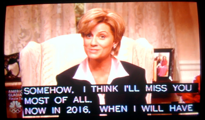

The picture above is of digital captions using the worst-looking font from a coupon-eligible digital-to-analog converter box. Imagine if you were to spend your $40 coupon on a coupon-eligible converter box (CECB) where all the caption choices looked as hard to read as those captions do. It could happen.
The purpose of this thread is to provide a central place for evaluations of how well closed captioning issues have been addressed in the different coupon-eligible converter boxes (CECBs). While all CECBs are required to relay CEA-608 caption data to analog TVs, only some of them offer the option of decoding CEA-708 caption data, which provides the user the ability to adjust the captioning to one's own preferences.
The main focus of this thread is on evaluating CECBs that decode CEA-708 captions to provide advanced captioning features. However, if CECBs that don't decode CEA-708 captions have any problems relaying the CEA-608 captions used by analog TVs, that's important information as well.
Collecting such evaluations is highly desirable as there have been many problems reported with captioning for some set-top boxes used for pay TV services, and it is important to evaluate how well captioning is implemented before people who rely on captioning use $40 coupons on converter boxes with poorly designed captioning features. (Once the $40 coupon is used, the customer may not be able to get the value of the coupon back, and there may be no other good converter boxes suitable for the customer at the retailer.)

Poor to Fair. I think a font with clean lines is much easier to read. See the picture of the analog captions below (darker than normal due to flash from camera):
5. The ease of reading the eight different fonts available for digital captions:
Many of the fonts are too thin and seem to flicker, even when they're large, so I would judge them as poor. There are about three out of eight fonts that I would judge as very usable when using a solid black background:

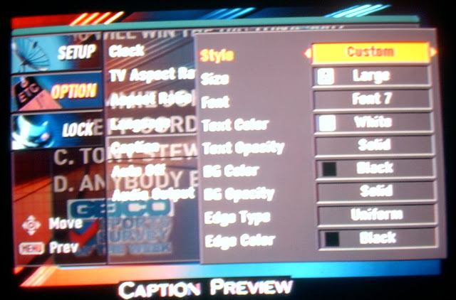

6. The availability of a "caption preview" of some kind when changes are made in the settings for the digital captions, and how well this predicts the largest font style:
Yes. However, the caption preview doesn't accurately indicate how large the size of the captions would actually be, and there can be significant differences in size according to the choice of the font. The preview showed the effect of making changes in the edges, in the color of the text, etc., which is very important, since the process of making changes in the settings already takes a lot of steps.
Caption Preview of Font 7
Font 7 (You can see the maximum number of 32 characters take up the entire width of the screen, which is actually good; other fonts didn't seem to get this large)

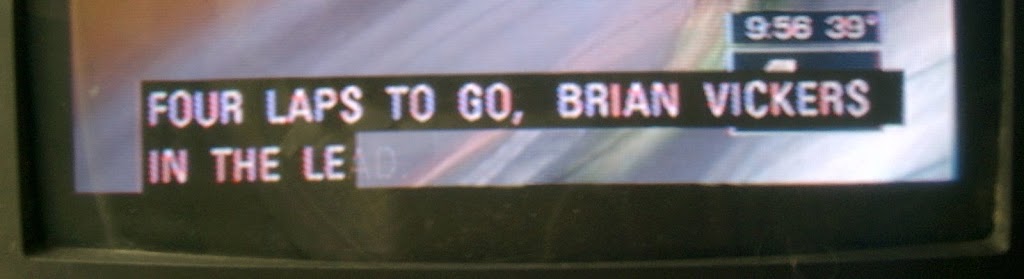

b. When there were long sentences using Font 7 in large size, there would be sudden, jerky movements of all the captions to the left so that they could all be seen. This was because the captions would start off indented but then have to be jerked back to the left margin when the lines of text got very long. (I don't know if this is a converter box problem, a transmission problem, or simply an oversight in standards for captions.)

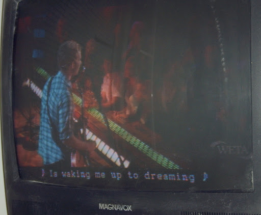

c. The Insignia would display captions so low on my convex Magnavox TV that the captions on the left and right would not be completely visible on the bottoms even when using letter-box. (However, the captions were still legible, so this would not be a deal-breaker for me.) This might not happen with flat TVs.

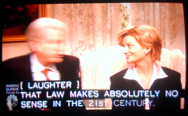

d. When I took pictures of Font 0 and Font 7 captions, a close examination of the pictures showed that the solid background behind some characters had unexpectedly become transparent or clear, which made some of the characters illegible. I only noticed this in the pictures, and not during live viewing. I'm not sure how much of a problem this is or will be.
Font 0: Look closely at last word
Font 0: Look at the background behind the "T" in the last word; it's missing but a faint "T" can be seen.
Font 7: Look closely at "21st" and "Century"

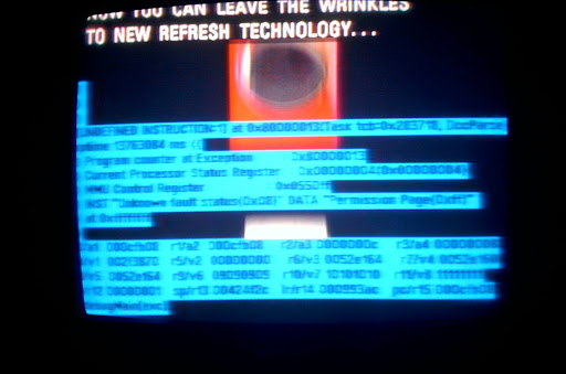

12. Whether the CECB has crashed and what the circumstances were.
The Insignia crashed five times within three weeks. I was able to take pictures of three of the crashes, and it appeared that commercials were showing during those crashes. During the last crash, there was a black screen, so I'm not sure whether a commercial was happening or if there was a transition to a commercial. I think three crashes occurred on the my20 channel, and another occurred with WJLA (local ABC affiliate) and either WTTG (local Fox affiliate) or WETA (local PBS affiliate using SD channel). All those stations have problems transmitting captions over digital channels in some way, so I suspect that something about the way those stations transmitted captioning may have precipitated the crashes (though of course, the CECB shouldn't be crashing anyway).

In my opinion, the most important thing to evaluate about captions is how easy they are to read on the screen and whether it's possible to come up with an arrangement that works well for the individual. (Having the ability to use a translucent background can be important for people who don't want the captions to block out information on the screen, such as that present during a football game.) With enough tweaking, I was able to get fairly good captions.
I liked that the large-size captions actually are fairly tall and much larger via the Insignia than they are on my Sharp HDTV (which seems to do a poor job in this respect).
Font 0 worked well with the following setting: white text, white uniform edge, large size, translucent black or blue background.
Font 3, despite my earlier description of it being usable, still isn't perfect. Uppercase "M"s and "W"s look polluted by nearby black pixels and "busy" due to "dot crawl." It looks much more even in large size than in standard size, however.
Font 7 did not work well in the large size because the automatic indentation from the left side present for some channels required long sentences to jerk suddenly to the left margin when the words reached the right side. In the standard size, which I hadn't tried until 2/20/08, the "T" is below the height of the other letters and makes the text look uneven.
Thus I'd probably end up using Font 0 unless I was at a significant distance from the TV, in which case I might switch to Font 7.

I returned the Insignia on March 13th, but also evaluated the Zenith, which has the same chip and remote control and functions just like the Insignia. As other people have noted, the Insignia and Zenith are the same products manufactured under different names; the only difference is in the user guides.
Added notes:
As of May 7th, the Insignia/Zenith CECBs appear to be the only CECBs I know of which can provide digital captions larger than the analog captions provided by my TV.
When I fast-forward a Tivo'ed program, the digital captions from the Zenith remain legible, while the captions from the DigitalStream CECB become incomplete and illegible.
Thus if I want to hurry up through a Tivo'ed program, I'm in luck if I'm using a Zenith/Insignia CECB but not if I'm using the DigitalStream CECB (which may depend on comb-filtering to look sharper).
Dana Mulvany
Rockville, MD

Great points. Actually, the Insignia seems to have a nice font 0. Perhaps you can try the SAP with a PBS signal.
dmoisan is offline   Reply With Quote
Old 02-20-08, 02:06 PM   #4   |  Link
dmulvany
Location: Rockville, Maryland and Sausalito, CA
Posts: 418
Thanks, Dave. I had presented Font 0 as one of the three fonts that were very usable. For the other fonts, my camera often made them look thicker and better than they really were.
I'm hard of hearing, so I may not be able to evaluate that feature well anyway. I'm also finding it difficult to find programs that use SAP.
dmulvany is offline   Reply With Quote

The coupon CAN be used after the purchase (before its expiration date) if you follow the procedure above. If you're a person with a disability who uses the coupon without making sure the converter box will work for your needs, you can lose the value of the coupon, particularly since no other converter box at the store may work well for you either.
The Insignia has now crashed twice within the first week of purchase, and that might even be because I was using closed captioning. Unfortunately, engineers simply might not have run the box through its paces with all the different captioning features being turned on.
I put up a post and picture about the last crash at the following high-traffic AVS thread to get more input; I also noticed problems with the audio and video going out of sync, and the captions getting delayed the longer the box was on:
http://www.avsforum.com/avs-vb/showt...2#post13176692
Here's a picture of the crash (the second one):
Dana

Many American viewers who are not necessarily "hearing impaired" use closed captioning at certain times. Closed captioning is particularly effective in public lounge areas of restaurants, bars and other locations with a lot of ambient noise. Even in the home, some viewers prefer viewing as well as seeing the spoken dialogue.
While the broadcasters may bear much of the blame for these problems, I recall NTIA's specifications referred to the importance of the "robustness" of the STB design. While that may have referred to hack-resistance, it also presumably means the CECBs should be freeze-resistant and crash resistant.

Very interesting stuff - the fields of closed captioning, audio description and sign language interpretation are areas where digital TV offers potential for huge improvements over analogue - but also huge pitfalls.
Over here in the UK our OTA system uses a new closed caption system called DVB Subtitles - which works like DVD subtitles, with the broadcaster sending a bit image, not text that is rendered by the receiver.
This means we can't alter our type size as it appears you guys can, but it does mean that broadcasters decide the typeface not the box makers, so viewers get the same result irrespective of box. The UK broadcasters worked with disability organisation to produce the "Tiresias" typeface that is really clear for those who are both hard of hearing and suffer reduced vision.
http://www.tiresias.org/fonts/index.htm
The broadcasters decides the size and position of the characters (they are usually relocated to accommodate name captions) and the system supports colours, so different characters in drama have their dialogue in different hues, making it easier to follow quick dialogue. It is possible to have multiple subtitle streams, with most boxes, like DVD players, having a default language choice for channels with multiple language streams (In Wales thre are shows made in Welsh language with both optional English translatin and Welsh hard-of-hearing subtitles) Normally you just press a "Subtitles" button and it shows the subtitles of the selected language (or if there is only one stream it shows that)
The very sensible US "Closed Caption on Mute" facility isn't widespread in the UK - though this may stem from our analogue TV system where subtitles were just a page number (888) on the multiple page number teletext system (News on 100s, Sport on 300s, Weather and Travel on 400s)
Satellite broadcasters are using the older character based technology - more similar to closed captions - though the main satellite platform uses a much better typeface to render it in the box.
I wonder if any US boxes will adopt Tiresias - it is already widely used not just for subtitles but for a lot of public signage in buildings, on train station indicator boards etc.
sneals2000 is offline   Reply With Quote

Great input here, and thanks for the reference to the Tiresias font!
The choice of font makes such a huge difference. I'm concerned that many caption fonts could cause eye strain.
On a different topic, I'm realizing now that when I look at my Magnavox TV's analog captions, there's no flickering---the captions are absolutely still. With the captions from the Insignia, there's a sense of movement; the captions are somehow created and fundamentally look differently than the ones from the TV. The characters don't look completely white. This can't be captured though photos, I'm afraid, and it would be hard to capture through video.
The captions from my HDTV are crisp and "still" like the Magnavox's. The ones from the Insignia somehow look like they're made by moving pixels while the other ones don't.
This can be a handy feature on my TVs' remote controls. For example, when I'm not getting captions on a digital channel from the Insignia, I can put the TV's remote control on MUTE, which turns on the analog captions, and then press the Insignia's CC button six times to go to the CC1 mode, then turn off the Mute and get sound and CCs again. (The Insignia does not offer the CC on Mute option.)
It would certainly be helpful to offer that as a choice. I haven't heard about or seen that font before.
Dana

Originally Posted by blacksburg98 View Post
I bought it at Wal-Mart. I have tried 3 boxes and found that channel 6.1 has problems of displaying CC. When I first plug it in, all channels are ok.
Thanks for the feedback that there's a problem.
Are you talking about problems with the pass-through of analog captions? Does the RCA DTA800 offer digital caption decoding?
What kinds of problems do you see with the captions from channel 6.1?
What is the network for the station that is broadcasting on 6.1?

The RCA DTA800B has digital CC'ing.

blacksburg98
New Member
Posts: 14
It's PBS. The problems is that it only displays one letter on the screen each time.
