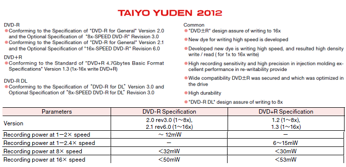

When writing to 16x DVDs the laser has to operate at a much higher current level than when writing to 8x DVDs. Wajo addresses this here:
http://www.avsforum.com/avs-vb/showp...postcount=9609

Writing 16x discs at 6x speed (as most stand alones do) takes no more power than writing a 8x disc at 6x speed. Writing 16x discs only takes more power when writing them at 16x speed. As shown on the graph from T-Y.
Direct link to the T-Y spec sheet explaining that a 8x or 16x disc takes the same amount of laser power if burned at the same speed. Even at 1x speed - a 8x disc and a 16x disc will take the same amount of laser power.
http://ds.yuden.co.jp/Detail/downloa.../media02_e.pdf
Super Eye is offline

This is why that oft-quoted TY laser power data sheet means everything and nothing at the same time: technically correct, but doesn't preclude or explain opposing practical experience. Also, TY is one of the few remaining mfrs that still does have integral write support backwards-compatible down to 1x, so users of TY 16x will often have experience that correlates with that white paper. Someone loading 16x-oiptimized TDK, Memorex or Maxell into a 2005 or 2006 recorder may get far different, less pleasant results.
