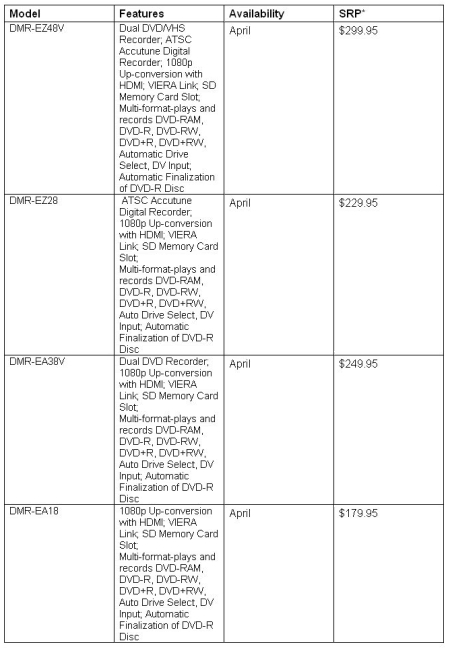

I have been trying, without success, to find a DMR-EZ47 at Circuit City (only because I got a CC gift card for Christmas) for several weeks. Today I called Panasonic, and was told they were discontinuing the model and coming out with new models in the very near future. Has anyone heard anything (facts, rumors, whatever) about the new models?
DeKatt is offline
post #417 of 637 Old 02-21-2008, 07:44 AM
Posts: 14,210
Quoted: 38 Post(s)
Liked: 197
Here's a chart on the new Panny models.

DeKatt's Avatar
Posts: 71
DeKatt is offline
