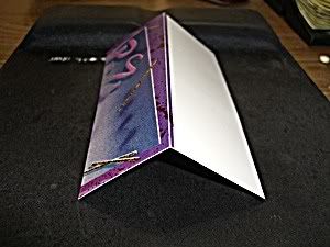

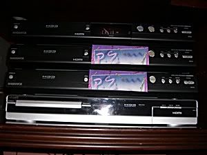

1. KLUGE (Kapturer of Latent User Guidance Energy)
Add a KLUGE over the sensor window of non-target unit(s).
A THICK greeting card is perfect for a poor-man's KLUGE... it's already creased and folded. Mine, shown below, turned out to be OK for long-distance use but the IR burned through at close range (~3-4 ft) when doing some tests.
Test YOUR (thicker) Kluges at close range to make sure the IR can't burn through them. If not thick enough, you can be making unintended changes to non-target machines, like I did.
KLUGEs should also be large enough to cover the display window between the buttons... 4" wide x at least 6" long, with 2+" of the 6" folded over the sensor and the remaining 4" length on the top side of the fold where more is better for stability. Overall size should be easy to handle, as well. We found full-panel coverage necessary here AFTER some smaller ones got off-kilter just enough to allow IR to "leak" in and we ended up deleting some titles we didn't intend to.
Philips units have sharp edges and straight faces, making it easy to keep them in place and flush on the glass. However, Mag units have rounded edges and sloping faces, requiring some longer Kluge dimensions.
If your stack is above your TV and you've got Mags, like me, you'll be shooting upwards with the remote. If so, make sure you've got enough length on the front (IR) side to go below the bottom of the Mag's glass, and that they fit flush against the glass... you don't want IR bouncing off the unit below up into the sensor area.
Heed this story of disaster if you operate one unit with KLUGE leaking or missing from other units!
These are my original greeting-card Kluges that IR burned thru at close range:
