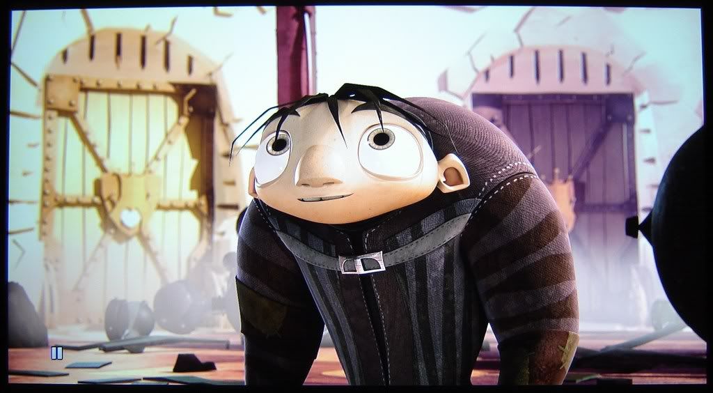

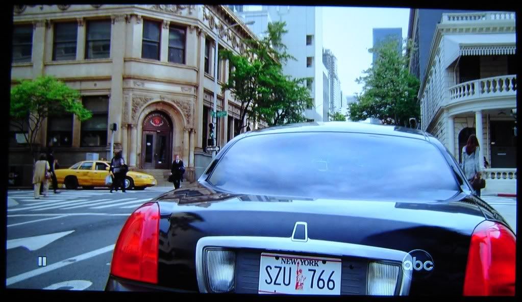

I'll "play", here's a few of mine:
Transformers ROTF blu-ray, took a few picts with my new Canon T1i (I'm still learning it)
Straight from camera, RAW, unprocessed, just cropped in iPhoto before uploading to picasa web hosting.
Projector: Sony VPL-VW60 + Panamorph UH380
CIH Screen Size: 130" diag for 2.37 movies 103" dia for 16:9
Screen Type: DIY curved Wilson Art Designer White Laminate
PS3 Blu-Ray.

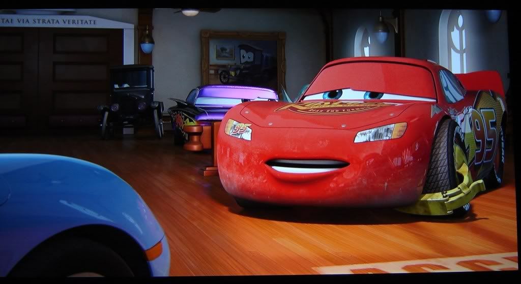

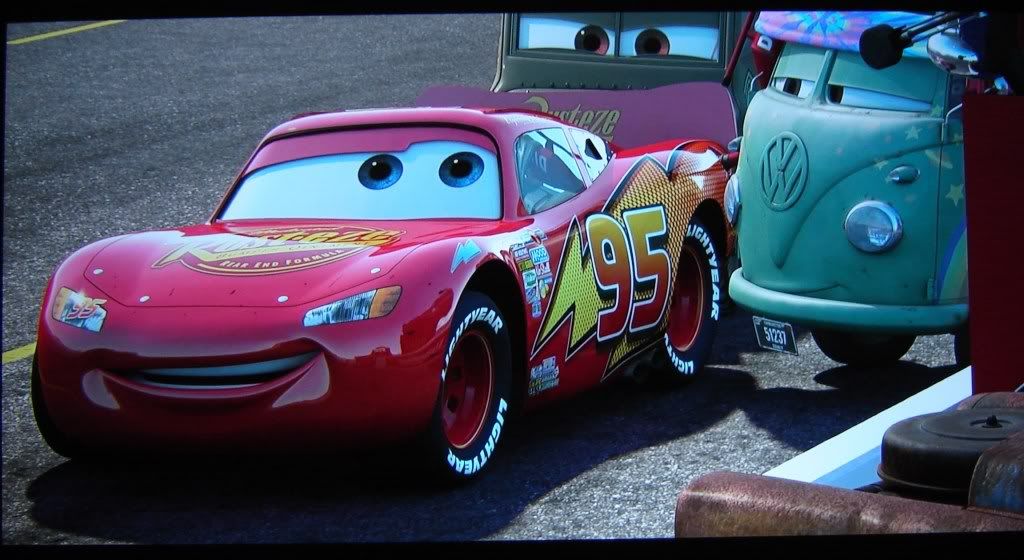

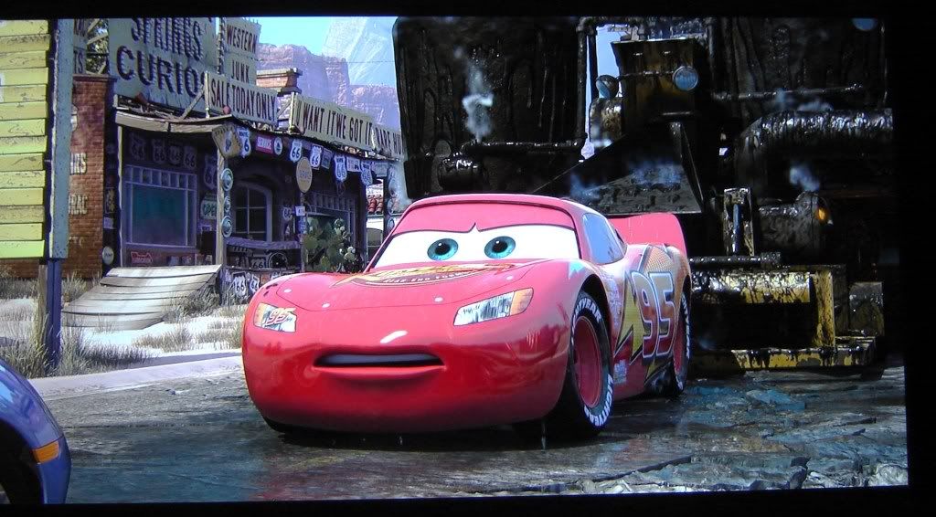

Cars
CIH Screen Size: 130" diag for 2.35 movies 103" dia for 16:9
PS3 Blu-Ray.
This is on of my favorite shots.....
I love the blue color of the Hudson Hornet, classic color!

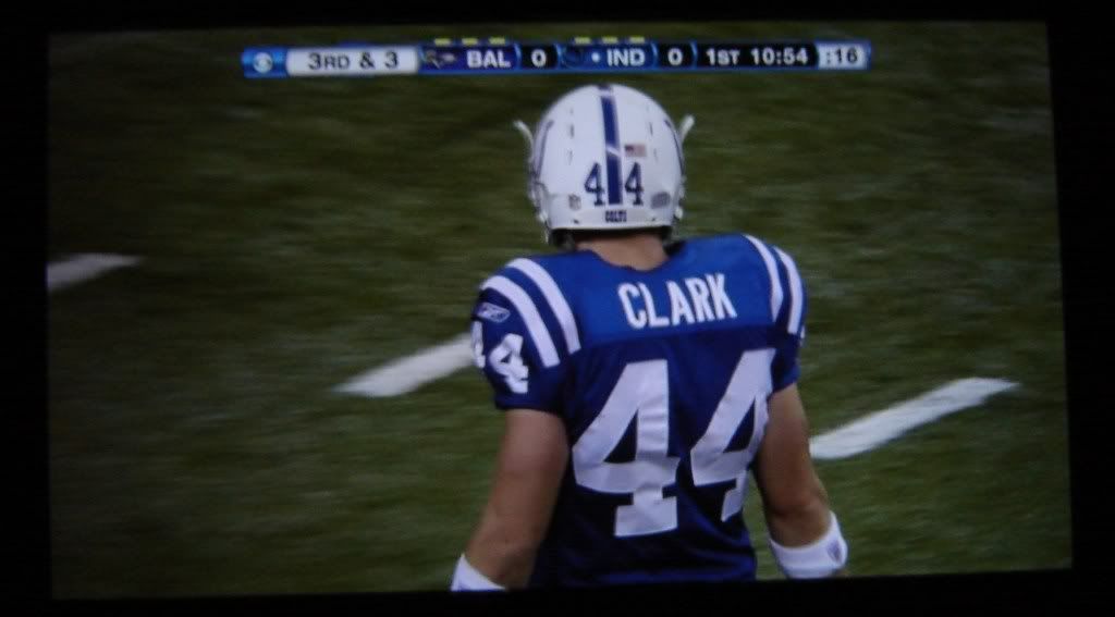

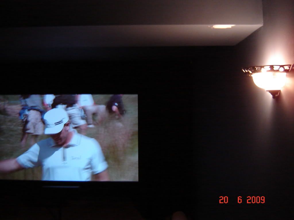

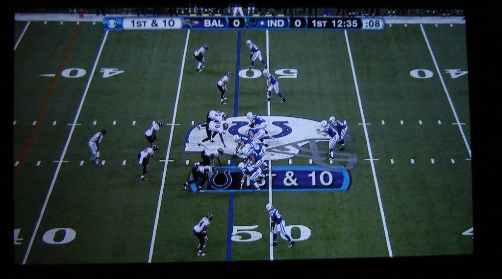

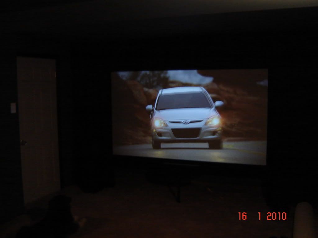

Just thought I would post a few shots.
Benq W5000
100" N7 Screen
Whites still look white.
A couple with 2 60w wall lights on. Camera dosn't show it very well, but the room is lit up pretty good.
Jason
