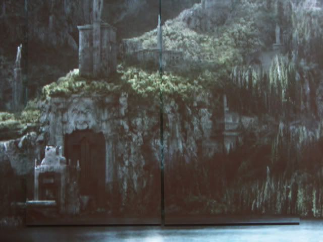

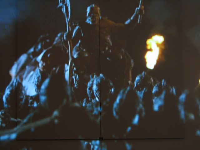

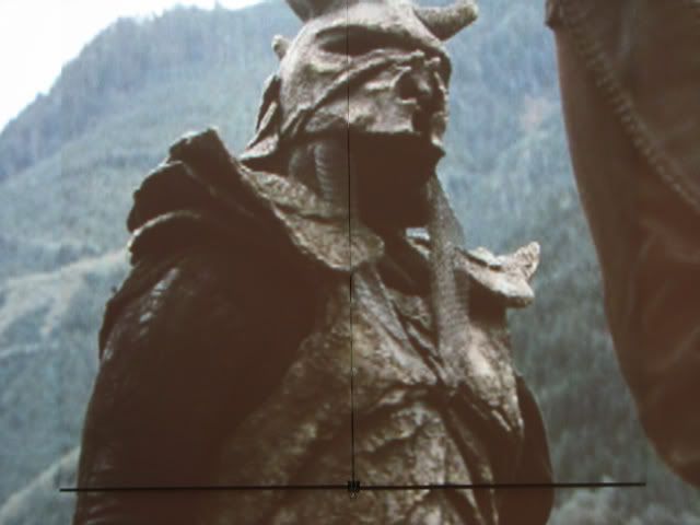

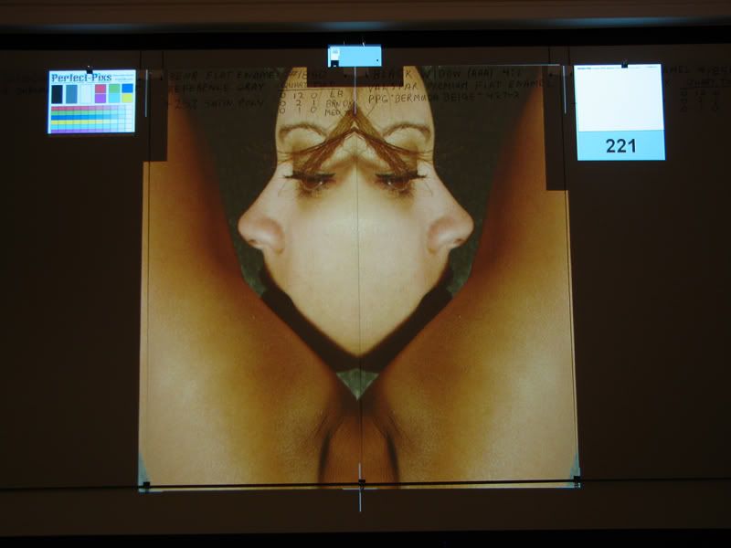

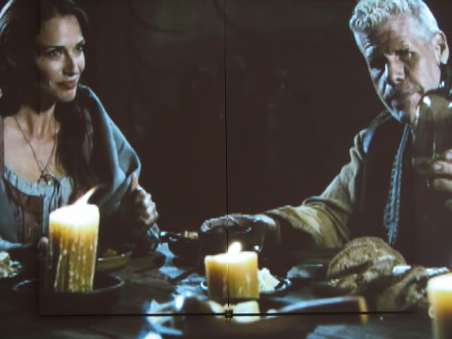

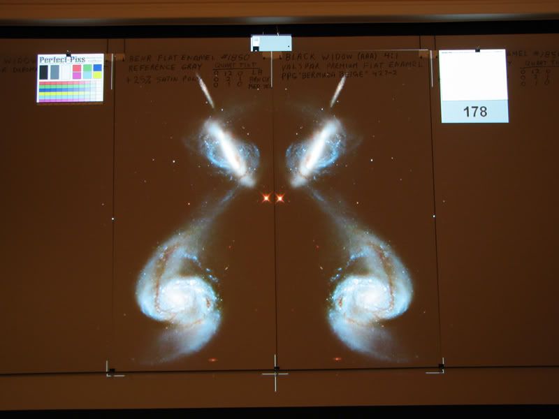

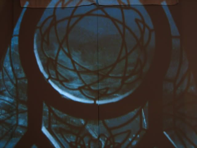

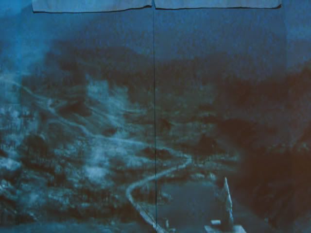

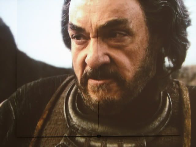

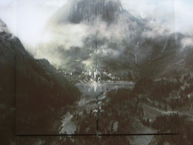

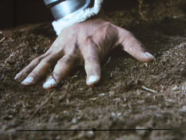

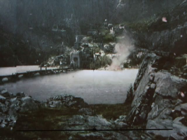

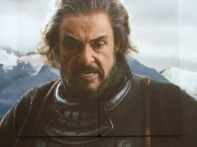

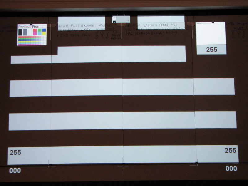

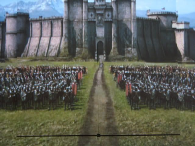

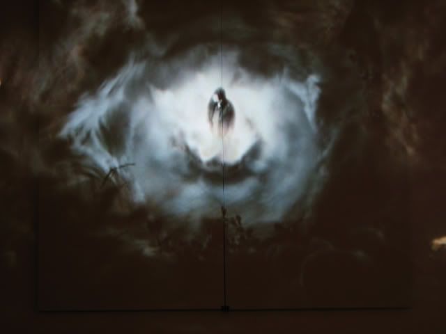

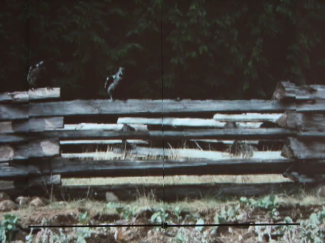

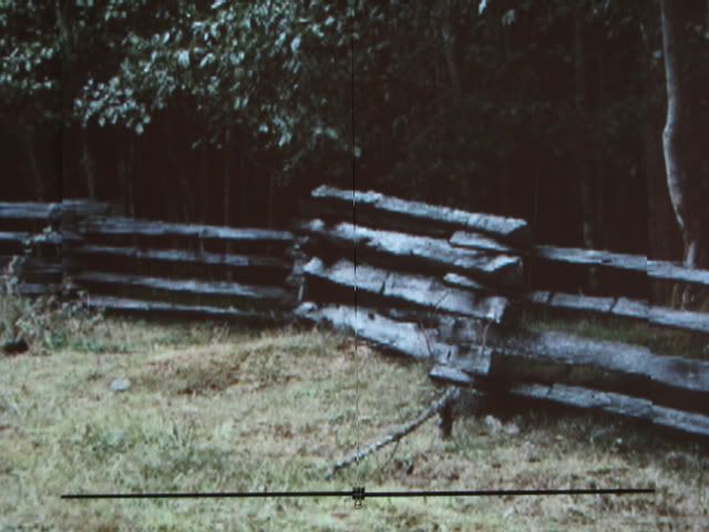

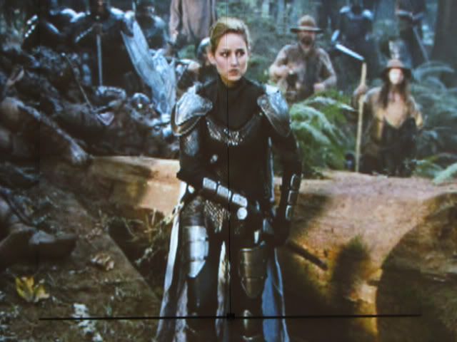

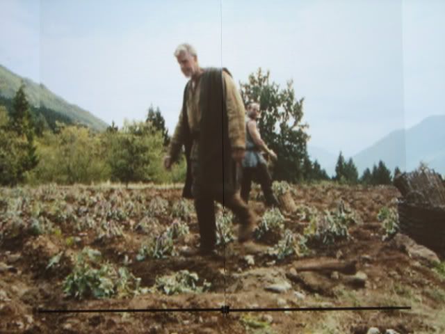

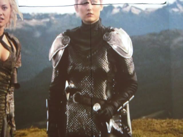

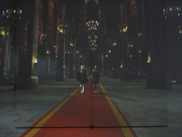

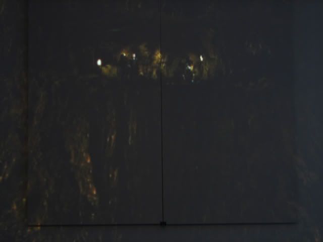

Time for a little fun!
In these photographs there are two sample panels.
One is the official Black Widow (AAA) made with Valspar
Ultra Premium Flat Enamel and Auto-Air Aluminum Base "Fine".
The other panel is the Behr 1850 Reference Gray with 25%
Minwax Clear Satin Polycrylic added to boost the sheen.
It was in the afternoon, so there was some light leakage in the room.
I had the 15 watt ambient light bulb turned on.
The projector was in it's best cinema mode.
The photographs were down sized to 1024 x 768 using Adobe PhotoShop.
This was in order to put everyone on a level playing field.
Let the Show Begin!
Click here to view the entire photo set as a slide show.
OR
Click here to view the entire photo album on Photobucket.
OR
If you really want to see the photos unaltered then click here.
NOTE: If you do not know what to look for to identify which panel is the Black Widow then simply vote for the one you think produces the best images. If you are unsure as to which panel is the better performer, then just vote "unsure".

Click images to view as 1024 x 768.

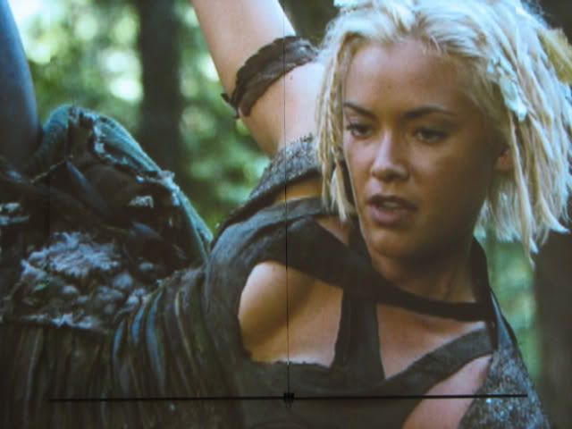

post #3 of 32 Old 04-19-2008, 11:35 AM - Thread Starter
tiddler's Avatar
Location: Ottawa, Canada
Posts: 3,303
Click images to enlarge to 1024 x 768.

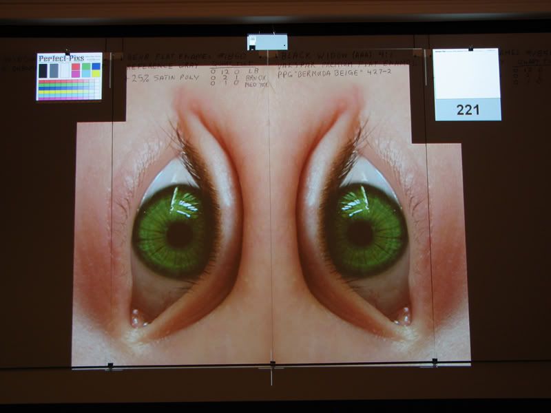

post #4 of 32 Old 04-19-2008, 11:37 AM - Thread Starter
tiddler's Avatar
Posts: 3,303

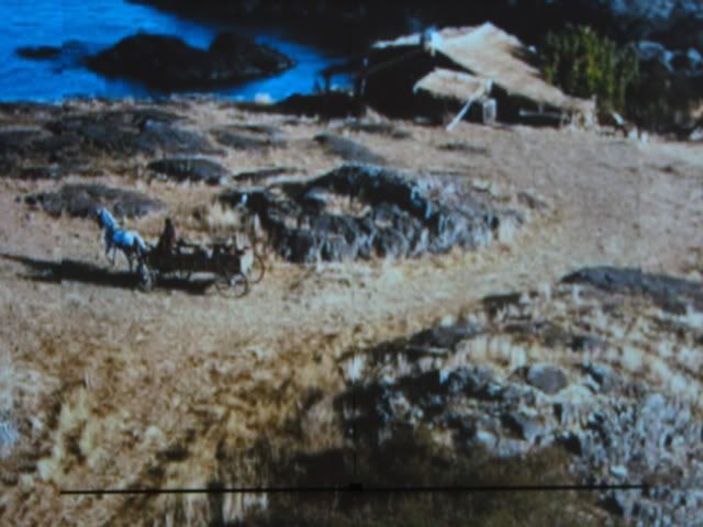

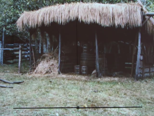

post #5 of 32 Old 04-19-2008, 11:39 AM - Thread Starter
tiddler's Avatar
Posts: 3,303

post #6 of 32 Old 04-19-2008, 12:26 PM
Highside's Avatar
Location: Boise, ID
Posts: 604

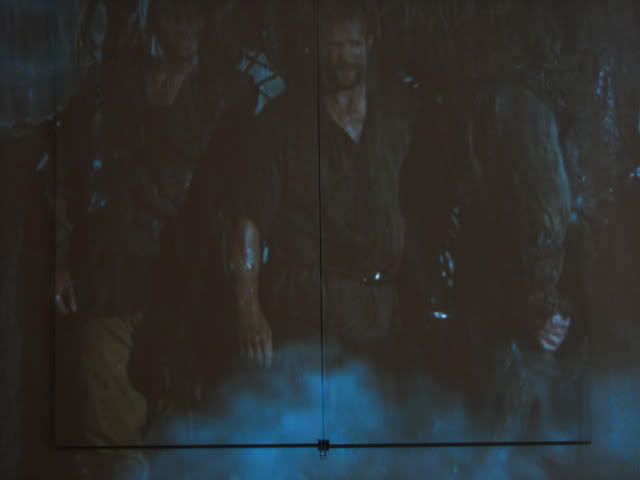

Well I didn't vote but I will give my observations. I really don't care about AL tolerance but I do care about getting the BEST image possible in my HT. If that means going to a gray screen then so be it. So I will not vote for which one is better.
In your pictures Todd, remind you that my monitor is calibrated to RGB with Spyder and Adobe Photoshop CS3, I COULD NOT tell a difference between the two.
I then started to get frustrated that you didn't use your required (said in jest) sample photos. Most of those photos, until the last post, were not good represenatives for screen comparison. I think maybe only one or two had enough color/flesh/light/dark in the same area, but on two different paints, to gather a reasonable conclusion. Todd, those photos are horrible, even the untouched ones. Sorry, but I had to say that.
The last post had some very good symetrical screen shots to compare. I still COULD NOT tell a difference. If that's the point you're trying to prove (you usually have a point to prove), then it worked for me.
BTW, what is that last movie with the rather hot women dressed up all MidEvil and stuff.
I'm not sure which photos you are talking about when you say "those photos are horrible" or the comparison photos.
Rob
These are all scenes from In the Name of The King.
I really did not have a point. It has been said repeatedly that I have to watch a movie with the sample panel to really appreciate the difference between Black Widow and a simple OTS paint or even one with a bit of poly added. I have a fairly light colored screen so I had to put something beside the Black Widow to use as a reference.
I was having trouble seeing any difference. Watching a movie that is. Even with all the dark scenes in this movie. I decided to take some screen shots so I could sample the images with ColorPic to see if maybe it is just my old eyes that were at fault. I still could not see much difference except in one photo but it is almost completely dark so I don't really know if I would call it a scene.
I was wishing there was someone else here to get an opinion from and then it occurred to me that everyone could have a look and tell me what they see.
Isn't the internet grand!
P.S. It is very difficult and time consuming to find good symmetrical scenes in a movie. I did my best, but it is so much easier to use the split & mirrored images that I setup specifically for that purpose.

Can't pick a winner from these. How about some shots with color bars?
I firmly believe there is a "depth" element that is impossible to show with screenshots, too. Any visual impressions? What's your preference?
Garry
I really could not tell them apart except in almost all black scenes. One is slightly darker. In some very bright panning scenes the aluminum is visible but only if you are really looking for it.
I'm not sure what you mean by depth. If you mean there is a sort of 3 dimension impression of the image, "like looking out an open window" as Bud puts it, I would say that both were quite transparent in that way. This sort of invisible screen is what I have come to crave more than anything I might characterize as "pop". In that respect I think the Black Widow mix is superior to other mixes I have tried that had high concentrations of mica flakes. Those sort of screen surfaces have a sort of shimmering effect to them when there is bright light on them. I think this may be the result of the refraction from the mica flakes. It is kinda cool looking at first but in the end I found it distracting when watching a movie.
Well IMHO many of those pictures were very grainy and blurry. And aside from that, you deviated from the mirrored shots. But I do understand your purpose for trying actually movies scenes.
As was I.
This is where I have been a proponent of stacking the samples. Sunlight or the Director's lighting for a scene is never directly overhead and right behind the camera if you get my drift. So once again, IMO, often side by sides never do both samples justice. If you notice in most movies where peoples faces are shown mostly head on, one side of the faces is darker than the other....but often, the individual side is more or less consistent in tones and lighting. Hence the possibility of using a stacked formation for actual movies.

having taken a closer look at the 4850 (with poly) and comparing it the BW...
i'm fairly confident the BW is on the right.
the reason is fairly easy if you look closer at the details...
1) the BW has ever so slightly better black levels than the reference 4850 /wp
2) the BW has ever so slightly better white levels than the reference 4850 /wp
3) the BW has ever so slightly better flesh tones than the reference 4850 /wp
4) the reference 4850 /wp has a noticeable poly sheen in the black levels that makes the black level performance less than the background screen in dark scenes... especially at the far left edges of the screen.
Just to be clear the Reference Gray is Behr 1850 (not 4850) with poly mixed into it at a ratio of 4:1. The background screen is a much lighter shade and it is Behr 4850.
I would agree that the BW has slightly better blacks. This was more clearly visible in the proper comparison shots:
As far as white levels they seem pretty well matched to me. However my measurements of the white field indicated more brightness on the right so the panel on the right should have a slight advantage.
Flesh Tones seem pretty even to me:
As far as the far left is concerned, keep in mind this was done during the day. I do have a roll down blockout blind on the window, slats at the side to of the window, and I blocked off the top with some molding but some light still leaks in. I suspect what you are seeing on the left is the background screen is shaded by the left sample panel.
This shot really gives away which one is the BW:
This scene also gave it away, but the photo does not show it quite as well as the real thing.
The strength of Black Widow is the deep black level when there is some ambient light present. The more ambient light (within reason) the more it shows up as having deeper blacks. These photos were taken with the 15 watt bulb on. That is a bit more ambient light then we would normally have in the room at night. With the 25 watt bulb the the Black Widow stands out more clearly.
The Black Widow absolutely has an edge in higher ambient light conditions.
If anything this little bit of entertainment has reinforced my belief that the comparison photos I prepared and introducing three levels of ambient light are far more informative then screen shots from movies. The proper comparison photos demonstrated that if matched in whites then the BW has deeper blacks. The opposite of course was also true, if matched in blacks then the BW had whiter whites. That is when comparing to basic known screen paint solutions such as a near neutral gray with some sheen. Now if you start comparing the BW to really flat paints like the True Value latex then WOW what a difference. If you are coming from a flat white screen directly to BW then again WOW what a difference. BUT as I said from the beginning of all this investigation my only concern was that those are apples to oranges comparisons and hardly telling. Each solution has it's strengths and weaknesses. Most of the metallic mixes have the trouble of not being able to control the sheen/reflectivity independent of the shade. For the shades that are achievable without significantly compromising the effectiveness of the flakes they may be superior. In a given situation where the shade and sheen of a simple tinted gray paint are dialed in then it may well be the better choice. On the other hand if you don't want to go through any experimentation process then Black Widow is probably the best choice. In a situation well suited to the BW it is going to be superior to the simple paint+poly.

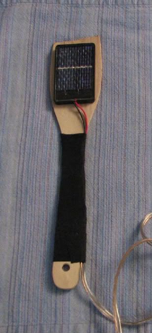

Don't worry if MM runs out of words! I'm sure there is someone waiting in the wings to fill the void!
They are just waiting for an exclusive and devoted audience.
At the moment they don't understand my spatula . . .
and therefore they are afraid of it.
NOTE: This post will most likely be deleted or edited because here at AVS, despite any personal feelings, the moderators strive to be fair and discourage any postings that could be taken as personally insulting.
