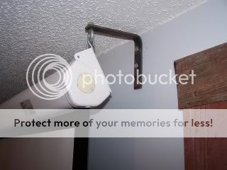

C) Did you see my hanging method from beginning of this thread?
20Fan
Ohio State Buckeyes- GO BUCKS !
My Aluminum frame build
I did but it seems that still involves holes in the wall and/or ceiling. This is her first house and even though its old as dirt she's very protective of anything related to it. As this is way more more for me than for her, I'm going to guess she'd shoot any holes in wall notions down. Besides, the screen/setup is only there roughly every other weekend. The brackets/holes could be an eyesore when Im not around. (Im guessing that would be her reasoning)
stmpjmp is offline
Thermostats are easy to move... they're ussualy just two very thin wires.
Or hang it from the ceiling. You just need two eye hooks, and the eyehooks could be very small. If you want to get fancy, recess a threaded hole in the ceiling of some sort and make the eyehooks removeable,.
Other then that, put the pants on or grow a pair?
Harman Kardon AVR 254 ● Energy Connoisseur C-7 ● Epson PowerLite 8350 ● 100" DIY WA DW w/ 80/20 frame
Protonus is offline
post #79 of 240 Old 12-05-2008, 12:56 PM
stmpjmp's Avatar
Posts: 5
True but Im pretty sure that leaves a hole to patch. Better chance of her letting me install hanging cleat and repatch those holes than a thermostat hole.
