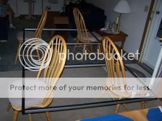

I used 1" square aluminum tubing, which they cut to my specs, included all the connectors, and shipped in an undestructible box. No brackets, no drilling and went together in a snap !
The inside of the tubing has grooves in it, which helps with the fit of the connectors and holds it all together. Frame dimensions are 54" x 96".

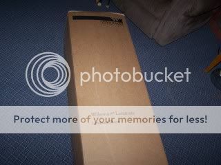

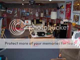

I used a 5' x 10' sheet of Wilsonart Designer White laminate for my basement room. Actual laminate was 61" x 121", which I used 61" x 102" for a 111" diaganol screen, with 3" borders.

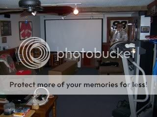

Here are some shots of my room and screen wall.
1st a shot from my seating position, about 20 ft from the screen
Now a shot towards the back of the room and the prime seats
and one of the screen wall

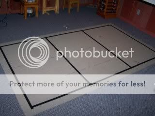

Here are the original home made mounting brackets that held up the old screen, and are used to hold the new screen as well.
I used industrial strength velcro to secure the laminate to the aluminum frame
3" Black velvet tape was used for the border, and C clamps are used on each side of the frame with small chains hooked to the brackets to hang the screen. 3" overhang of laminate past the frame for possible install of rope lighting in the future. That was an original thought, but I like it the way it is right now.

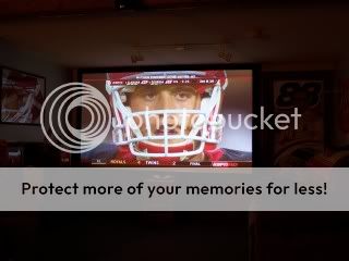

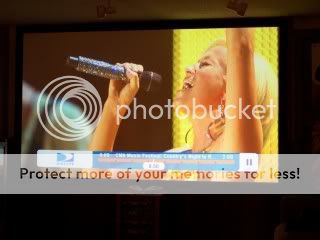

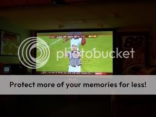

Then of course a screen build would not be complete without some screen shots. These were taken from my seat location without any zoom (except for Kellie Pickler), using a kodak 710z ( I think ) and a 3 way end table lamp on @ 50 watts. Infocus IN72 zoomed out to the max @ about 15 feet from the screen to fill screen. Screen size is awaiting a 1080p projector, hopefully next year !
This is a multi-purpose room, so it is not a "batcave" and it has white ceiling and partial walls with wainscoat using boards from a barn that was destroyed in a local tornado. Pictures do look futher away than they look from viewing location.

I laid the assembled frame on the back of the laminate, traced it, and applied the loop side velcro to the laminate. Hook side applied to the frame, and just laid the frame onto the laminate. Then my wife and I "walked" our hands around the frame to mush the velcro together. The connectors used to assemble the frame were indeed very easy to use, This was one of the main reasons I chose this method of frame. The screen was then turned over and the 3" velvet tape was applied with the screen laying on the floor.

First up a BIG thanks to 20fan for posting this idea, and to everyone for inputting to this thread.
I have had a roll of DW waiting for me to build a frame. After seeing this thread - I jumped on the Aluminum 80/20 idea.
Last week I ordered the 80/20 "kit" from a local distributor in the Chicago area. The cost came in at $154.00 (shipping extra) for a 104" x 60" frame. A bit higher than I expected but still far less than the value of my time in making sawdust.
Just got a call my frame is in and ready for pickup, 6 days from time of order - I'm happy!!
Hopefully I will have a finished product to post here by next Monday.
Thanks Again!

20Fan:
Thank you! Thank you! Thank you for posting this. I have been running around in circles the past week trying to figure out how to build my own screen and frame (using WilsonArt as my material). I'm a complete idiot when it comes to handyman stuff like this so this is very helpful. However, I have some more total newbie/idiot questions for you...
1. Did you have to cut the laminate at all or was it "cut to size" for you? My understanding is that you have to order WilsonArt by the sheet (you can't have them custom cut). If you had to cut it, what did you use to cut it and any special tips I should be aware of when cutting it?
2. I'm assuming when you order the frame, you just give them the dimensions and they take care of everything for you or do I have to specify more than that (i.e. I need center supports, etc.)? I want a 52" x 92" actual viewing screen size (106") so are these the dimensions I should have the frame built?
3. Any reason you don't just have the laminate line up exactly with the frame - or shorten it so you only have an inch or so overlap of laminate without framing? Just curious why the frame is set 3" in from the edges of the laminate.
4. Where can you purchase "industrial" velcro?
5. This doesn't apply to you so you may not be able to answer it, but any ideas how a guy could mount this frame directly to the wall? I don't have the option to hang it from a ceiling. Can you drill brackets or hooks into these frames???
Travis
Thanks Again!
Glad to share this method with everyone. I am very happy with my outcome, and glad others are finding this an option for them. Make sure you share your results and post lots of pics !
20Fan
