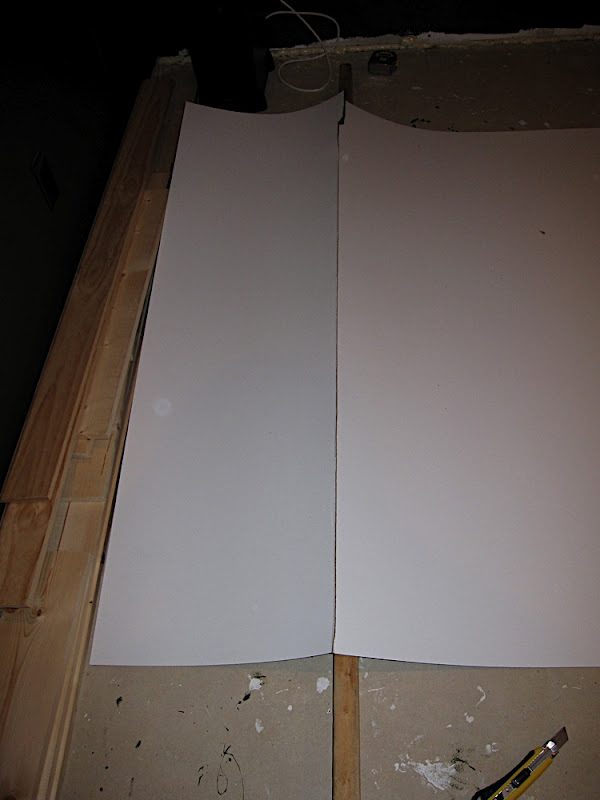

I "sandwiched" my laminate between two lengths of my 1x4 poplar frame and clamped it tight at the designated cut-off. I then put a Brand New blade in my utility knife and proceeded to score the back-side of the laminate, using the poplar board as a guide. I put a good deal of pressure on each pass. After about 6 or 7 passes, the laminate cut through fine. Not the prettiest of cuts, mind you, but serviceable considering it will be covered by trim anyway. Almost took 5 minutes.
Attachment 125540
Attachment 125541
