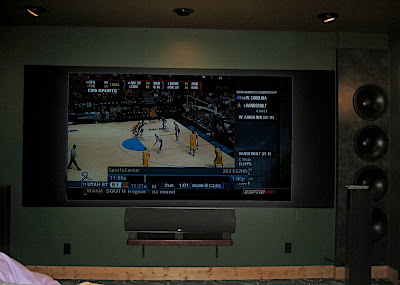

Originally Posted by docprego View Post
Please explain that in more detail, I am not certain I understand it fully.
I am going to mask the sides when I watch 16:9 as my screen is 2.35:1
My frame tapers in towards the screen and leaves me a 3/8th lip.
I see the foam you used is .5
I was wondering/hoping that I could use the foam and it would be OK resting (well it would be a tight fit so it would hold itself w/o any velcro or magnets etc.) on the 3/8 lip.
Lee Weber is offline
post #33 of 53 Old 01-23-2009, 11:34 AM - Thread Starter
docprego's Avatar
Location: Henderson, NV
Posts: 1,666
Should be fine, those side masks will be a lot shorter and they will rest on the inner part of the lower screen frame. Because of that gravity will be much less of a factor. Make them fit snug enough where they will not have any lateral movement, should be easy to do.

What is everyone using to glue the velvet down?
I use spray adhesive but what a mess it is! The adhesive gets mixed with the velvet dust that is released when you stretch the velvet and creates the stickiest muck that just will not come off your fingers! I wish someone could suggest a better (less messy) way to attach the velvet. On the bright side, although it is a mess it is very effective at securing the velvet.

I had a bit of a fiasco with my masking panels recently. When using them last week I noticed that there was a LOT of light spilling over on them, a distractingly large amount. I figured I came this far I might as well make them perfect so I set out to fix them. I measured the bar heights on 4 separate movies, 2 were in the 2.35:1 ratio and ther other 2 were 2.40:1. I measured the bars at 7.5 inches tall each. Somehow I had made the masks 8.25 inches the first time around. While that extra .75 inch may not sound like much it was really bugging me to see the movie image projected that much on to the upper and the lower masks. So I disassembled the masks and cut them down to 7.5 inches. I put the masks back together and recovered them. Unfortunately due to the decreased size the material somehow ended up looking pretty awful after I re stretched it. In addition I managed to get some adhesive on the velvet which was impossible to remove. I am going to have to buy new velvet tomorrow and recover them yet again. But in the meanwhile tonight I was able to install the newly modified masks and give them a real workout. They are now perfect!

Originally Posted by dustinst22 View Post
Has anyone tried using gatorboard for masking?
From what I understand, it is extremely rigid while still light. Would it still be light enough for friction to hold it up?
I was thinking of using your same design with 1/2" gatorboard covered with this material http://www.fpi-protostar.com/flock.htm Since my screen is 118", I think the 1/2" should work better than 3/8" to avoid any warping. There is a gap of 1" from the front of the frame to the screen, so there would still be some spacing in back of the masking without it touching the screen material.
I have a Carada precision screen, and supposedly the prostar material matches the Carada "black hole" velvet very closely.
I've found a local shop that will cut me multiple pieces of gatorboard to size so that I can build several panels for 2.39:1 or 2.35:1 or 4:3. Total cost for all the boards cut by them to size will be $116. It looks like roughly another $100 for the prostar material for all 6 panels.
I'm still putting together my home theater and have several things going on, so this project will have to wait another week or so, but looking forward to it.
I haven't worked with Gatorboard but I can tell you that my masks are not particularly lightweight. I finished them both top and bottom for an even edge with a piece of aluminum j channel which significantly increased their mass. After a year of use they are still staying firmly in position on friction alone.
The Protostar material works and looks fantastic for masking panels, and yes it does match the Carada frame material. Click on the link http://www.avsforum.com/avs-vb/showthread.php?t=1169586 and later in the thread you'll see pictures of it used on 1/2" rigid insulation with sheetrock corner bead edges. I use tension rods (though any full round material would work) rather than friction fit, and have full flexibility for where I want the panels to position.

Thanks Jive...I am building a masking system from your great idea! I could not find the metal peices at Lowes...But what I did find is a duplicate peices made from white vinyl...It has the same 1/2 inch area to insert foam board into and comes in a 10 foot length with a nice sharp edge...Trying to decide if Im going to run them under the velvet like yours or paint them flat black and have a clean faced edge with the trim showing...The channels are vinyl J bead part # 15437 @ 1.38 each at Lowes...Thanks...Al

Once you put the vinyl edging on the panels, check for overall stiffness. One thing I liked about the metal edging is that it makes for a very rigid panel and reinforces the splice where the lengths of insulation come together. As such, I haven't noticed any sag across the almost 12' span to date.
