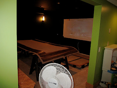

I'm using Panamorph UH380 a-lens, here is grid projection onto the curved frame prior to skin, lens was not fully dialed in at this shot:
Maybe this fall when I put some 703 fiberglass behind the frame as bass absorber I'll do some pincushion on flat wall vs curved screen study.
Side pict, just frame and "skinned" but prior to the velvet border:
Mtg to wall:
Eye candy - here is one of my "showcase" picts. No photoshop, just simple digital point/shoot mounted on tripod:
Like I said, thx to many here for showing me the DIY way.
