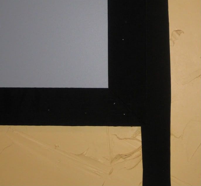

Other than some tweaking along the line, I wrapped up my masking project today. I'm quite pleased with the results; it adjusts so easily to anywhere you want, knocks those "digital black (gray)" bars down, and gives that perceived pop to the picture you'd expect.
I used Triple Black Velvet from syfabrics.com. Four yards cost only forty bucks, and worked very well. While Fidelio Black is better, nothing I've seen can touch Carada's Black Hole fabric. But to kill the gray bars, the Triple Black can do the job very well.

The Triple Black Velvet has worked well enough that I decided to have some pieces hemmed up to drape over the sides of my six foot tall Dunlavy SC-IVA's and the top of my HRCC center channel. They absolutely kill off all reflected light from the screen and finalize the masking and darkening of the front wall of my system.
Pretty happy about things at the moment. I may rebuild the masks at some point, as I've learned a few things I can improve next time, but for now it's time to just put on the movies.

Got the Protostar material in today, and it looks very much like the material on the Carada frames. Self adhesive backing is nice, and the material isn't real floppy like velvet, so it should be easier to work with.
If I decide to rebuild the masks, I may talk to a couple of folks in the sign business that I know. They are quite adept at laying out stock like this I'd bet, and really sharp edges and a flat front are important.

I worked with a small scale mask and the protostar sample yesterday. It's a real good performer, just like the Carada frame material.
It will adhere instantly, and you get one shot at getting it right. I found the biggest issue for me was to lay it straight on the mask as you go down it's length, so that the overlap on the back is consistent. Also, it will obviously mimic every contour of the mask, and it showed that the j-metal edge may not be the last word in perfection as shadowed on the screen.
I do think this is the better material over velvet, but it may require more thinking on the actual mask base. What could be used in lieu of rigid insulation and j-metal edging that would still not be too heavy to move easily up and down and not be too much weight on the ground rod clamps on the tension rods? And it must come in a 10', one piece length.

I think adding any kind of compound onto the Jmetal and trying to sand it out, etc. would not work. First, it'd probably just crack right off and second, I suspect it'd be difficult to get the top edge (or bottom edge of the upper panel), to be any truer than the metal already is.
My thoughts are starting to sway back to using the Triple Black Velvet, as it is a bit more forgiving in showing the flaws of the Jmetal than the Protostar material. The lines that the Jmetal show on the front face of the mask, when covered with Protostar, don't bother me as much.
The goals I had wished to accomplish with the Protostar was to have a very crisp top (or bottom) edge, and have the adhesive nature of it be easier to work with. The first is dependent completely on the material it covers, and the Jmetal is just not perfectly smooth/straight down it's length.

After deliberation and experimentation I did order a roll of 30"x200" Protostar material ($75 plus $16.20 shipping). The lack of reflectivity on the Protostar vs. the Triple Black Velvet is hard to deny. The edge of the jmetal turns out to not be that much of a major issue when comparing one fabric to the other. Just got to turn the finished panel to put the best edge to the image.
It actually lays out pretty easily once you get the hang of it, though I may still see what my friends at the sign shop want to charge to do it.

My Protostar masking panels are complete and up. Initial impressions are VERY good! I paid a sign shop for an hours labor to have the fabric put on the masks, and they did a much better job than I would have, surely. Nice crisp edges, tightly pulled. The issue of the panel/metal edging contours showing through the Protostar fabric is a good bit less than I anticipated. The fabric does very much resemble the Carada frame covering when the masking panel is in place with the screen. I'd say the only thing I want to watch at this point is to see how the adhesive holds up to warm and hot temperature. I'm not expecting any problem.
I also came up with a better grommet/Ubolt setup than my first set of panels I built using the Triple Black Velvet.

I just finished doing two separate 85" screens using some of the last of my Black Velvet ( SY's Triple Plush variety ) and one thing is for certain....under full room illumination the BV easily looks worlds better than the Protostar. Feels so much better to the touch as well.
I'm going to reserve a final judgment until I actually do a Screen's Trim with the Protostar.....but in a side-by-side comparison under intense light, it seems the only thing the Black Velvet falls short on is not having a total lack of "sheen".
However in a great many previous uses, I've never be able to see the "projected" illumination of any light spill onto the Black Velvet , be it from a image or the PJ's start-up screen.
All that being said, as a "Sticky" the Protostar is still a quantum leap beyond any previously mentioned adhesive backed Black Felt or suedo-Black Velvet as far as having a lack of reflectivity. But is it a viable alternative to actual Black Velvet in the making of actual Screen Trim? Can't say that...yet, because to me, a classy appearance both in the dark and full room lighting is crucial, and as of now....the difference under bright light still shows the Protostar to resemble a Black Felt more than a luxurious "Black" that Black Velvet presents, and the Black Velvet does it all (light absorbing and great looks ) exceptionally well.
Add to that the fact the Black Velvet cost just $6.99 yd for a 52" x 36" section and that for the $75.00 (less shipping) the Protostar costs for 30" x 200", for the same amount (length) of Black Velvet it would cost just $45.00 w/shipping and you'd get over an extra 1-1/2 feet of width as well.
I will however say at this conjecture that no matter what...if stapling or gluing Black Velvet Cloth is not desirable, then the Protostar is the best choice of all the "Stickys"...price not withstanding.
Here is a image of a Screen just done in Black Velvet Trim. Later today while present, I'll do a close up comparison between the ProtoStar and this particular Screen's trim, shoot a few images, and post 'em up.

Yeah....I could have used both yesterday. But I got'ter dun anywho.
Results were IMO identical to Triple Plush Black Velvet except in the most extreme intensely directed light tests where you could then see intermittent fibers on the BV reflecting light. But here's something....as far as Projected light over spill, the BV did better because of the depth of it's "Pile". The much flatter Protostar showed the over spill more noticeably.
So my take is...for application to large flat surfaces for the purpose of eliminating and indirect light Reflection, the Protostar is an excellent...if not indeed more expensive proposition.
Black Velvet takes the honors as far as wrapping Screen trim. It works too well, and cuts / applies too easily...and for far less expense than the Protostar. Having said that...I'll find plenty of opportunistic uses for the remaining Protostar material, and when needed again for similar applications I won't hesitate one moment to buy / use it again. I have never come across the level of performance it offers in a Self-Adhesive backed Tape.
......the little white specks you see are Nail heads not as of yet tapped below the Velvet.
.......................Sy's Triple Plush Black Velvet...................Protostar..............
You might also note that the only place where you can see any difference is right along the outside edge of the TPBV....because on such a "wrapped" edge the fibers stick out at right angles and can collect / reflect more light. On the "Flat" they exhibit none of that behavior.
In fact....stare at the last image for a while and you can perceive that the TPBV is the "Blacker' of the two...but for the wrong reasons......more light reflection.
