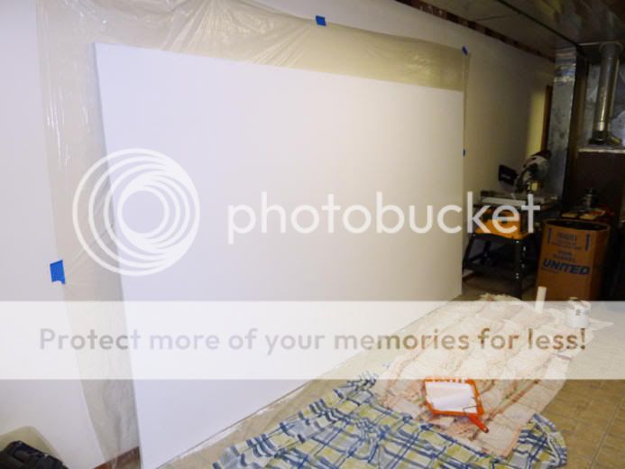

Here's the screen with BOC stretched over an aluminum frame--it's huge!

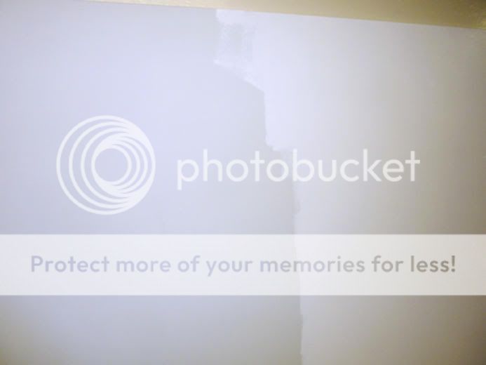

Here's half the screen painted with Behr UPW Flat Enamel.Notice how grey the BOC is against the enamel. Sure don't see this until you paint it.

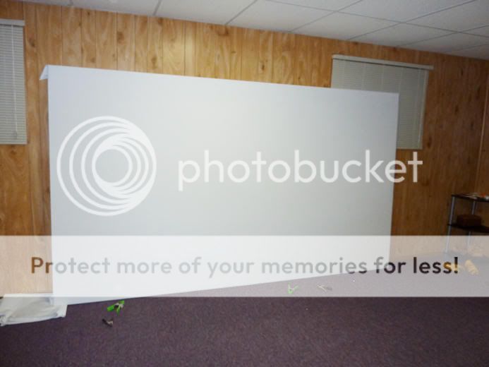

Here's the first coat on. The flash is trying to counteract the flourescent light so the colors look off, but this baby is white!. Did a screen test with the projector and it's awesome just with this base coat on.
Doing a second coat today. More to come early next week. I'm going out of town tomorrow.

Woohoo, I'm done! I looked sideways on the screen and there were still some vague sprayed high/low lustre tracks so I was worried about that when putting first light on to it. Also, the screen picked up some dust blobs here and there so I carefully plucked those off.
Handling the screen by myself was a tall order. I had to maneuver it out from behind and around a furnace through a door. Halfway through the door, I noticed I caught a protuding handle on the furnace and it was poking a dent in the canvas--aaaeeeeiiii. I recovered from that and the "dent" faded out and back to a flat surface--yay! I then struggled to move it through the rec room and lift it unto a box over the old screen. (I had done this twice already with pre-finish coats, but this time I had to be super careful). Now, startup my Mits HC3800, zoom to an image to fill the screen and focus. I had tears in my eyes. The image was pristine. Very even across the screen, no hot or cold spots. Colors are fantastic along with contrast and enough light in low mode. I watched several hours of TV and a DVD movie, then went to bed--happy!!

1. Put together 128"x72" aluminum square tube frame.
2. Stretch BOC over it.
3. Rolled two coats of Behr 1850 UPW flat enamel on the BOC.

6. Checked the image on projector. Could see some hot/cold tracks due to rolling. Screen had a lot of particle grain to it. Definitely higher gain than one. I compared to a 1.0 gain material and the 2+ gain screen already in place, and I would say the screen was 1.4+. Overall, the screen had a slight sheen to it though, but the image seemed muddy to me (not sure how else to describe it) --hmm, I was worried from this point on.

* Rolled Behr UPW Flat enamel over BOC is pretty good and many would like it as is. Could not see roller marks.
* Rolled RS-MM-LL gives a different image impression than sprayed. I did not like it rolled.

This is a shot of the first coat of Behr 1850 UPW Flat Enamel on the BOC --not bad!
First image on new RS-MaxxMudd-LL screen. Room is completely dark.
