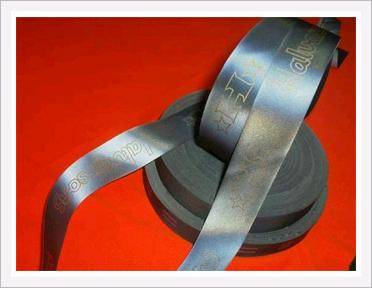

I'm also going to try and find some Retro-reflection fabric (White or and Silver)
to put behind the different shades of spandex...whites..grays..silver and black.
The spandex will give me the smooth surface on top and hopefully the Retro fabric will do it's job of reflecting the light back to it's source thru the spandex .
I'm hoping the Retro fabric will also help increase the gain .
There's different grades of Retro reflective fabric and have to do some reading up on that.Plus I have to find it where it's big enough. If anyone has it other than online it would be in NYC's Fabric district...maybe I'll get lucky.
Here's some nice black and silver retro reflective fabric but it's for striping clothes but looks nice.
It has a performance of : 100 cd/lux.
Aaaah so many combinations ..I'll just have to experiment and see what works.
I'll also look for some retro reflective PVC while I'm there

Some info on the retro reflective fabric..
The retro reflective fabric has tiny prisms just like the High Power gain screens.
"Millions of imbedded tiny glass balls or prisms multiply light back to the source.
The power of a car engine is measured by horsepower - the more the better. The same can be said for reflective material, which is measured by candle power (cd/lux/m²). There is a clear relationship between retroreflective performance of a surface and the distance at which it can be seen. According to 3M data, the retroreflective performance level (candle power) of white clothing is 0.1 - 0.3 , a license plate's performance level is at 50 and typical retroreflective silver fabric has a performance level of 500.
As the following chart depicts, with increasing retroreflective performance, sight distance also increases, clearly demonstrating that reflective materials allow for optimal visibility during low light level conditions. However, not all reflective materials are the same, as there are reflective materials available that range from 65-600 candle power. Remember, the brighter the better."

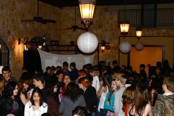

I just did a 4 way Spandex screen for a DJ type setup. However my screen was used on a rear projection setup. I did some testing and research prior on choosing the fabric. My finding is that a cotton-spandex mix is the best to use as a screen, the lycra-spandex mix, although it would be ok the PQ suffers.
While doing a test run ... the rear projection on this fabric works great, but you get probably a 10 to 20% higher light/picture on the front (where the projector is projecting).
Some thought... you could do a light frame where to attach the spandex to an this way you can experiment on whether you need a reflective backing or a black backing, or if anything on the back. I can tell you that just using it as front/rear screen has an acceptable PQ, if you are looking for something inexpensive but with better PQ there are other alternatives.

You have any pictures with the lights off and what did your friends think of the spandex stretched up like that ?
I'll look see if I have any pictures of the screen by it self, I think I took some pictures while testing the spandex.
I only had two adults saying anything, my wife, and another mom. My wife helped on making the screen, took me to the fabric store and calculated the material needed, and of course mentioned that it was a cool idea. The other mom mentioned that it looked very good.
Teenagers did not say anything, but my daughters liked it too.
There is a commercial company selling this type of stretchable DJ screens, and they aren't cheep.
The screen probably won't see alot of action, maybe two times a year, I have my projector on a dedicated room with a fixed BOC screen that serves its purpose very well.

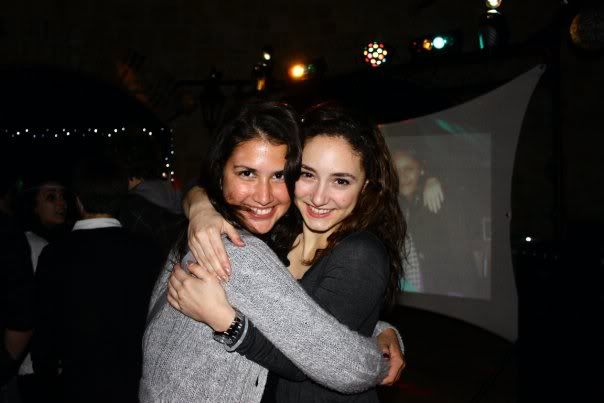

This is the closest I found as far as a picture with no lights. Could not find a picture of the screen while testing, either is on a different SD card or got deleted. I hope this gives you a better idea.

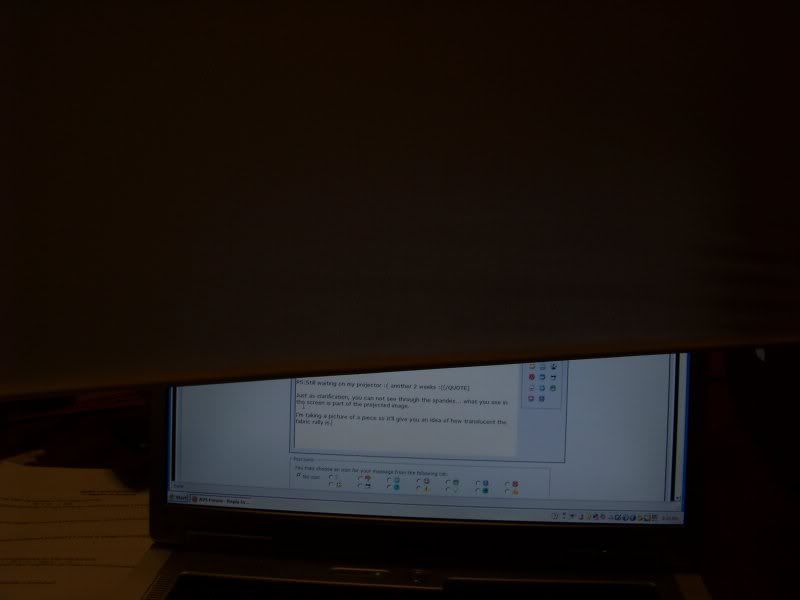

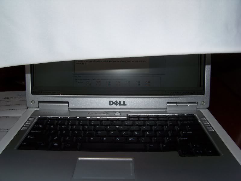

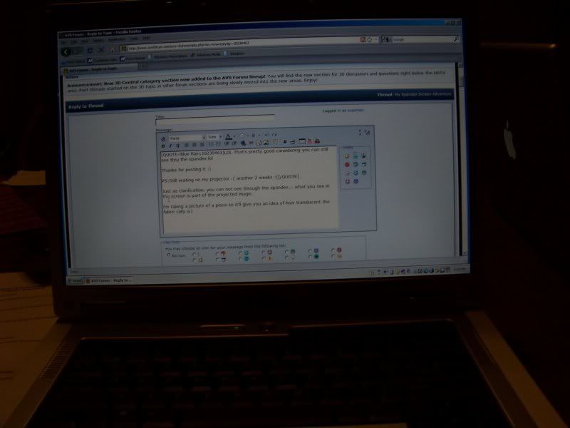

Originally Posted by Blue Rain View Post
LOL That's pretty good considering you can still see thru the spandex lol
Thanks for posting it
PS:Still waiting on my projector another 2 weeks
Just as clarification, you can not see through the spandex... what you see in the screen is part of the projected image.
I'm taking a picture of a piece so it'll give you an idea of how translucent the fabric rally is.
Hope this gives you a better idea.
