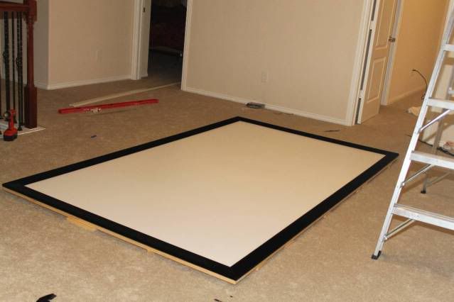

1. Bought 1" Galvanised 18 gauge finish nail - porter cable brand : I have Bostitch finish nailer which takes uo to 2 3/8".
what is meant by bright finish nails - mentioned by missisipi
2. Where should I start the nailin process?
3. How many nails i should put...?
4. Can i be able to lift the screen by touching the velvet trim? --
sorry - i have asked so many questions,....but i listen and follow - one day i will learn..lol..one fine day..
Help me out..
Live till die

Questions:
5.When i nail it, i have to go through the laminate sheet ? is it ok !
6. During nailing - What is the plan b if the nail broke half way?
Live till die

- Not yet..I have to calculate...
Sorry I couldn't imagine the way that u attached the velvet trim..could u please post some pics...
Questions:
HELL NO! Don't EVEN consider it or you'll be very sorry. Concussive penetration will crack the laminate
You should have enough wood to hit around the edges...and if not...ADD it!
Awwww....C'mon. I've never "broke" a nail while hammering...only bent them, and if you use 1" Bright "Finish" nails, you don't have much of a chance of even bending them before they sink through the MDF into the underlying Poplar.
I'm sorry, but really,the build you've attempted is obviously something a bit beyond the scope of what you should have attempted first off. You simply did not know (...or were not correctly advised of...) enough "right answers" before you jumped...a common mistake among aspiring and anxious DIY'ers. Trying to "learn" while doing only works if you don't get ahead of the info needed to do it right to begin with.
I will give you this much...at least you do go slow and ask before real disaster strikes. And what you do/have completed looks better than most beginners might accomplish.
So far....
Now add some wood strips around /on the sides and do it right.
Sorry for the intensity of my response this time around but it's frustrating to see a potentially great project headed down the tubes. (...nailing though Laminate....Gaaaaaaa!!!) Given the chance, I'd never of suggested Laminate for your project...too many "build issues' and limited usage. But we are already well past that point so just consider doing what NEEDS to be done and do it. PM me for complete instructions to salvage this project, then post the end results. You don't need (...or deserve...)any more public spankings.

A more important question; how much wood is available around the perimeter to attach the Trim to?
after attachin the trims - underneath the trim - distance between laminate end and wood end ( available Wood) ( trim width is 3.25+velvet )
1. top - 2"
2. Bottom - 2"
3,4. Sides screwed up - 0.75"

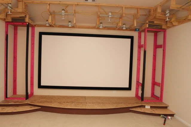

huf....so far it looks ok..
Added the Velvet trim to the trim using Velcro Industrial Strip..Bought it from Michels using 40% coupon...It didnt push the trim too much...
Screen is really Heavy...got help from neighbour to hang it on wall..also added the Spacer in the bottom..
Big thanks to Mississippi, Knight, Bizzil & Vagetto....

bro, LOOKS GREAT! hurry up and fininsh the home theater and post some screenshots.
where are you going to place the center channel? below the screen and tilted upward? above the screen and pointed downward?
A good question. I'd guess between the Framing above the Screen - dead center between the Floods.
BTW sathyakamaraj,
Consider changing out all those Flood bulbs to Spots, and using "Eye Lid" shields on the ones directly in front of, and closest to the screen. Those type shields will give a more directed 'wash' against the screen, and accommodate colored "Gels" to achieve an even more attractive effect.
Also, plan on having to mask off the sides of those column structures at either side of the Screen, as well as the rear-ward ceiling area that runs up against the Screen wall. Those surfaces are VERY close to the Screen and will have to be a very dark paint (Flat) or you'll need to use Black Velvet or something like the self adhesive Protostar Telescope Flocking
http://www.fpi-protostar.com/flock.htm
..............so as to prevent the insides of the screen enclosure from lighting up during bright scenes.
(...the Screen Wall itself receives almost no light from the Screen's output as so being is not any real concern.)
Not much else to critique....it all looks well thought out.

thanks buds...Yes center speaker will be installed on ceiling tilted down..I changed the layout just to get 120" Screen - so CS went up...
I will keep the screen for another 1 month hangin - then it will be in my other bedroon sitting..(for how long i really dont know) -
I will be buying 1" Linacoustic Roll sometimes next week + GOM fabric = which will cover the screen wall --
I think I wont be able to put rope lights behind the screen like i planned before...i have to read to find a way how to reflect it from behind the screen ...if not..cut..no rope light
Live till die

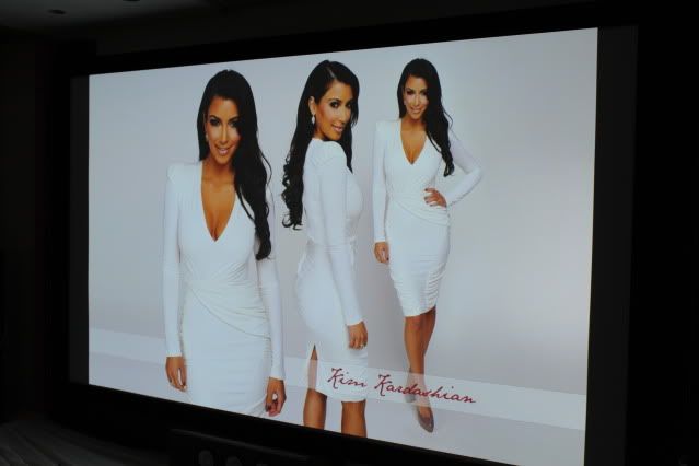

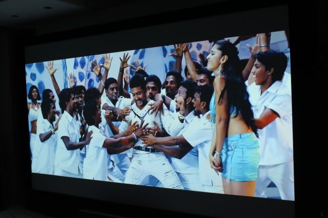

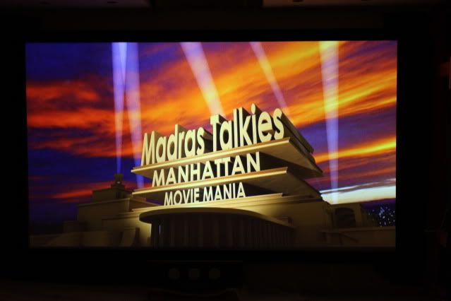

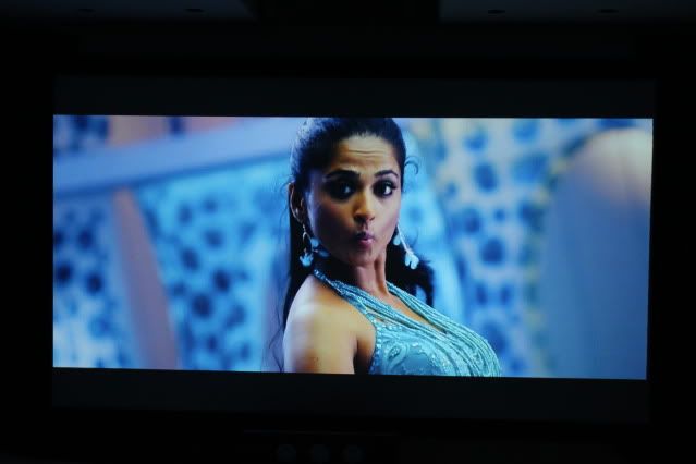

thanks everyone...screen is awesome.............
Loved the projector, Axioms and Onkyo 3007 combination
tested and packed it...cant wait for final...little motivation after i saw movies and ps3 game
