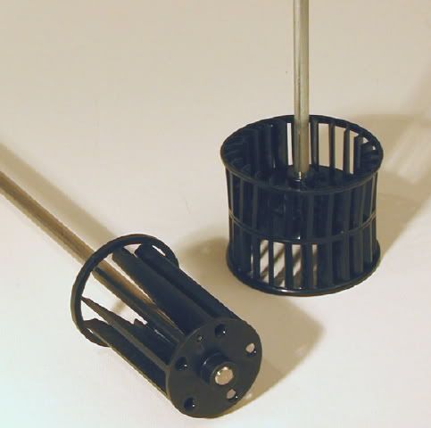

The Squirrel Cage "Turbine" Mixer:
(Gallon and Quart size shown, however the Gallon size disassembles into a "Quart Sized" Turbine.)
Stir slowly but thoroughly...........
The Mix should be thin enough to run off the Mixing Tool like thin soup, as seen in the Video. If not, add more water and stir well until you get the desired thinness.
