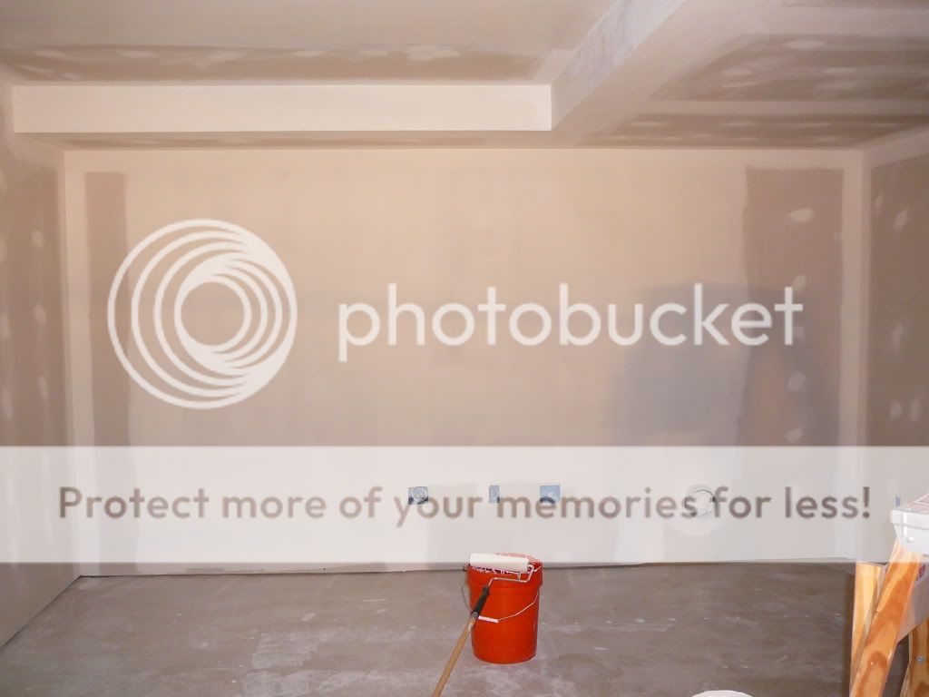

So I'm planning to paint my screen directly on the drywall in my dedicated HT (100% light controlled) and I've got the screen wall already drywalled, sanded, primed (3 coats, rolled) and sanded (between coats and also after the final coat). Right now it's smooth. Very smooth. And very white.
I'm planning to use the S-I-L-V-E-R mix, sprayed on with the Wagner Control Spray gun. But I did notice that there are some very slight variations in the "tone" of the entire screen wall. Might be a function of some of the mud showing through the primer, who knows. But it's not obvious... it's only noticeable in perfect lighting conditions with dual 500-Watt halogens while I'm working in the room.
My question is: do I need to lay down some sort of substrate (white paint or other type of primer) before spraying on the final S-I-L-V-E-R mix (planning 7 dusted coats)? Or can I go right over the primed wall as it stands now? The current screen wall is so white and so smooth that I get the feeling that I don't need to do any more to it, but I wanted to check here with the experts first before I went ahead with the final mix.
Also, how smooth should the final screen be, after all 7 duster coats? Should it be "textured" because of the silver flakes, or should it be smooth as glass?

imperfections to drywall will be grossly enhanced when projected on with SILVER. high sides will show up as brighter and low dips will show up as shadows. my suggestion to do a little more work getting the screen prep'ed.
as for the your screen being already white. you'll want to go with a quality brand's brightest non primer white in a satin to semi-gloss finish. behr, sherman williams, dutch boy, valspar...
as for the final finish... it should not so much glass smooth... as it should be the finest sandpaper you ever touched... like a 3M 1500 - 2000grit.

Well, the drywall itself was skim-coated smooth with mud before I did any sanding or priming. It's flat and smooth. There are no imperfections due to screw holes or seams.
On the paint, I'll try to get some of the whitest white paint I can find in semi-gloss. Probably Benjamin Moore, since I really like their paints. But what do I do with it, roll it on or spray it on? Do I sand it when it dries or just leave it alone?
Do I spray all 7 of the topcoats the same, or do I put the last ones on heavier? Or lighter?
I want to get this right from the start. I'd hate to be disappointed in the results just because I didn't ask enough questions.

So from what I understand, you do NOT want to have a smooth painted surface before the SILVER goes on. Instead, you want a smooth PRIMED surface, just like what I've already got.
Okay, so I'm back to spraying the SILVER mixture directly onto the 3 coats of sanded primer that I have right now.

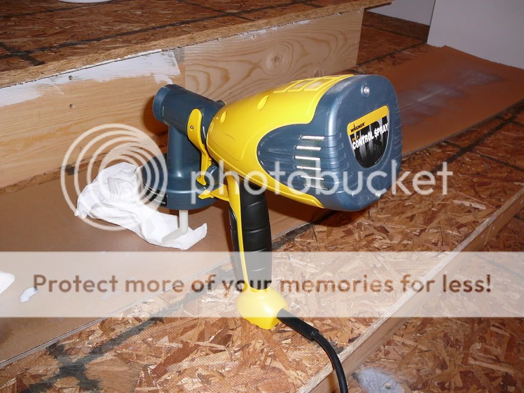

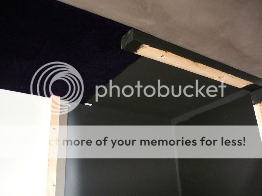

Well, I sprayed about 10 coats (so far) of the SILVER mixture on my wall. For some reason, the Wagner sprayer wouldn't spray the regular mixture, so I had to thin it with about TWICE the normal amount of water. It sprays pretty well now, but since it's so diluted, I'm going to put on twice the number of coats.
I can see from the overspray that there is a lot of silver reflectivity in the mixture. Yet it still looks pretty darn "white" against the base background primer. Almost as if the mixture was sprayed on clear. It should be interesting when I throw an image onto it.
Anyways, it's slow-going because of all the coats, but I think it'll turn out nicely. The screen wall already looks pretty uniform across the surface and I figure I've got another 2 or 3 more coats to go.
--Drew

It takes a while to get the knack for spraying the overlap coats just right. I had to thin my mixture down more than expected to, otherwise the spray cone wasn't wide enough. The cheaper Wagner (which I have) doesn't spray as wide a cone as the more expensive heavy duty model. After all is done, you might see vague light/dark tracks where the paint did not overlap properly which I toned down somewhat with a dusting coat afterwords--a spray held further away.
threed123 is offline

Try to wait as long as you can until you do, and then use the lightest Plastic painter Drop you can find (...check HD) HD sells a 2x pkg of 9' x 12' x 1 mil plastic that is ideal for such.
MississippiMan is online now
post #27 of 29 Old 07-24-2010, 04:21 PM - Thread Starter
Drew_V's Avatar
Join Date: Dec 2009
Posts: 999
It should be easy enough to do once I get the false wall built. I'm just going to put plastic across the face of the opening in the false wall (on the wood), so I don't have to tape the plastic directly to the screen wall itself.
Yeah, that paint splatters everywhere when you're rolling it, although I did paint manage to paint the ceiling successfully without splattering the screen wall, so I'm guessing the walls won't be a big deal.

Anyways, I started with just the bare drywall. The drywall guy put a skim coat of mud on it to help smooth everything out and to keep the surface texture uniform. Also, once I put primer on the wall, it would be more uniform in terms of the primer "soaking into" the wall.
Then, I put on 5 coats (I think) of Glidden PVA-type primer. It was very thin, but it looks like it covered pretty evenly. I sanded between coats with 180 grit paper. It was VERY smooth. Finally, I used a Wagner Control Spray gun (looks like an older model) to apply the mixture. Here's the mixture I used:

Here's the spray gun I used:
And here's a closeup shot of the wall after spraying. You can see the amount of overspray on the surrounding black border, although you can see small specks of silver extending all the way out to the SIDE walls, which are about 2 feet away. That stuff really travels far!
