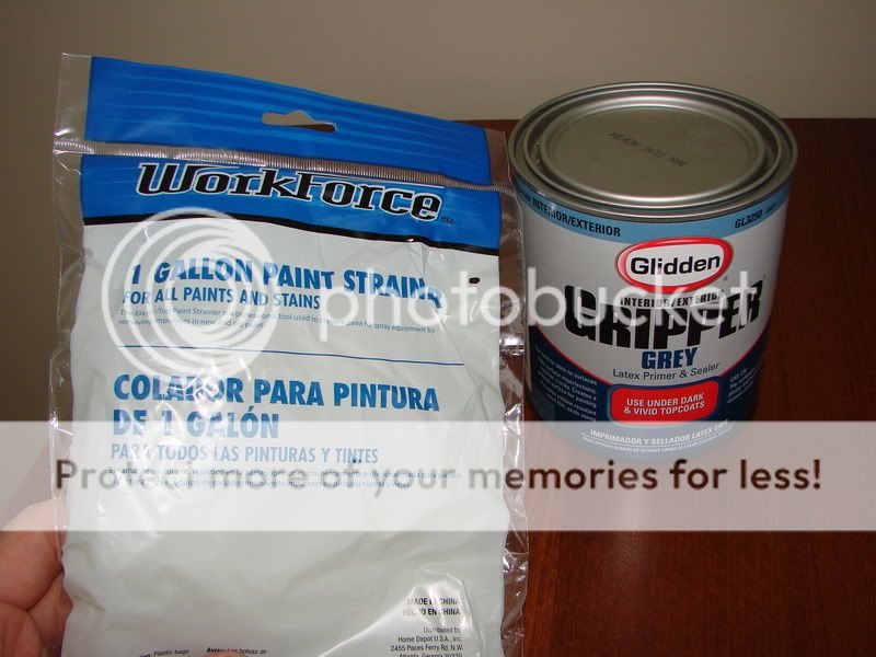

post #129 of 139 Old 02-05-2011, 05:05 PM
bo4uofm's Avatar
Join Date: Oct 2008
Location: Indianapolis, IN
Posts: 21
Originally Posted by develvjd- View Post
OK MM, I'll take a crack at it without the full skim coat and see what it looks like after a couple coats of grey primer.
I plan to use this: Is Glidden Gripper Grey OK? Also, I got the standard mesh paint strainers, these OK? Figured I'd ask before using so I can return if needed.
Also, I plan to prime with White after grey before the SF mix. Is this necessary?
Thanks! Grey primer goes on tomorrow.
Why the two different primers?
bo4uofm is offline
post #130 of 139 Old 02-05-2011, 06:04 PM
pb_maxxx's Avatar
Join Date: Aug 2005
Location: chicago
Posts: 2,561
Quoted: 120 Post(s)
Liked: 57
using a grey primer.. helps you see a find all the imperfections much better than a white primer.
as for the white primer... it doesn't necessarily have to a primer... but all good SF or MaxxMudd screens should start with a white basecoat or white substrate. That is, unless you are going the mirror or dibond aluminum substrates.
SF or MaxxMudd screens work on the principles of Light Fusion, and therefore they are semi-translucent to make good use of the white or mirror substrates to effectively improve white levels over their grey counterparts.
pb_maxxx is offline

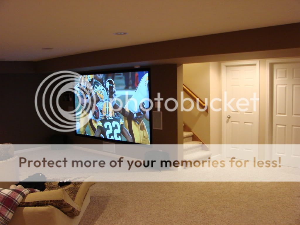

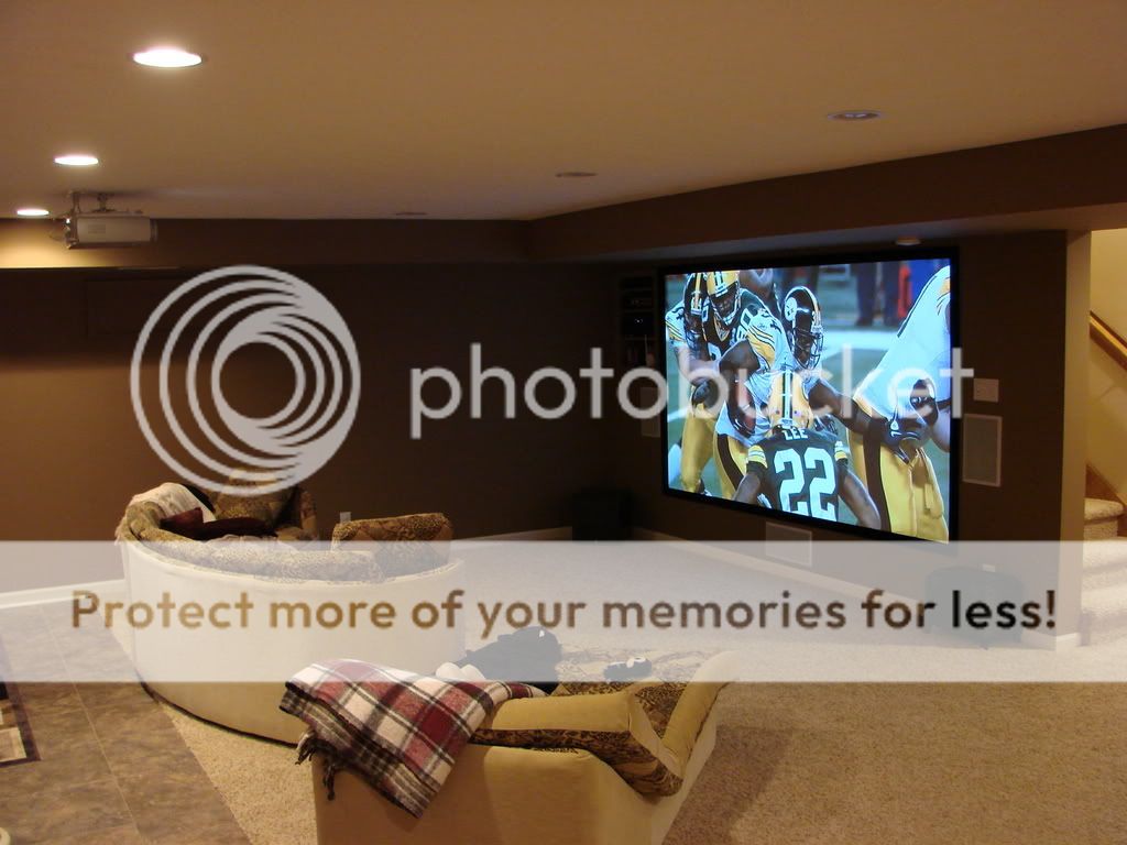

post #135 of 139 Old 02-25-2011, 06:10 AM - Thread Starter
develvjd-'s Avatar
Join Date: Nov 2010
Posts: 112
reposting my Superbowl screenshots in my build thread for the sake of posterity...
I like to watch sports with the lights on... so here you go- high ambient light shots. These all represent the room conditions pretty well. 11 (yes eleven) 65W flood incandescents FULL ON and one CFL full on. You can see in some of the pics that the three incandescents closest to the screen are off. Light carpet, ultra white ceiling, 4" from screen to bulkhead, pretty much all the mean things you can do to a screen and I'm floored with the results.
**Disclaimer: The pics pick up a blue tint from my $150 camera... it's not there in reality.
Epson 8350
Living room ECO mode
12'3" throw
120" diag
Silver Fire 3.0 on drywall
OTA HD signal, entry model Yamaha receiver, Monoprice speakers, HDMI cable, etc.
enough already...
action shot from the back of the room to show ambient lighting "challenges"
angle 2, same lighting, diagonal corner of room
not a bad seat in the house with the SF mix.
Spoiler
more screen performance vs. ambient lighting
AYS??
stitched combination of the 2 photos above (in the spoiler tags). This is really what the screen looks like in these lighting conditions.
just sayin.
