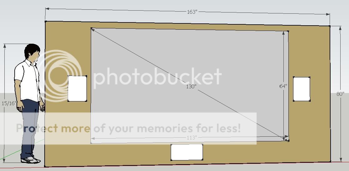

So, let's get right into it. 955 SF will be finished by professionals who know what the hell they're doing and they began today. Here's the layout:

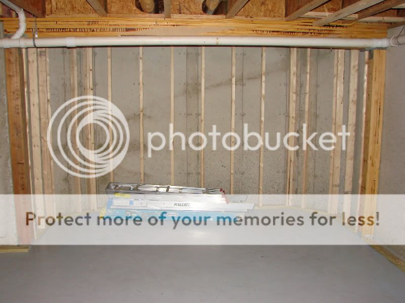

That little nook on the top left is below the bump out in the main floor kitchen. The back wall is about 10' wide, 94" high. I think it'll make a damn fine projector screen alcove. I'll be able to go dark with the paint in there, including the ceiling, and there's actually a beam (which will be boxed in) running across the top entrance to the alcove about 10" below the ceiling that gives the entire area an almost cave-like feel. Inside will be a Silver Fire 3.0 screen, three in-wall speakers, a couple can lights that will be off if the projector is on and maybe wall sconces? Not sure on that yet.
Thoughts about a screen in an area like this? Seems good to me but I'm a noob.

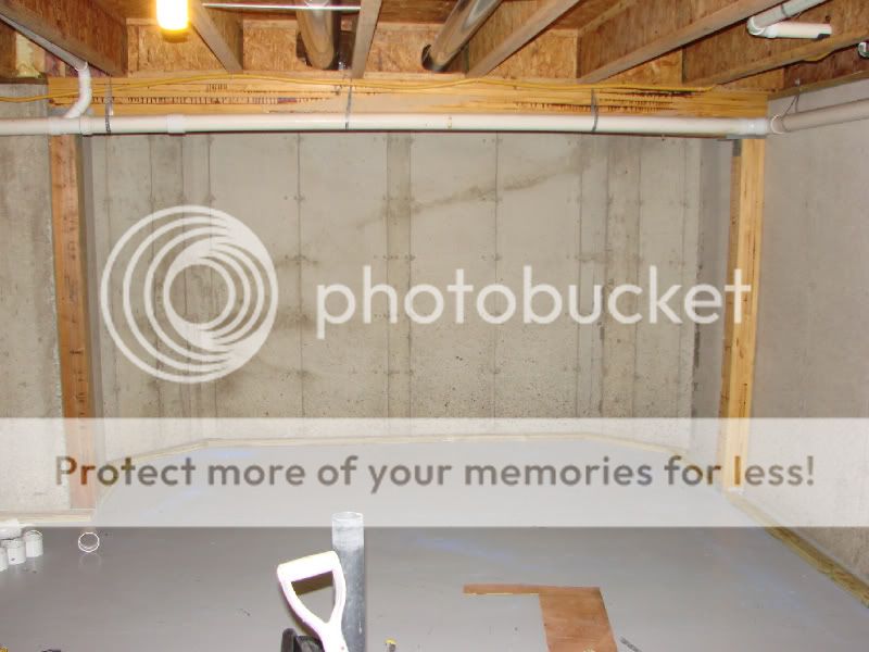

Here's a before photo from the future bathroom area back towards the alcove.

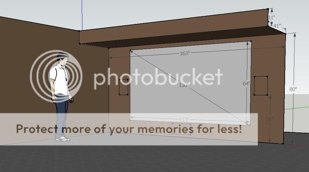

Here's a google sketchup when I had planned to put a poker table there. Well, plans can change.
I'll be ceiling-mounting an Epson 8350 somewhere between 10-12' depending on how large of a screen I go with (90"-120") after some testing later during the build process. I'm going with a sprayed on Silver Fire 3.0 screen for ambient light performance, thanks to MM for the rec. I want to make sure I have good viewability for sports etc while entertaining guests and/or poker tournaments. I think Silver Fire 3.0 coupled with careful painting in the alcove and careful lighting design can make this happen (looking for advice here as well.)

Day one: It's alive!!
Here's a direct shot of the alcove area showing the back wall and 45 degree angled walls.

Well....a raw room. That's the way I love to come at 'em!
Iffin' I was you, I'd consider painting the Screen on the long wall to the left of the rendered seating in your illustration, not the staircase wall.
Three reasons:
  1. The width of the Front/Center sound stage is MUCH more conducive to creating a epic sweep of effects than trying to jam all three speakers within that short wall. Having a Theater that is wider than deep is actually more technically correct these days with multi-channel sound.
  2. If having the potential for others to view content from the adjoining area is important, the suggested screen location would be ideal. Your Seating group could be the "Room Divider" and having a 120" will make more sense as well.
  3. Using Silver Fire w/optimal PJ mount distance will keep the image looking spectacular.
Any chance you can re-route that Drain Pipe through the Noiseless Floor Joists?
A Row of 4" Eye Ball "Can" Spots (no Floods please) situated over the Seating can help keep the Screen Wall in a darkened state.
The basic suggestions I've presented kinda jumped out at me the moment I viewed your drawings/ images. While they do not take into account issues/considerations you might have I know nothing about, ergonomically and performance wise, they utilize the available multi-purpose space to the best possible advantage.

MM, thanks for the comments!
I won't be putting the screen on the staircase wall as I had originally planned, but I'm planning to put it back in the alcove to the top right of the drawings since I think it'll offer me a few ambient light advantages, I can paint that area (including ceiling) pretty much whatever color I want and there won't be as much direct light on it from the other end of the basement. That and the boss (wife) likes it in there better as well, so there you go.

  • I'm close to deciding on a 100" screen and I can mount the PJ as close as necessary. Should I be looking at Silver Fire 4.0 for max ambient light performance, or is the screen just too big for the Epson 8350 to go that dark? I guess I'm asking, how dark can I go?
  • Is 2/3 above, 1/3 below eye level still the recommendation for screen height?
Whoa whoa whoa there. You're in a BAT CAVE and you wanna go max on the SF???? Do you plan on having spot lights on 24/7 ?!?! I'm throwing a 118 image w/ my 8350 w/ SIX windows and it's decent. I'm doing RS-Maxxmudd though and I hoping it'll be more than enough gain. I think you can cut back your SF significantly.
Also don't pre-judge your screen size. Throw an image onto an unfinished wall and mess around with your seating distance and screen size. I thought I wanted to go 100, nope, went w/ 118 instead.
Yup

And I'm w/ MM, I don't like that cubby hole angled back wall at all. 10 feet is just too tight for a big screen AND speakers.
If you're dead set on having it in that cubby hole orientation, I'd come forward (right in the pics) and hang the screen from the ceiling, but then you're wasting all the space where the wall is angled.
Red oval = screen position. Blue boxes = speakers

I hope you reconsider the Cubby Hole.
Your delegating the system to "Pocket Size", limiting your sound stage width, screen size, and basically downsizing to a point that myself....I'd find it all a bit too diminutive.
That side wall seems Ideal....so much so it's almost hard to visualize it not being the strongest consideration.
At 100" you can go for SF 4.0, but SF 3.0 should be easily enough if your lighting and PJ mounting considerations are addressed.
Think hard and carefully here. Impact...both visually and aurally WILL make or break the "OMG" factor. Don't overlook the results others have accomplished because of simple personal preferences. Of course it should be as YOU want it to be since it's your Theater, but just the same, YOU SHOULD want it to be all it can be....and more.

I'm a visual person
A) Back cubby wall
B) Foward of the cubby wall, hung from ceiling
C) North Wall
D) East Wall / Stair well wall
E) South Wall
Are you saying C or E? If that dang window wasn't there, I'd suggest E all day long.

MM is voting for C. I was thinking A, but... (Now keep in mind that I've never owned a PJ, nor watched a decent one at a friend's house, and that my only real experience with a PJ at all is at work with a piece of crap in a bright conference room.)
I turned on the Epson 8350 for the first time today. Stuck it on the bar in my kitchen and projected an HD Tivo signal over component cable onto a flat beige wall in my living room with zero light control (actually with the lights full on for a bunch of that time)
My first impression: OMFG. How did I never buy one of these until now.
I no longer have any reservation about ambient light on any wall in the basement now that I know what this thing can do.
I'm thinking wall C, widen out the left and right channels as recommended, and crank this baby out to at LEAST 120". I had it sitting at 18' throw full zoom and it still looked badass at like 180" diagonal, and it basically covered the entire living room wall floor to ceiling, wall to wall.
I'm speechless. I have to go reconsider everything now...

The only problem with wall C is that there's an access panel to a crawal space that's not on the drawing above. I'd have to mount an actual screen. I'm back to considering D. I could go 130" or a bit larger there with room for speakers, etc.

MM, thanks again for the info. I guess I'm scrapping that RG6 and I figured out a better spot for the sub.
Here's a rough sketch on the wall. 80" high to the bulk head and I can paint the "ceiling" there near the screen a darker color if needed, 163" wide wall. I mocked it up at 130" diag with fronts and center channel drawn to scale.
Is this too big, too cramped, too anything?
develvjd- is offline
post #30 of 139 Old 12-21-2010, 06:55 PM - Thread Starter
develvjd-'s Avatar
Join Date: Nov 2010
Location: Indianapolis
Posts: 113
Better photo, showing bulkhead, etc:
