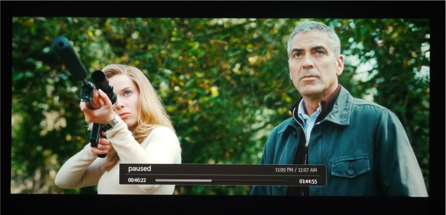

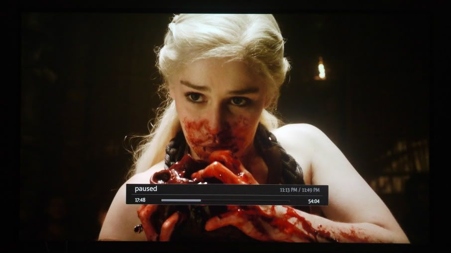

The first pic is with 1 duster.
Rest if the pics with the 2nd duster. The orange light tinted the pics so don't worry.
But the gray is right on in the last pic.
There is still a slight pink tint from the under coat from the 2 previous dusts, but that will go away.
Those pics are with the paint wet and with the camera flash.

Originally Posted by ksimm1 View Post
Satisfied DIY'er here:
(The American)
(Game of Thrones)
Thanks to the folks on this forum for being such a fantastic resource.
Specs on the Setup:
Paint mix: SF V.2 4.0 (Behr UPW version)
PJ: Panny AE4000U
Screen Substrate: Sintra 3mm 5x10 cut to 104" 16:9 diagonal
Throw Distance: 10' 3"
Viewing Distance: 9' 5"
Paint Sprayer: Graco no-name from gleem
Surrounding walls are all bright white w/ ambient light (hence the need for 4.0 version)
Wanted to also add a few observations for other future noobs:
This was only my second time painting something and I have to admit that the idea of using a paint sprayer at first seemed like overkill. But the resulting smoothness of the screen was pretty astounding. I can't really imagine rolling coming close to this finish. For a modest invesment of 50 bucks, the paint sprayer actually made things significantly easier.
Because I did this in a small apartment I was really concerned about overspray. It turns out that the Graco "no name" does a really good job of minimizing it. No paint dust on my clothes and no paint even a foot back from the screen. I'm sure a lot of this will depend on your environment and having proper paint viscosity though.
The paint mixer drill attachment is an absolute must. I don't think that was clear enough in the Beginners guide. No way I'd be able to mix thoroughly with a wooden paint stick.
Those of you in apartments who can't drill into your walls--turns out the 3M Command Large adhesive strips for picture hanging actually work quite well with the Sintra. The 3mm screen itself is at most 15-20 pounds, and I was able to get a secure grip with only 5 pairs of the adhesive. If you're planning a heavy frame though, I'd advise against it.
I'll edit this post if I think of other tips.
