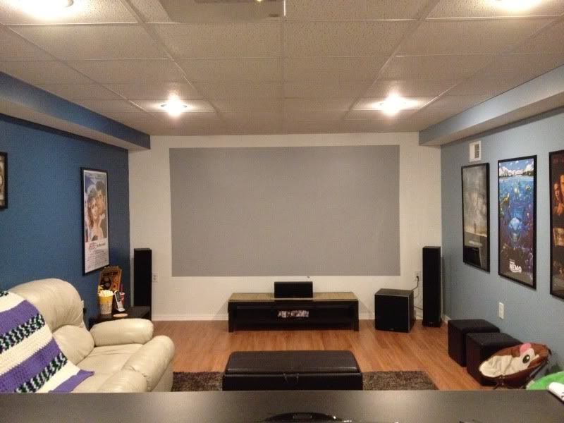

First off...this forum is the BEST! I think I could spend the next year reading stuff on here and never grow tired of it. Now that the brown-nosing is out of the way...
I'm just getting started on my basement room...currently have a 50" pani plasma but talked the wife into "letting" me get a projector. I ordered an Epson 8350 a few days ago so it should be here by the weekend with any luck. I'm wanting to do a Silver Fire screen on Sintra/Komatex board but I don't know what size I'm going for yet. Even though I am scared out of my mind to spray it, I'm going to. Since this is my first projector I wanted to project it on the wall first and watch a few things, just to get an idea of what a comfortable size would be. It's a lookout basement with a deck over the windows, so there's not a ton of ambient light (see pic below). I included some measurements in the pix below too, except for the fact that my seating is approx 11' from the wall with room to move back up to 1 foot if needed. My questions are these...
1: Given the prj I will have and the amount of ambient light in the room (I don't use the can lights very often at all), what version of SF v2.5 should I use? I was thinking 3 but no clue really.
2: Shown in the pic below, I plan on putting the prj on a shelf instead of ceiling mounting it, but it would be about 16" off center...I would make use of the nice lens shift feature on the epson. Would the SF screen respond well to that or would I be way better off ceiling mounting it centered horizontally with the screen.
3: As you can see, my screen-wall has what I like to call "the stupid shelf" on it. The builder framed in the top portion above the foundation and then framed in the foundation afterwards, so the lower part of the wall is 7" out from the top part (all my measurements are taken from the lower part of the wall.). Is it stupid for me to think I can "rig" something up with a frame and the Sintra board without having to frame in the top part and extend the wall up to the ceiling? I guess I'm just looking for suggestions.
Sorry for the long post, and thanks in advance for any comments!

jschuetz,
First off, I'm sure I speak for all DIY Screen contributors when I say we thank you for your compliments. On this Forum, we try our best to address the widest range of possible questions regarding PJ selection and installation / Screens choice, and Theater design. In truth, all the aforementioned are governing factors in determining "Best Case" scenarios. Or even, "I gotta do the best I can..." kinda get-bys.
To that effect, sometimes the advice you receive runs counter to what is expected. But it's "all Good' because it comes for much experience, not a few decidedly different examples.
Answers to your listed posers.
1. SF 2.5 3.0 us a excellent choice. With reservations. (see question 2.)
2. 16" off center translates to being "very off center" as relates to the amount of Lens shift needed to correct such. There are two very good reasons to commit to a Inverted Ceiling mount.
A. Ceiling mounting will allow a "centered" approach, virtually eliminating the need for excessive Lens shift, which can reduce Lumen output, create image distortion, and limit "vertical Lens shift ability...of which you will also need a maximum of travel if you Shelf mount the PJ and needs must lower the image to a great degree. Take my word on this...it's a given.
B. You can move the PJ closer to within 10% of the minimum allowable Throw distance for the given Screen size...allowing you to optimize lumen output, and turn the PJ on Low Lamp mode for better Blacks and longer Lamp life.
If you simply must mount the PJ "away back there" then do so on a Shelf that protrudes out from the Corner "sideways". You could even make it be a high shelf you could then suspend a ceiling Mount from and invert the PJ.
3.You can do it. There won't be that much Screen needing support, and really, a simple 1 x 4 Poplar "Box" Frame directly behind the raised area will suffice if the Sintra itself is adhered to the bottom wall.

Here's some screenshots of my Epson 705HD with SF 2.5 2.0. Not the greatest camera, so it's not totally accurate.
