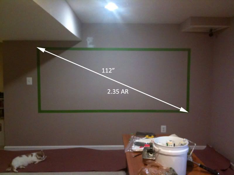

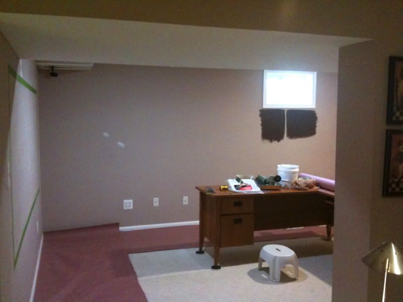

I need to move the bottom tape down 1 inch, miss-measured, it's 2.39 if I leave it and going for 2.35 (most current movies seem to be 2.35 from the quick IMDB search I did of movies I like/have).
If I had an electrician move the light switch I think I could have done a 120" but this is a quick and easy theater space. I'll go something bigger and nicer in a couple of years. Of course I can always make it bigger later, just paint right.

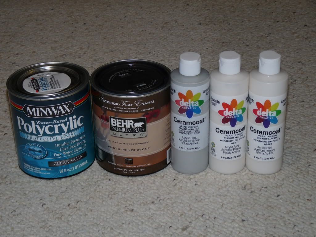

I picked up the Behr UPW its code 1750 at home depot, mixer, rollers, primer and the poly. Just need to head to Michaels tomorrow and get the craft paint.
Going to paint the room first then the screen. The tape is allowing a 1 inch overlap of the border so once I move the bottom tape line down an inch, paint the room and remove the tape the resulting “hole” will be the screen with a 1 inch bleed. I’ll then tape within the frame border and roll the primer 2x then screen paint 2-3x.
I think I’m going to have to go with Satin on the walls as Sherwin-Williams doesn’t list eggshell (I prefer SW paint). Flat is just going to get smudged up by my kids regardless of what I do. Thinking “French Roast”, my wife thinks it’s way too dark so then it must be a good color.
Sorry for the crappy phone pic, I’ll take better ones this weekend/week
Wall color, oddly enough the two samples I picked are practically identical:

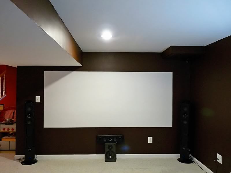

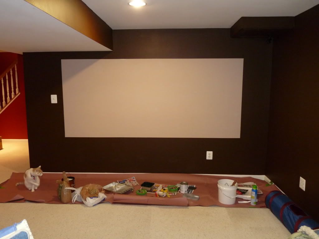

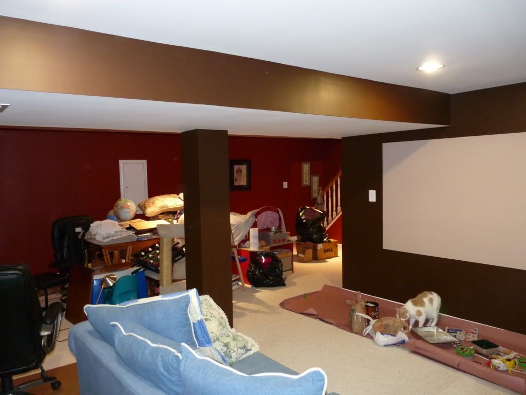

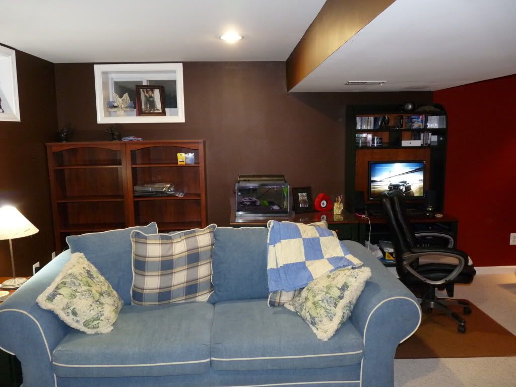

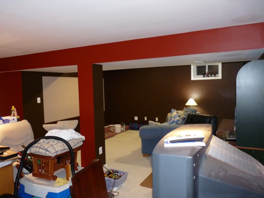

Work has be proceeding, I'll take pictures tonight and upload them. I painted the Theater room and moved some furniture into it. My wife sees how nice it looks and suggests I paint the rest of the basement and stairs. It needed to be painted but that pushed me back. Now after mudding, sanding, priming and one coat on the rest of the basement brings me to where I am now. I'll probably need to take a day this week or early next week to finish as it's about 6 hours worth of painting with the stairwell (I hate painting stairwells).
Anyway after doing more reading and using projector central's calculator I find my screened off area will need to come down some. The drop on the HD66 is 14 for my 2.35 screen (112 diag, 103 wide by 44 tall), figure 2 to the center of the lens as it's a 3.9 high unit and my mount is 5.5 gives me an overall drop of 21.5 inches. So I need to move my screen down about 3-4 inches (I had planned to leave a one inch bleed/overlay for the screen frame so my screen was supposed to be 17.5 inches down.
Also according to projector central I have a range of 14' 7 to 13' 4 (the furthest it can be is 14'). So I'm going to find the rafter inside that range, put the mount on the projector and center it on the screen (level of course). Then I'll hook it up and project a 2.35 movie still on it and use it to mark my screen boundary again. Getting it exactly center is going to take a lot of measuring I'm thinking. Once I tape it off again with my level I'll sand it again to be doubly sure it's smooth (this was one of the better walls in the basement) and put two coats of primer as I'm going to need to cover up 3-4 inches of a very dark brown paint.
When I take my pictures tonight I'll take pics of my screen ingredients so you can see if I got the right stuff.
I want to see how bad the reflections are on the soffit to the left, I'm expecting it to be noticeable. I'm thinking I'll take some black paper/board I have and tape it up so I and my wife can see the difference. If it's significant (which I'm sure it will be) then I can persuade her to let me at least paint the soffit black. I'll have 21-22 from the main part of the ceiling so I hope that won't be as noticeable. I guess it would look odd to just paint 3'-4' of it?

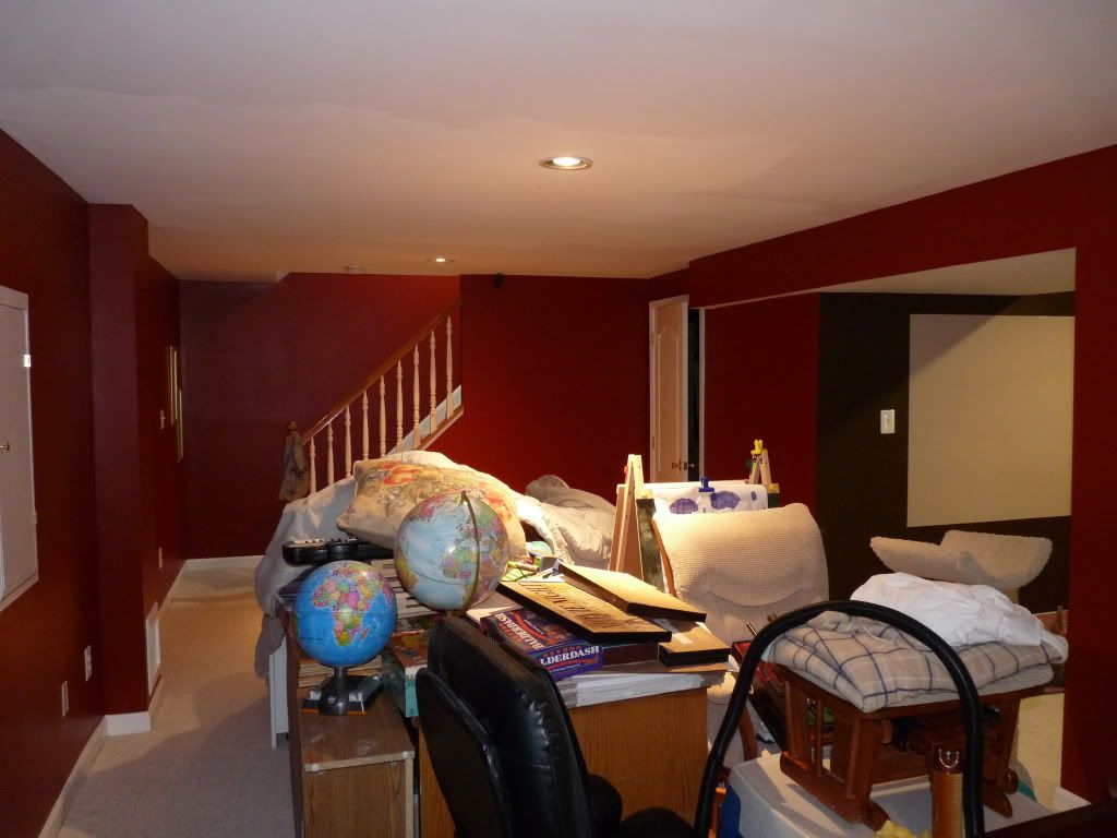

Anyway I was able to finish painting the walls of the basement and took a few pics. First are my ingredients for the screen. I went to Michaels yesterday and the only Liguitex paint they had were small 2oz bottles for $10 each, I took a pic from my phone which I'll post later today. Neither was a ceramcoat so I didn't buy it.
These are the ingredients I have now
Hopefully I have the right stuff although it looks like painting the screen will be near the end of the build.
Next I have some carpet shampooing to do so I can move all the furniture back. Some shots below show what I have so far (again this is an on the cheap build until I can do something nicer):
Screen wall (2.35, 112, will be moved down about 4 and plates painted the wall color)
Back wall (fish tank and desk it's on will move to the right of the computer hutch. AV rack will go in its place)
Looking out to the rest of the basement (kids area)
Looking into the Theater area (figure I can put 3 movie posters in there)
Kids area/stairs (ceiling and trim still need to be repainted but good enough for now)

that should work just fine...
you were probably looking at the liquitex full bodied acrylics instead of the basics.
as for the delta... delta has dropped the 'ceramcoat' name from their new lineup and it's just now calling it 'metallic silver' or 'pearl finish'
pb_maxxx is offline

Looks like I'll have to make some adjustments to the size of the screen. I didn't really think it through and with this level of projector a 2.35 screen isn't going to work. Not sure why I didn't think of this before but since the HD66 and similar DLP projectors don't have much in the way of zoom I need to decide on a 16:9 screen size and my 2.35 will just be the same width but shorter.
The max height-wise I can do is probably 48-50 inches (soffit is 12 down and outlet is 18 off the floor and figure 7 for a border leaves a max of 51) so I'll need to mount the PJ about 12' back. I think I'll get some 1x10 or 1x12 and screw that into two rafters so I can place the PJ anywhere within 12-18. I'll also need some 1.5 gas pipe as the drop will only be 6 instead of 14.

Well I adjusted the screen for a 16:9, 100 and centered it in the wall. Take a guess what was smack dab in the middle of my throw range?
So I can either have an electrician come in and move the lights and do more drywall repair, offset the screen 1-2 feet to the right, or just get a better PJ. I'm part of the instant gratification generation so I'll likely be ordering a Panasonic AE4000 in the next couple of days. The throw would be about 13' 6 and I think I can squeeze out a 116 2.35 screen leaving me with 92 16:9.
I'm allowing 7 for the screen frame, going to pick up some of the MDF from the depot, move one of my speakers to where it would go and then project up an image and just make it as big as I can.

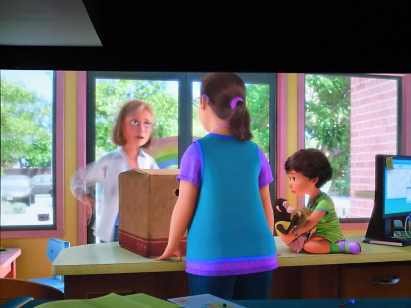

I’ll take some more photos this weekend I’m sure but I think it turned out pretty good. The speaker under the center channel is from a crappy HTIB I bought 10 years ago, just using it as a stand for now.
My first attempt at a screenshot, forgot to pause the movie so it’s a tad blurry.
Not sure why but I was expecting a more gray screen, the pearl and silver didn't seem to darken the UPW all that much.
Having nothing to compare it to it looks great to me.
yep. when it comes to titanium oxide... there a sayin... "it do's what it do baby"
and yes your screen is a little more white then a full blown MaxxMudd LL... but you'd be amazed, i hear the same thing said over and over again about it.
everyone's expecting a GREY screen... no matter how many times i repeat, it's a silver-white screen... and it's really MEANT for dedicated viewing... without wanting to pitch a beer in the direction of someone who accidently turned on the lights.
your pic... while in-motion... looks very good. it has a very 3D feel to it...from foreground to background. i especially like the black level detail of deep brown modelation and detail of the mother's hair and the little boy's hair. a lot of that can get lost with darker grey screens.
