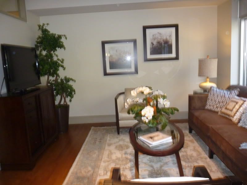

The biggest issue to face as far as incandesent light is to arrand it directionally so the no "directed light" washes across the screen area. Spots in Can Lights...or combined with Eye Ball or Wall Wash shield, are often all that's needed to alter.
Sunlight? Might be something else altogether if the Lady says the Curtains MUST stay opened.
Silver Fire v.2 5.0 would be the route to go in worst case situations as the latter described...but the 8350 will lack horsepower.
The amount of lighting shown, if it remains as is, is akin to a well lit commercial establishment...or Office. To achieve really good imagery in those conditions, you have to use a 1080 p unit with at least 3K lumens.
They exist, and don't cost a huge bundle, but they don't have near the contrast of the Epson because they have such bright output.
But that's OK because the considerably darker SF formula will greatly enhance the PJs contrast as perceived coming off the screen.

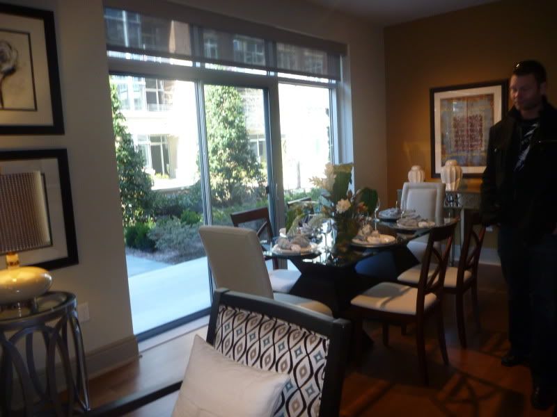

Thanks for the prompt responses guys... the slider on the right of the first picture walks out to a nice courtyard and that entire side of the apartment faces NW so any afternoon sun that comes in isn't pointing to the wall where the screen would be which is nice... but its obviously not the most desirable lighting situation. When watching TV, movies etc. we'll have almost all the lights out so i'm not worried about the lighting aspect... im just most worried about how its going to perform during the daytime when the shades are down but the sun is bright... with that said, is the 8350 still a solid performer in this price range? i want to do the entire project (PJ, screen, cables etc.) for under $1500

Here's a few day time shots for additional context

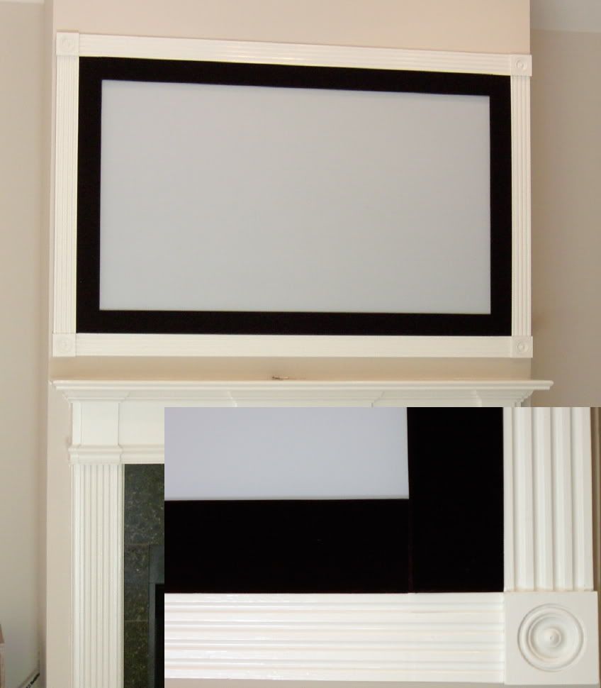

Screen attaches to wall via 10 Drywall screws applied through the extra area around the Screen's actual 45" x 80" viewing area The utility area is then faced w 2.5" velvet wrapped trim, or a thinner trim surrounded with White Wood Trim with Detail.
The latter would be in keeping with the nice Decor. Below is a White & Black Velvet example involving a similar installation to yours, same size...but over a fireplace.
Also one with "Wood & Velvet" but with "Piano Black" perimeter Wood Trim & Velvet Wrapped Corner Buttons with Gold Detail.
