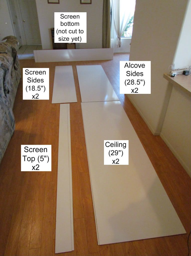

I went to Home Depot on Saturday and they cut all the boards on the long side for me. I've worked with a very patient friend pretty much around the clock since Saturday afternoon cutting the short sides to fit and wrapping/stapling the velvet.
I am 90% done. It took a long time to wrap and staple all the pieces. There are 10 in total. Only the bottom 2 remain. Out of 12 yards of velvet I will have about 4 inches left (whew ). I rented a Paslode nail gun and that really helped (especially for the 2 ceiling pieces). I had to return it at close of business Sunday and I just made it!
Here's the picture of the cut pieces as I got them from HD before I made the final cuts. I will post the finished pictures after I get the final 2 boards and the high surround speakers installed tomorrow night.

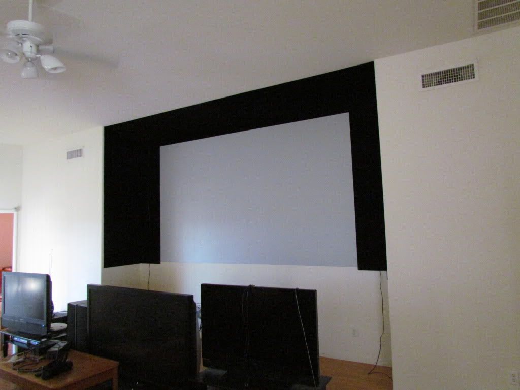

My normal job is keeping me busy so no time to finish up yesterday. Here's a quick status.
I just need to get the two bottom boards cut to 63.5" x 5 3/4" wrapped and mounted. After that the screen is exactly 127" x 71" (146" diagonal). I measured several times to be sure the frame was 16 x 9. I also checked with the projector on and I have just a tad of light hitting the edges of the black velvet all around (and hitting a straight edge 5 3/4" up from the bottom). Looking pretty good.
Still have to mount my black high surround speakers in the alcove upper corners on velvet side panels. The alcove board lengths are perfect and they stop just as the curve out of the alcove begins. The corners at the front ceiling of the alcove are also perfect! It's pretty hard to see all the corners now due to the darkness of the velvet. This angled shot shows it best. I'll shoot some close-ups later.

Here's the same angle before the screen.

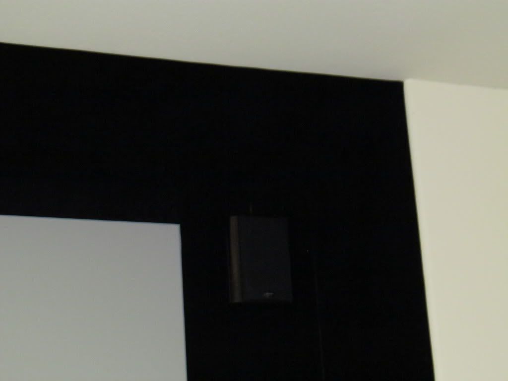

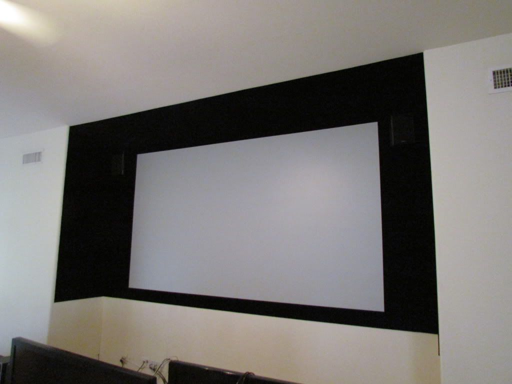

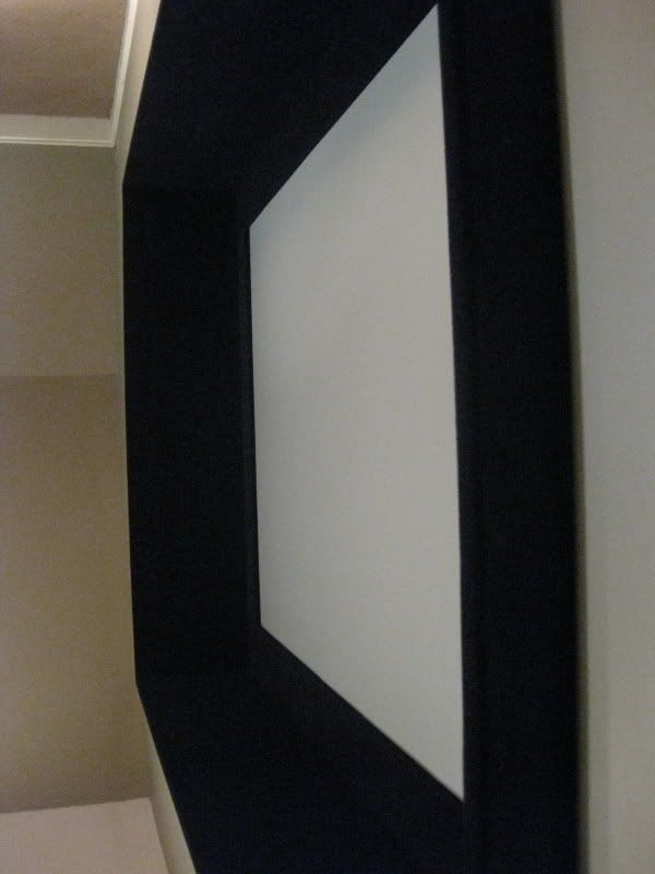

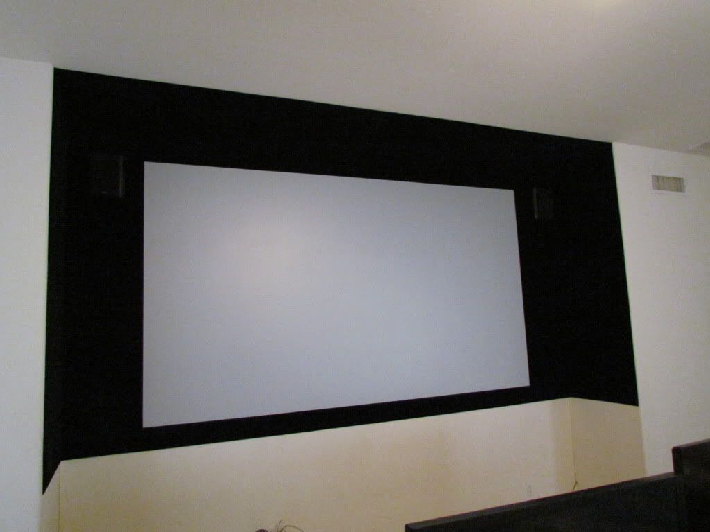

post #39 of 53 Old 09-30-2011, 07:52 PM - Thread Starter
mostau's Avatar
Join Date: Apr 2003
Posts: 224

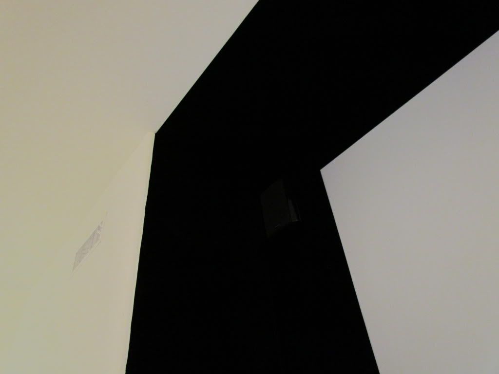

Here's the pictures of the finished screen.
If you look closely you can barely see the high surround speakers on the sides flush with the top of the screen.
All the lines and corners are straight so I am pretty happy
I still have to get the 3 other TV's moved back. Totally rewiring the AV so it will take a bit. Will post the final, final pictures then.
Screen from right side...
Close-up of right corner (a little out of focus, sorry )...
Screen from left side...
Close-up of left corner...
mostau is offline

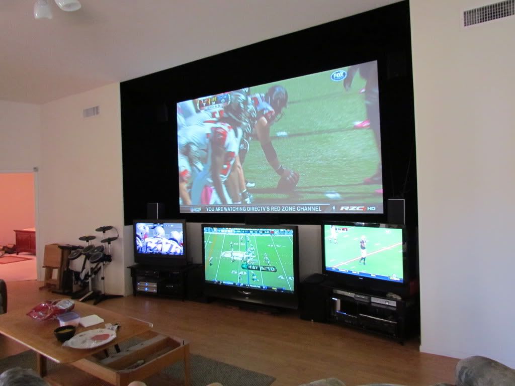

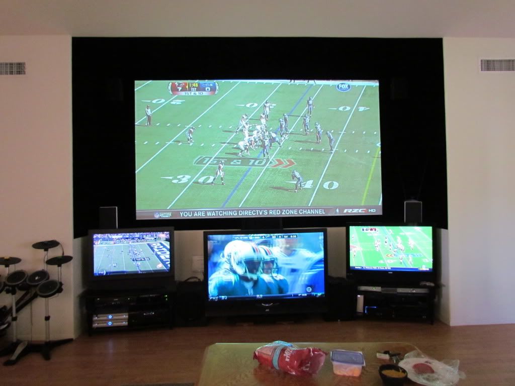

post #40 of 53 Old 10-02-2011, 02:36 PM - Thread Starter
mostau's Avatar
Join Date: Apr 2003
Posts: 224

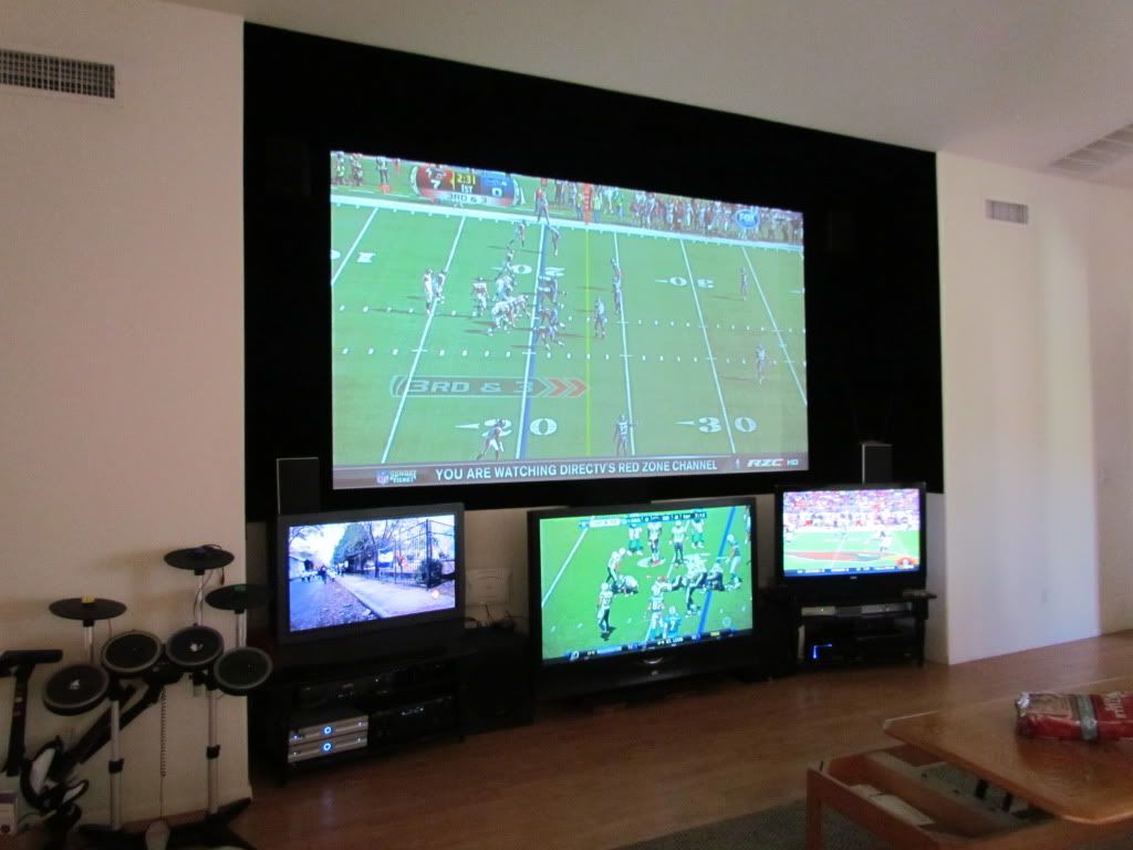

And we have football!
Still need to replace the tower speakers on the right an left, but other than that I am finished.
MississippiMan,
Thanks for all the help. Absolutely could not have done it without you. I kicked back a beer in your honor at Pappadeaux with my buddy
All of the shots were taken in the middle of the day with lot's of Arizona ambient light.
Finished room from the left...
Finished room from the center...
Finished room from the right...
mostau is offline

These pictures were all taken today at about 12:30 PM in the afternoon (a partly cloudy Phoenix day, but still plenty bright).
