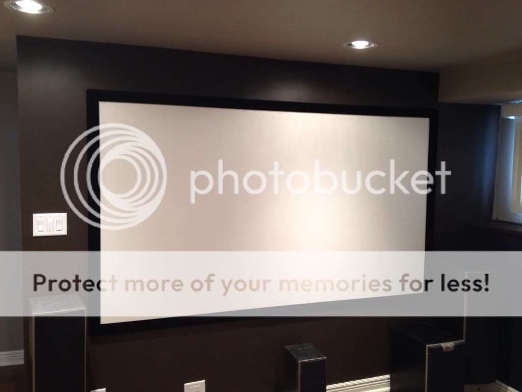

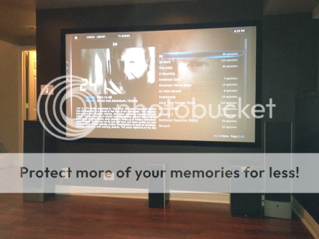

So from the advice in this thread, I built a screen from this material. I used one of the boards from Menards and cut the width down so that I had an inch or two extra on each side. I bought some metal clips used to wall mount mirrors, spray painted them white, and used them to mount the board to the wall. I tried using one clip at each corner, but the middle bowed out a bit, so I decided to go with 4 each on the top/bottom. When the projector is on, you have to purposely look for the clips to notice them. This worked out great allowing me to not sacrifice any height by using screws through the screen.
The border was some cheap ranch style casing from Menards, covered with velvet. I mitered the casing corners and cut it to length. My girlfriend bought the velvet so I have no details on it, I just know it wound up in the $10-$20 range. She wrapped the casing and stapled it on the back. I mounted it to the wall by shooting finish nails through it with my nail gun.
All in all, it turned out looking very nice and was very inexpensive.
