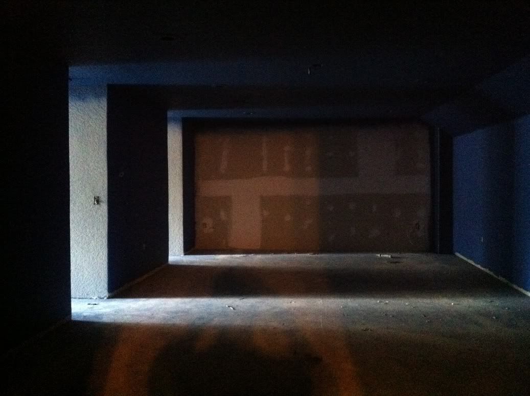

I am almost finished building my theater (see picture below). The room is 32x16. I will be running an Epson 3010 with a Mudmaxx 2.1 Retro (~1.4G)
Using the full zoom and hanging 5" from the ceiling
Option 1:
I can set he PJ back 17ft and able to obtain a 160" screen
Option 2:
I can set the PJ back 15 ft and able to obtain a 144" screen
Epson 3010

post #4 of 13 Old 02-08-2012, 08:45 PM - Thread Starter
Indpowr's Avatar
Join Date: Oct 2009
Posts: 53
Anyone had any advice tonight since I have to buy a 25ft hdmi 1.4 and overnight it if I were to do 17ft.
Epson 3010
B&W Center
M&K S125 R&L
B&W side channels
Triad Rear channels
Klipsch Reference RW-12d
M&k 10" sub
Onkyo 7.2 THX Receiver
Indpowr is offline
post #5 of 13 Old 02-08-2012, 08:48 PM
Brad Horstkotte's Avatar
Location: Torrance, CA
Posts: 5,197
Liked: 68
What seating distance(s)? My front row is 12 feet from a 136" wide 2.35 screen, pretty immersive, and the way I like it.
Brad Horstkotte is offline
post #6 of 13 Old 02-08-2012, 09:07 PM - Thread Starter
Indpowr's Avatar
Join Date: Oct 2009
Posts: 53
Seating will be 13ft away

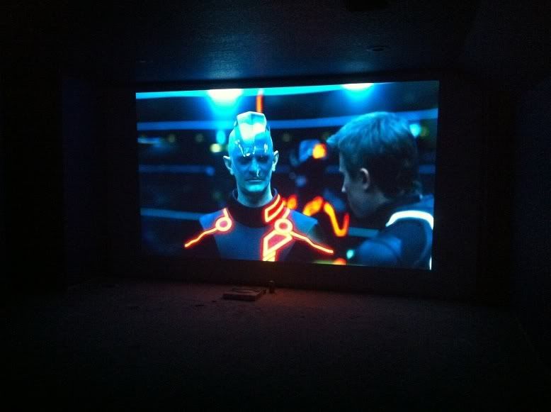

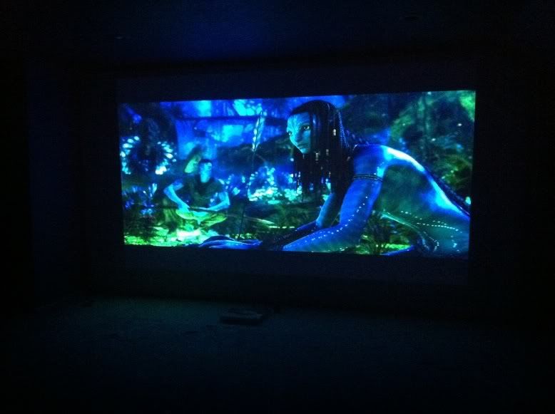

post #13 of 13 Old 02-20-2012, 02:58 PM - Thread Starter
Indpowr's Avatar
Join Date: Oct 2009
Posts: 53
Thanks for the advice both of you...
I am going to be sticking with the 3010 since the wife about killed me getting that and spending the money. I just bought a Panny VT65 about 8 months ago so she was not looking at a new TV for a while...
I want the largest screen possible. but, still keeping it clean not grainy.
Here is a crappy picture on the primered wall to give you an idea on size that I am shooting for. Keep in mind the projector was placed on the floor in these photos vs. ceiling mount when completed. * Tron was in 3D mode so that will not be as clear.
2.35 I think
16.9 in 3D so pardon the not as clear image
