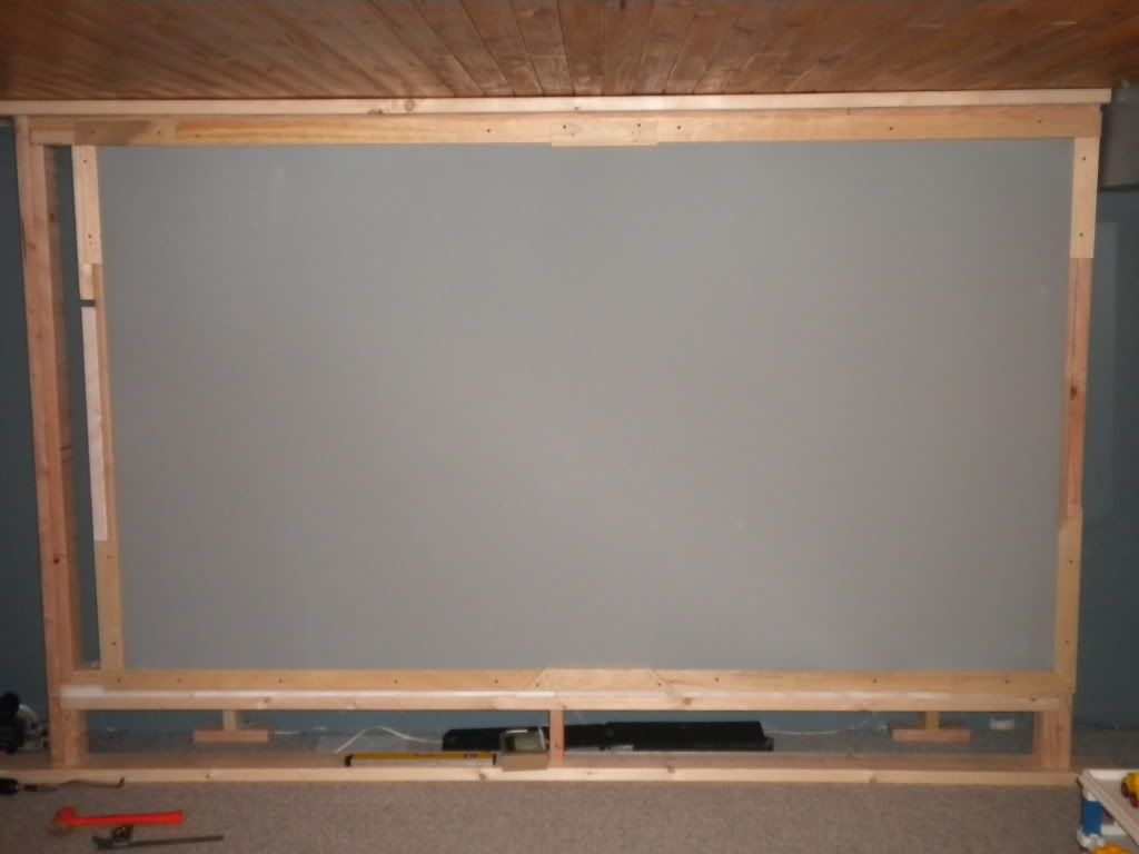

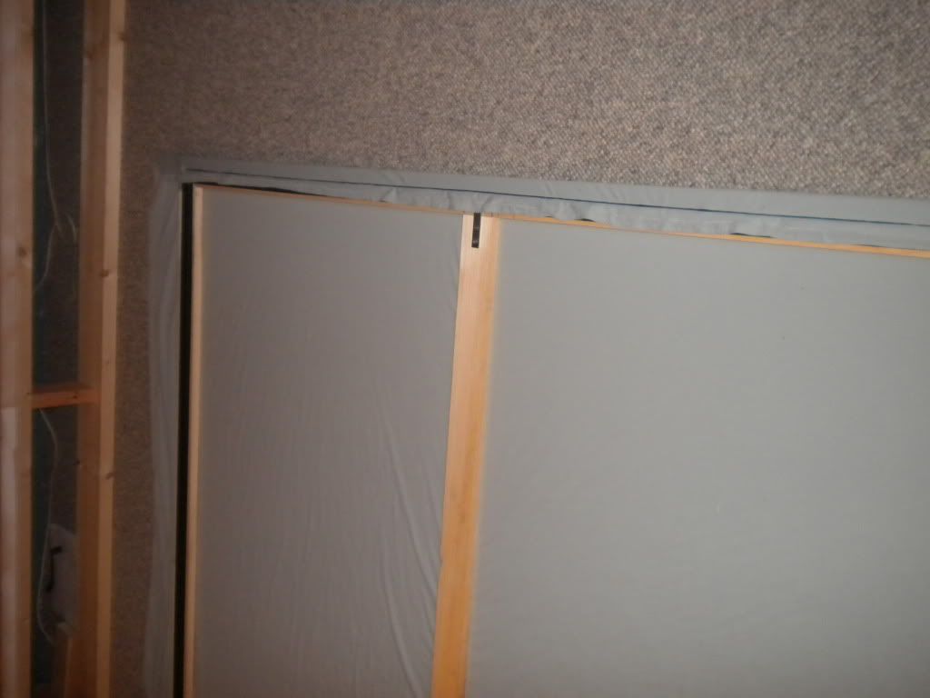

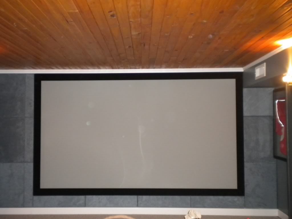

Here are some pictures of my screen, 16:9 101" x 57", project using the Moleskin matte silver and the Screen tight hardware.
I need to add some black spandex behind the silver to hide the frame supports which are visible when the lights are on. They weren't visible with the movie projected.

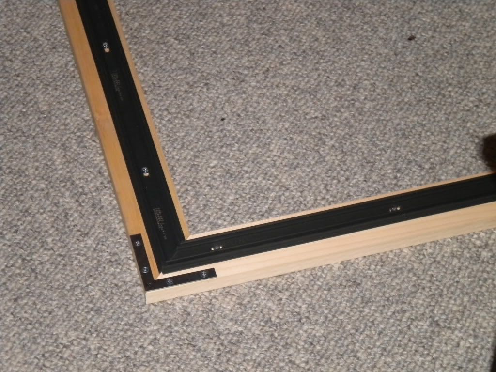

I'm thinking about skipping the hardware and just routing a groove in the frame and using spline directly in the wood. And yeah, bummed about the receiver, but good news... after it was running for around an hour, the picture finally came on. Must be some solder problems. I'll probably replace it anyway, but it may be a couple months before I can swing it.
So, back to the spandex... the "moleskin silver" I linked is 87% nylon, 13% spandex. The local stuff is 80/20. It also did not list a weight, and it's just called "matte silver". Not much to go on. Will pretty much any silver do or are we getting into specifically tested material here and any variance may end in disaster? I guess I could just drop the $40 and stop whining, but.... it's $40!

I put black spandex behind the silver and now the frame supports are no longer visible when the lights are on. I stapled the black on to the frame and the staples seem to be holding the material fine.

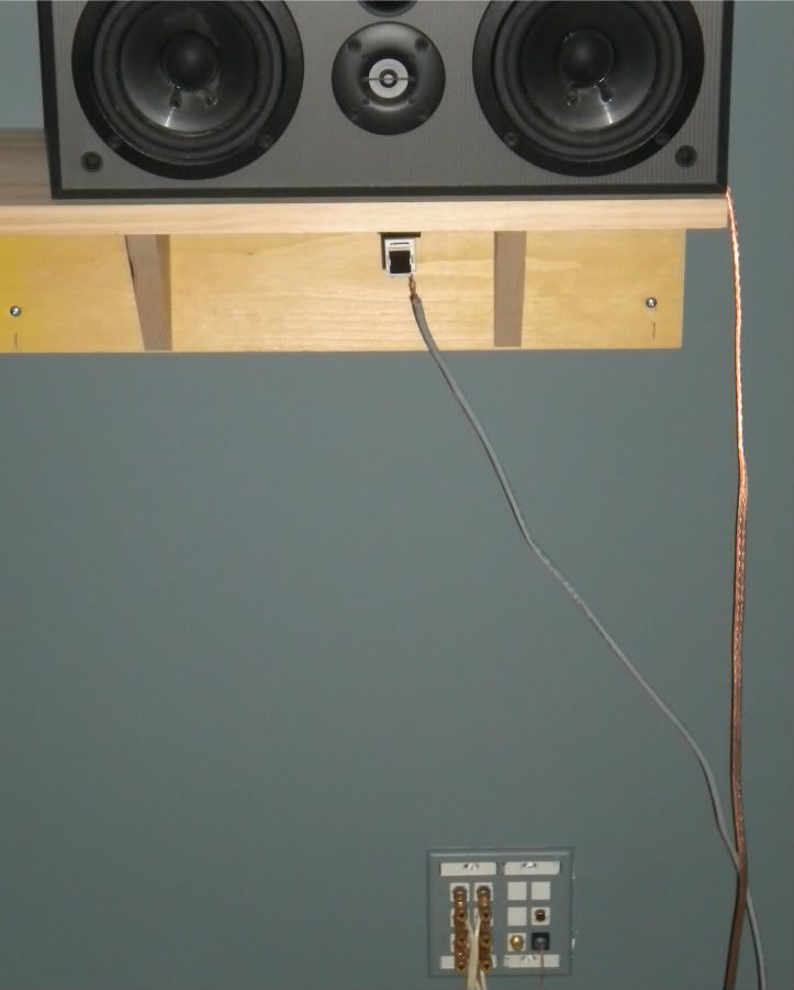

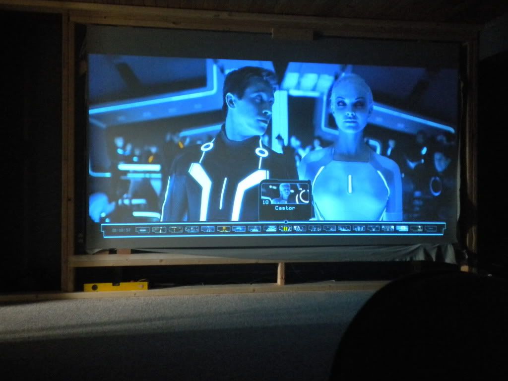

I mounted my IR receiver behind the screen. Everything works great right through the screen.

I've been too busy working on it to watch much. Images seem better than on my BOC. Now I had the projector zoom maxed out on the BOC and now I'm at about 1/2 way after moving the projector back three feet. I also increased my screen size. I watched 'Survivor' on it last night and it looked really good. I want to get the wall done before I start fine tuning things. I'll be sure to keep this thread updated.

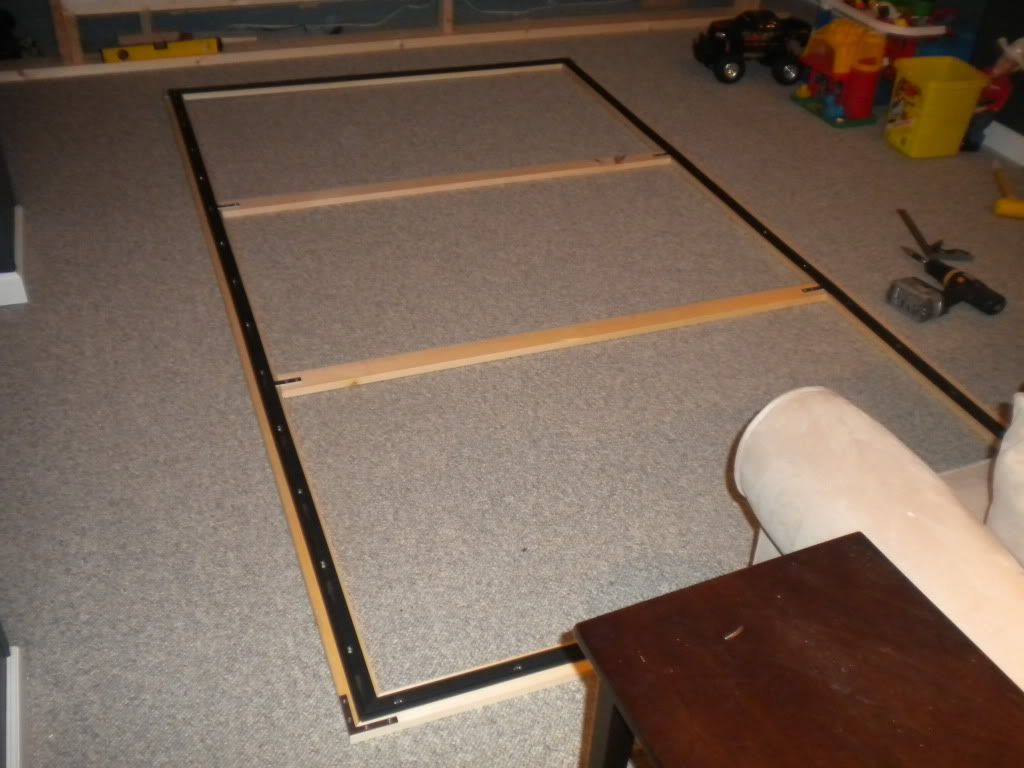

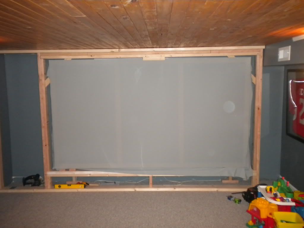

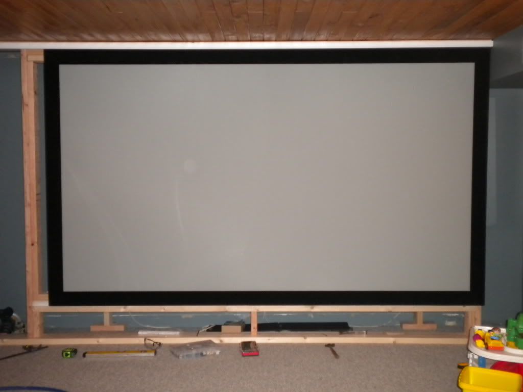

Update from me now... I built the screen out of 1x4 lumber, routed two channels in the back, used butt joins with a biscuit joiner, glued it, clamped it, and squared it up. Got my shipment from Spandex world and I have the black attached and just finishing up on the silver. I need more spline, so I'm off to Home Depot in a few minutes. The corners are a bit hard to get tight, but I'm going to overlap black velvet frame by an inch or two onto the screen surface. It's sitting at 118" diagonal right now. If I overlap the frame by 1.5" all the way around that leaves me with 115", which is just about perfect according to THX... I think.
It'll be kind of useless as an AT screen for a while. I don't plan on renovating the screen wall until after Canadian Football season is done in November. Then it's framing and speaker building. Now I gotta search thru threads and see what MM recommneded for trim for the final frame.

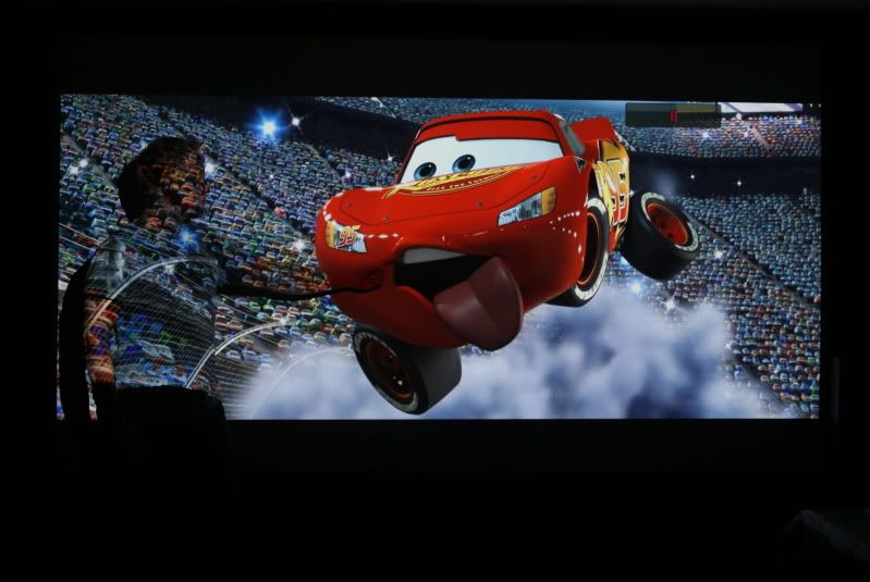

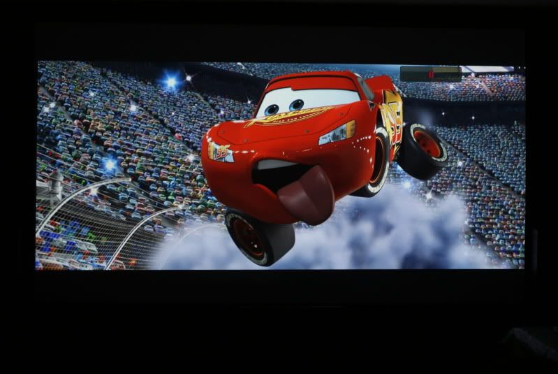

As promised, a couple screenies:
Gotta love Pixar!
And with me in the frame.

That looks really nice. I played some scenes from "The Incredibles" and it almost looked 3d on the screen. Glad it worked out for you.
My screen wall is almost finished. Watched Toy Story 3 yesterday with the kids, it look awesome. I'll start taking and posting some screen shots.
