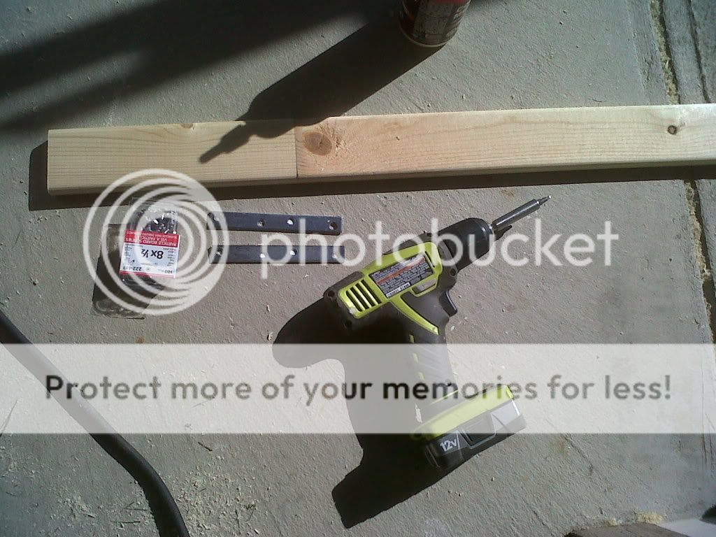

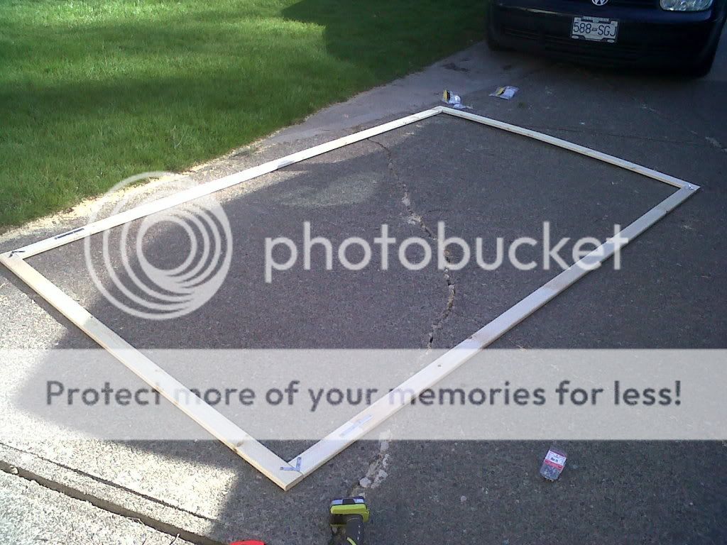

Materials bought. Wood, screws, L and T-brackets, glue, molding...less than $25:
Vertical bracers cut (65"):

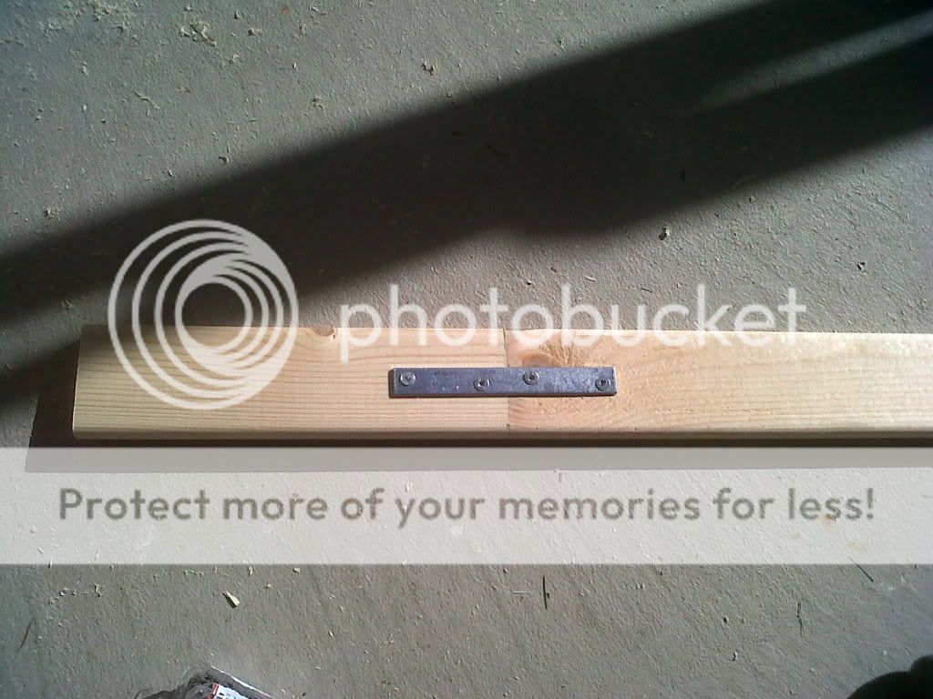

Because the screen is 122" I needed longer wood (ha!). Being the cheapo that I am, I ended up just splicing the extra length onto a standard 1x3x8' piece.

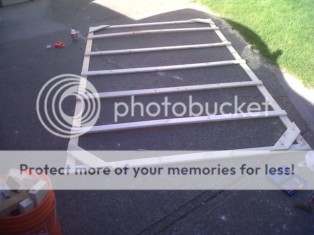

The outside frame assembled. Right side had a bow in it....fixed it in the next step.

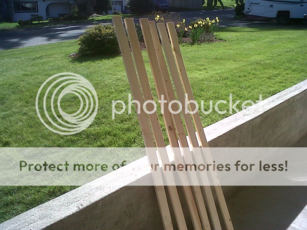

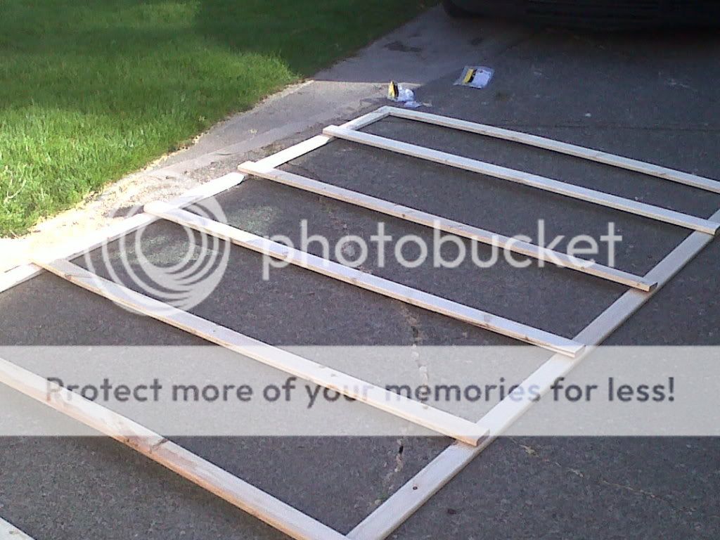

Vertical bracers fitted into place but not secured:

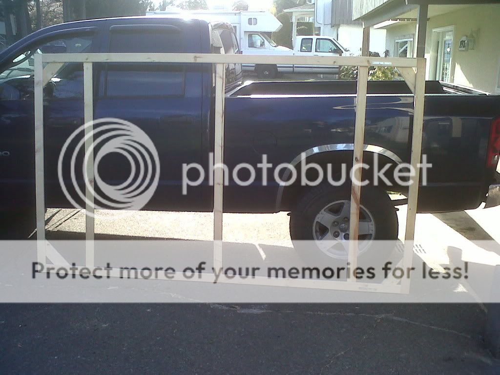

Corner brackets glued and screwed into place:
Pic for scale. Should be a beaut! Sintra sign board ordered (5x10' piece), velvet coming in Tuesday, and paint being mixed on Wednesday. Should be up in time for hockey playoffs! Then the hard work begins!

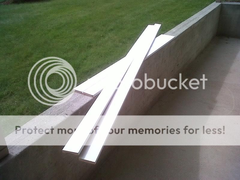

Molding for the border. 1x4. I always go molding for the borders because its straighter than regular lumber, so no matter what you did for the frame or screen, a perfectly square border will frame your image perfectly, everytime:
