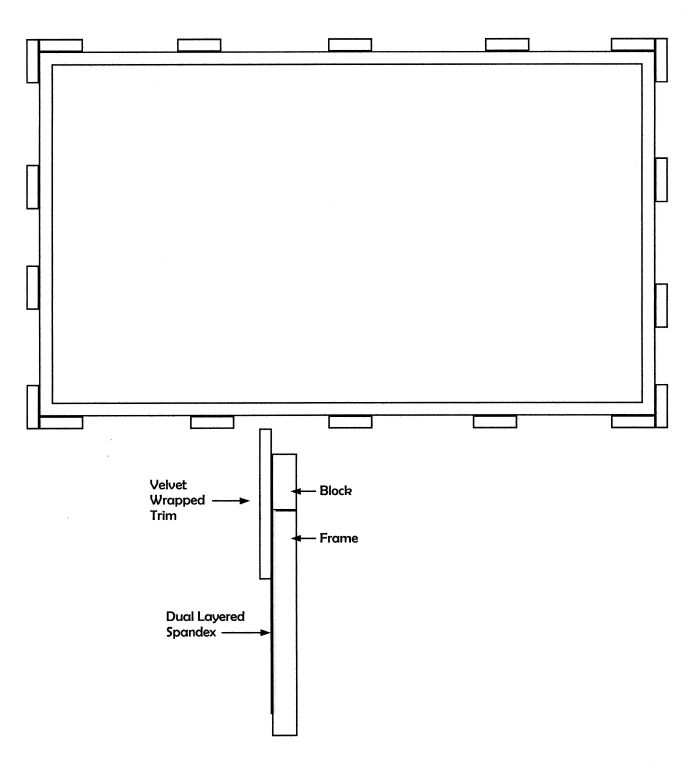

Bumping this thread back up since we FINALLY closed on the house and moved in (or should I say cohabitating with dozens of boxes at this point...).
I did take the time to put the PA70G up in the media room and get an idea of the size I'd like, and I actually ended up liking a screen in the 110-112" range. I've got two Acoustech HT-75 floorstanding speakers, so that kills some of the 10'1" wide wall I've got to work with, and I found the screen reflections on the walls getting much worse as I started going up on size beyond about 112" diagonal. I will say the brightness of the PA70G is actually not bad on just a builder-biege textured wall. The settings need to be boosted a bit since it's probably in the 0.8-0.9 gain range with lots of light scatter, but it's definitely watchable - so it can only get better from here!
So thoughts on materials?
Sintra sounds nice, but it seems spandex is garnering more of a following for a general DIY type budget screen.
I'd like brightness, but the blacks of the PA70G aren't exactly stellar to begin with (15,000:1 contrast must be measured with cranking all settings to max to take the white measurement, then killing all settings to take the black measurement... hah). So does that call for Silver over White spandex, or White over Silver?
Painting drywall isn't a go since my instructions on where to place the speaker wire box wasn't exactly followed , so one box is just inside the screen area by about 4-5" on one side. So definitely need something to hang. Doesn't need to be particularly lightweight, but 1x4's and a french cleat or two sounds like the easiest way to go. I would also like WIDE border trim, since this is actually a 16:10 PJ that will be used as a 16:9 setup, so the top and bottom black bars are a hair over 3". I suppose 3.5" would work, but I'd hate to have some light spill.
So painted sintra (or other substrate) or spandex?

So spandex is <1.0 gain due to the open structure of the fabric, even with 2 layers? Interesting, I don't think I've seen that mentioned in the dozen+ threads I read on it.
Anybody have any good sources for 5x10 Sintra/Expanded PVC Foam in Houston? I really wish there was a cheaper solution for a substrate for >98" screens. The Sintra gets kinda pricey in 5x10' at most places I've been able to find.
