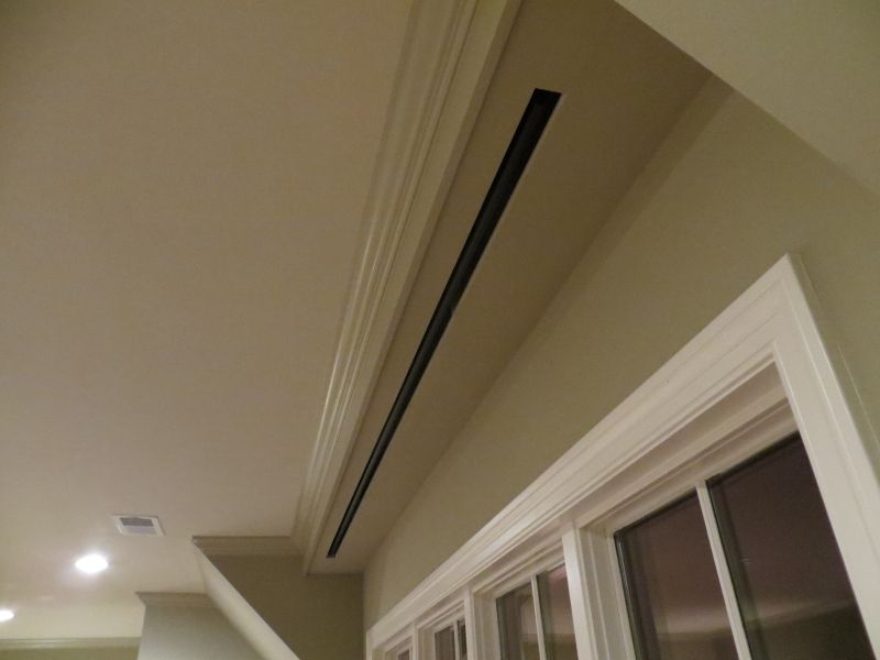

OK...vacation is over. Let's get'ter dun!
Here are some images of the screen
Front
Side
Up inside the Custom made Slotted Inclosue
Down through the Slot.
Now to go paint the darn thing!

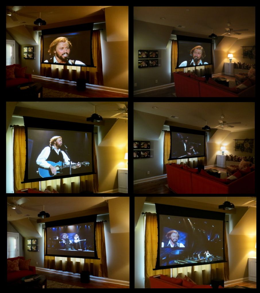

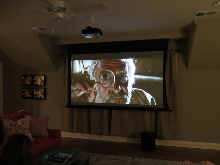

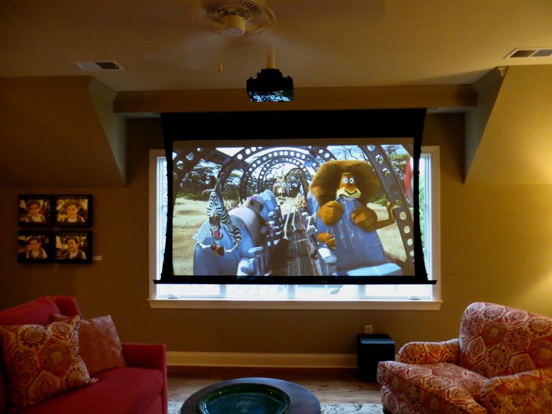

Here are a couple more CGI shots under Bright Daylight & Incandescent. These shots were "NOT" stop action paused, so what you see is a instant grab. (...oh OK...it's a Semi-Cloudy day.....I didn't stage that.)
......and for those few who persist in claiming that the degree of Viewing angle "MUST" suffer if a Mica-Based Mix has any real degree of gain, I offer a "WTF" shot under the same intense lighting combo (...note Lamps / Cans / Sunlight all contributing...)
This shot was taken at a angle off axis of at minimum 80 degrees. I call it my "HTS" offering. (Holy Toledo Shot)
Today I hope to find the time to take several "Actual Humans in a Movie" shots. Also, the long awaited and obviously absent Window Treatment Curtains should get hung, so I'll try hard to get "Before & After" shots of the same scenes and at the same positions. However if the Curtains are in place, all I'll have resisting my efforts will be the lowly Light Bulbs. No issues there !

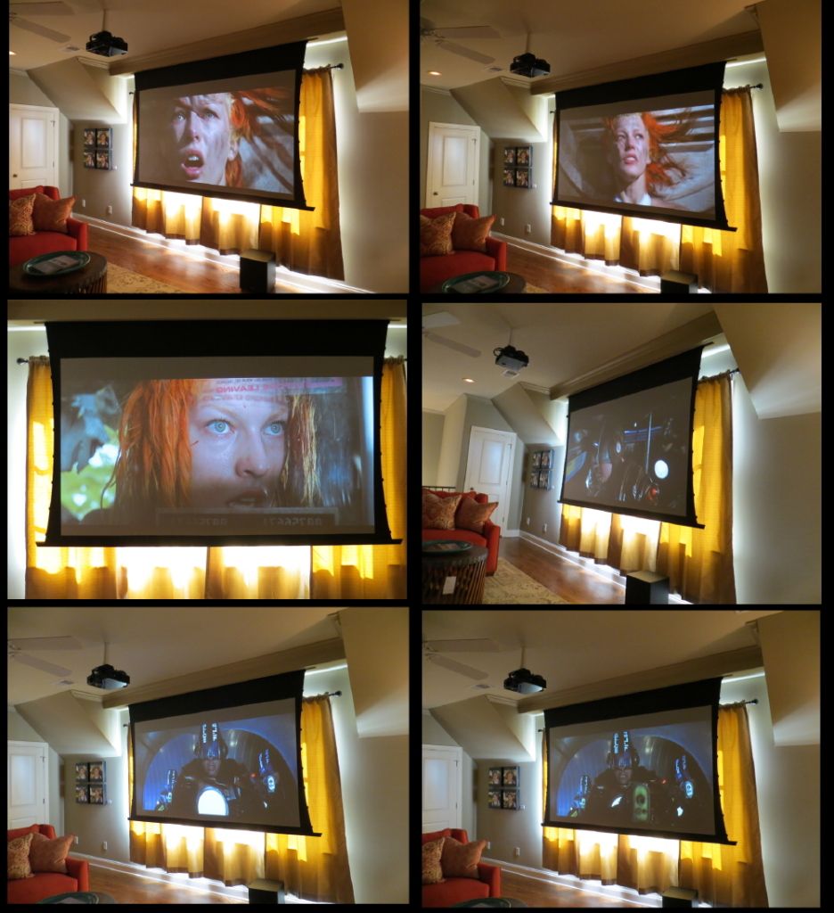

Ok...here are some composites of Screen shots (..to keep load times down...)
Some show the Room / Screen under 3 separate lighting conditions:
No lights w/ low ambient Sunlight leakage
Additional 25% Can Lighting w/Flood Bulbs
(...yeech...should be "Spots"....) mad.gif ...and will be soon !
Full on 100% Floods. (...not a real world circumstance but an effective comparison to show that resistance to such lighting is actually happening...)
The first 3 shots on the left side of the first composite were taken at 4:30 PM after the Sun had passed the south facing Window. All the others were takem mid-morning to just past Noon when the Sun was hitting the Window full on.
Room shots and a close up of the Viewsonic PJD 6683ws Short Throw PJ http://www.projectorcentral.com/ViewSonic-PJD6683ws.htm
Any request for particular screenies will be accomodated if possible.

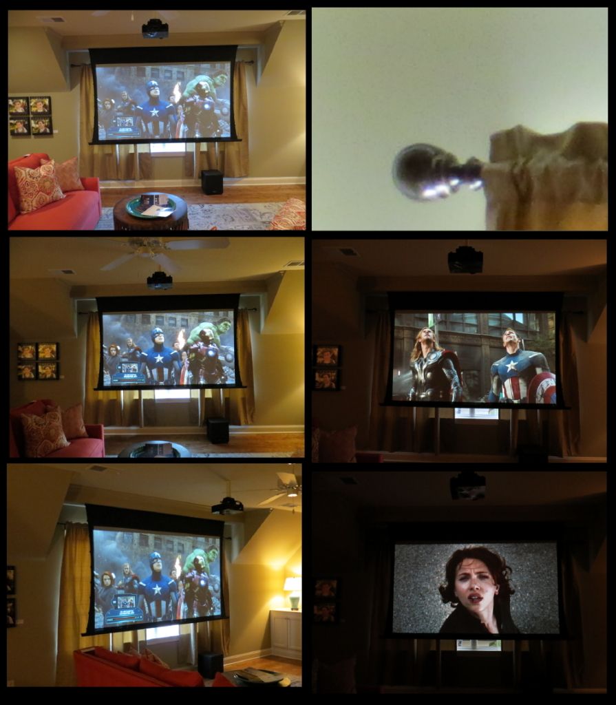

Any possibilities of some screenshots from Avengers & Underworld Awakening (viewing angle from main listening & viewing position) during daytime with blind open & close?
I don't have UW-A...and cannot locate my other Underworld DVDs ????confused.gif Must have left them at some other Home. mad.gif
I'm thinking however that you expectations are out of line with reality. If your room has any more severe light issues that what I've been showing as "worst case" scenarios, the you need to address those circumstances as much or more than you need to try to make a Screen / PJ combo try to accommodate them. Sensible limitations exist.
Here are your Avenger Shots...as best as I could manage during a Show that goes from 10 am to 7 pm and has crowds moving through at all times. And BTW, I opened the Curtains as much as I could without physically taking them down...which almost happened anyway since the Rod is an Expandable one and came apart in the middle when I tried pulling the Curtains apart. frown.gif I took a few early on...then some more later during more reduced sunlight...but pretty much tried to use room lighting to some extent in all but 2 examples.
I hope this goes some distance toward showing you what you want / need to see.
And some more various examples......the first under the most extreme circumstances (11 AM)
99.9% of the images above were taken "in motion" (...can't pause with people watching....) In fact, all the Avengers shots but one were done in that manner.... I'm getting pretty good at doing that...but I'm coming to realize that while doing such does capture a good balance between exposure of the room's lighting and that of the Screen, the image on-screen does lose some degree of potential "Snap" when it's grabbed in-motion by the Camera. Also, I prefer taking shots from off center because they disprove comments about loss of brightness (viewing cone issues) and they give a truer perspective of how a Screen performs than "straight-on Eye Candy" Zoomed shots do.

post #21 of 98 Old 10-10-2012, 07:23 AM
WereWolf84's Avatar
Join Date: May 2011
Posts: 983
Quoted: 280 Post(s)
Liked: 105
Thanks a lot & appreciates for the Avengers screenshots wink.gif also the nice screenshots from the 5th Element smile.gif I'm get used to plasma image for few years, so it's quite ambitious to achieve plasma like image under ambient/daylight situation......agree with you, thick & heavy curtains will certainly helps to improve the situation, it would be even better to combine with SF mix + light cannon pj
