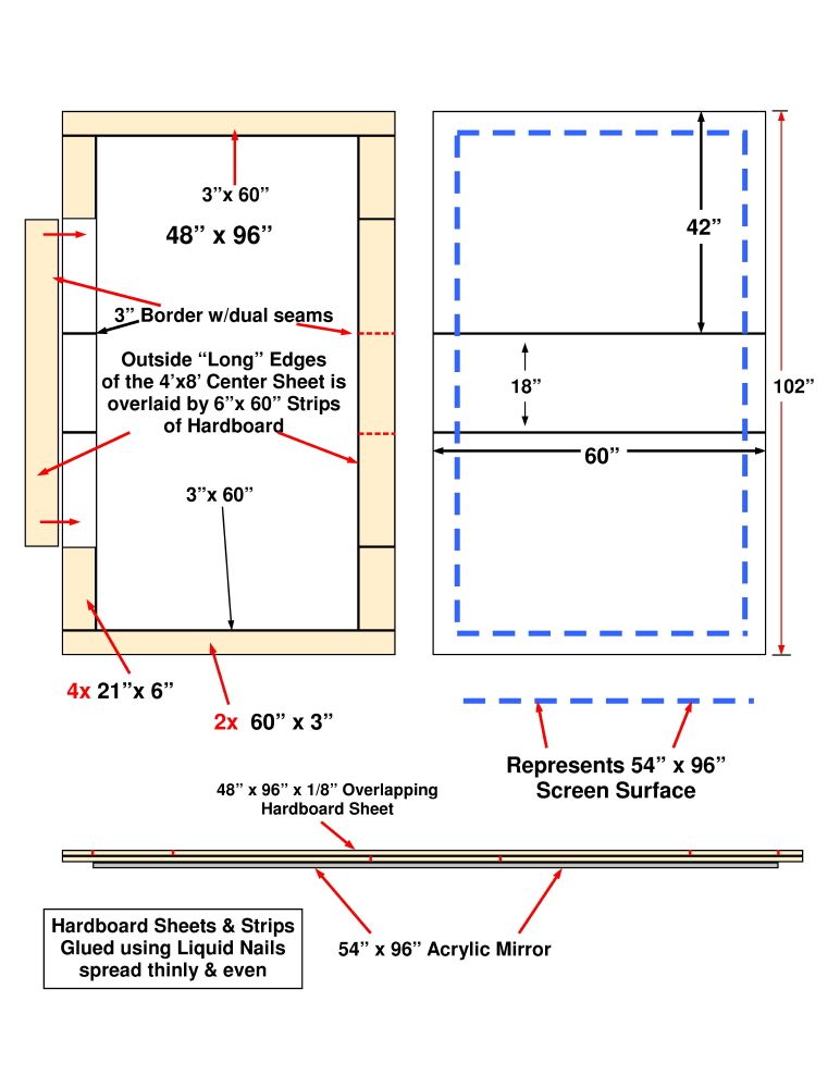

No...now that you have time, constructing a suitable Backer is indeed possible. Yes, spreading any adhesive must be a job done with care, but entirely do-able.
Wilson Art Laminate has been around for a ling time, and while applicable for many uses and instances, still has the need for a substantial Backer Board or Frame.
Brick Layed thin MDF Panels (2 "layers" )are the way to go. First you construct the Backer Board, let it dry thoroughly, then apply the Parkland.
Here's a diagram:
For your122" (60" x 107") you simply need to adjust the sizes of the pieces.
2 - 64" x 42"
1 - 64" x 29"
Overlay (center) a 4' x 8' sheet of 1/8" MDF across the 3 pieced together sheets and glue together (...use both the rougher sides for best adherence...)
Overlay the outside Strips, increasing their width and length proportionately.

So if I'm reading that properly you end up with two seams in the middle running up and down with just a 3" border around the back side holding everything together? That doesn't seem like it would be very sturdy. I mean, maybe it is but it just doesn't seem like it would be.

Well actually, you have it pretty much wrong.
Look at the illustration on the left. In the center you see a 4' x 8' sheet. That sheet is overlaying the three sections, binding them together. Each sheet cost $12.00. Using the Trimmings you make all the side inserts. They don't need to stretch the entire perimeter....but they should overlap all the sectional joints by as much as possible.
And absolutely....if you can make a decision to just spend for another 5' x 10' sheet of something, then there you have your answer.

The Backer Board as illustrated was made so that two 1/8" thick layers of MDF Hardboard could be sectional-ized and assembled into one reasonable lightweight and rigid sheet to support flimsy material such as 3mm laminates, 3mm plastic sheeting, even 1/8" acrylic Mirrors. 1/2" MDF Boards at 5' x 10' can be had...but they too cost more than a little chump change, and are TERRIBLY heavy.
Sintra then is your best bet...not because it's free or even cheap, but because it's readily available, sized as you want it to be, and will be easier by a mile to work with. Why....you could even just use it for the Screen itself of your will ing to paint a high performance coating onto it, and then you'd realize a screen surface that would be almost an order pf magnitude better than any "Hang and Shoot" option out there.

Laminate is just too thin, and will require a substantial Framework...and a good job on one will cost enough to matter, and through the whole process of receiving / cutting...and mointing there is a decided risk of breakage. The WA-DW also has "Sheen" issues with brighter PJs so that effectually dooms that....unless you get it solely because you can get it in a 12' length and you plan to paint onto it.
Your other option would be a Millskin Silver Spandex Screen, with the Spandex stretched across a lightweight Frame. The Silver Spandex will be JUST under 1.0 gain, and it's gray hue will make the 8200 look as good as possible. In reality, most recent DIY'ers on here will relate it's not at all a difficult or expensive build. In fact, recently so many have been delving into Spandex on this Forum, you'd think this was the DIY School of Modern Dance or sumthin'. biggrin.gif
Hey.....everything I personally do is centered around PERFECTLY matching up a PJ to a Screen to the Room. What I cannot do is force DIY'ers to follow suit....for a myriad of varied reasons....and not all of then center around cost as much as they do around the DIY'ers "ability" or willingness to take things to a level where they get more than they ever expected.
No matter what else can be said, ain't no way no how a 122" High Contrast / 1.0+ Gain Mfg "Fixed" Screen will cost anywhere near as little to make, nor be as ideally suited to a particular job, as a well made DIY Screen of the same design.
MississippiMan is online now

Originally Posted by MississippiMan View Post
Painting is essential if you want the 8200 to perform like a Epson 6020 or Panny 8000 and really give you satisfying Black levels without your having to reduce color and white dynamics via attenuation of actual lumen ouput.
They actually do make Sintra in 12'ers, but I personally have never come across any stock where I've looked.
6mm Sintra can bend around a Corner (carefully) without breaking or creasing. if laid against a Flat surface and screwed around the perimeter it will usually lay flat....but applying flattened daubs of Adhesive Caulk can get that concern out of the way.
I did see plenty of mention of spandex in my searching but never really paid too much attention to it since I was focused on making this Polywall work. Now if what I'm reading what you're saying then it seems that the Spandex option may just be the best possible solution for me. How much does this cost and what is the best/cheapest place to source it? Sounds like I may want to get a white to wrap the frame in then the silver so that the projector doesn't light through and show the frame? Any tips or pointers as I consider this option would be great but I like the prospect of this DIY option unless it's cost prohibitive. *fingers crossed hoping spandex is affordable*
Jer

Going BF Shopping.
Read the Threads....it's all there.
PS.
It ain't very expensive.
Silver Millskin or Moleskin Over White.
www.spandexworld.com
Consume....Digest.....Make the decision and we'll take getting you detailed info from that point forward.

Yeah, I found that website in my searching but I'm not sure how much I would need or of what type. I also see that it comes in 58 or 60" widths (?) so I'm not sure how one would stretch it over a frame and get 122" so I assume it's either available in wider widths or people just stay under 120" for their screen. Maybe it's very stretchy. Who knows, guess I will do more research and see what I come up with.

BTW, since my plan to use my Polywall sheet has since changed into building a spandex screen I've started a new thread here geared specifically towards this new plan. Thanks for your help so far MM.
