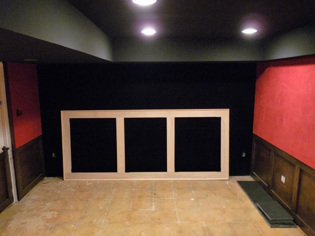

I will have silver matte mole behind and white matte mole in front. The screen frame will be painted black and of course the wall is already black velvet so the only benefit of adding 1" of Linacoustic is for additional treatment. It won't affect the picture quality I just didn't want to waste time or insulation if it wouldn't be helpful. As of right now I figure it shouldn't hurt so I'm planning on doing it.
I hung the screen frame last night and I am not happy with the French cleats I bought. Perhaps it’s the screen track on the back but there is very little metal overlap. I just don’t see how I’m going to be able to get the screen centered and all three cleats on and level once the spandex is wrapped. Think I paid $10-$20 each for the cleats too. I even bent the cleats out a bit and it didn’t help much.
So I either need to toss those and just take some wood and make my own cleat or attempt to hang it with 2-3 people and then if that doesn’t work make my own cleat. I hate redoing work and wasting money and time.

BTW, save yourself the grief of another miscue and go forward with making your own Cleat. You can then control length / depth / and positioning.

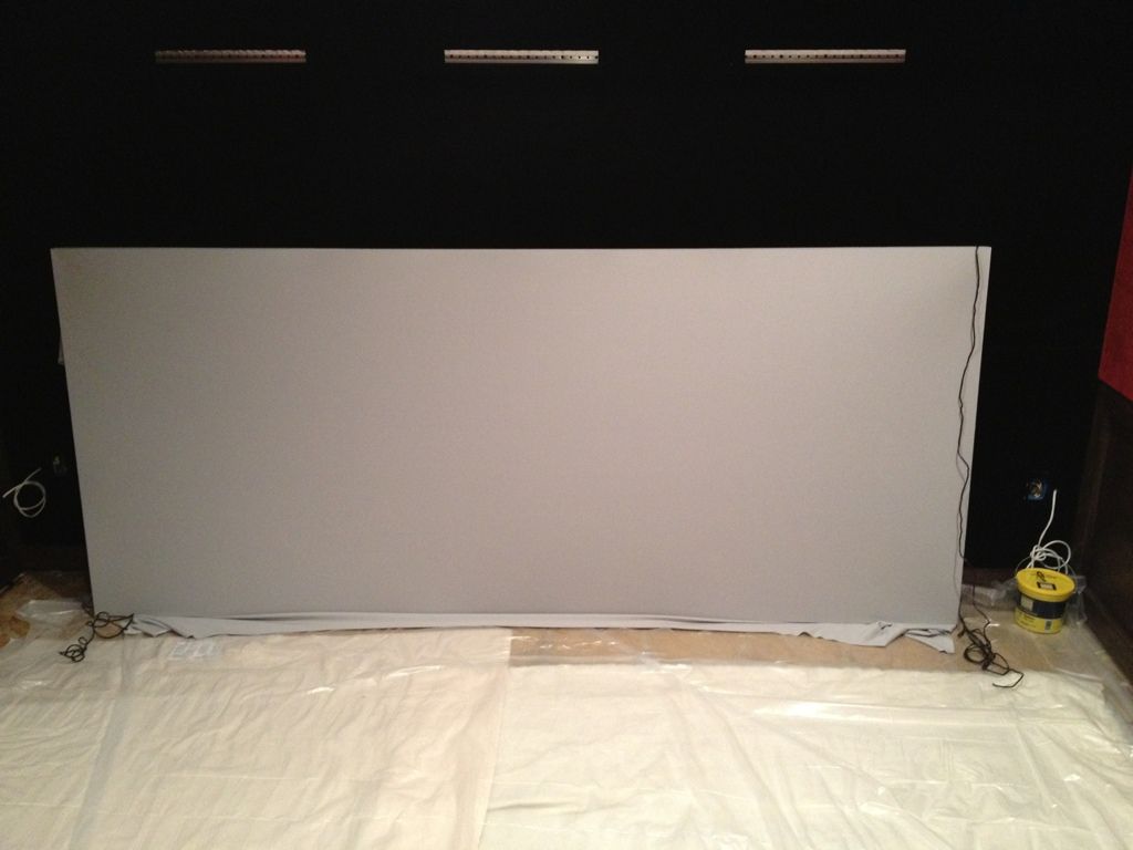

I have three yards of each so once electrical is done next week I'll clean up the theater and lay down a fresh blanket, then a plastic drop cloth and give the stretching a go.

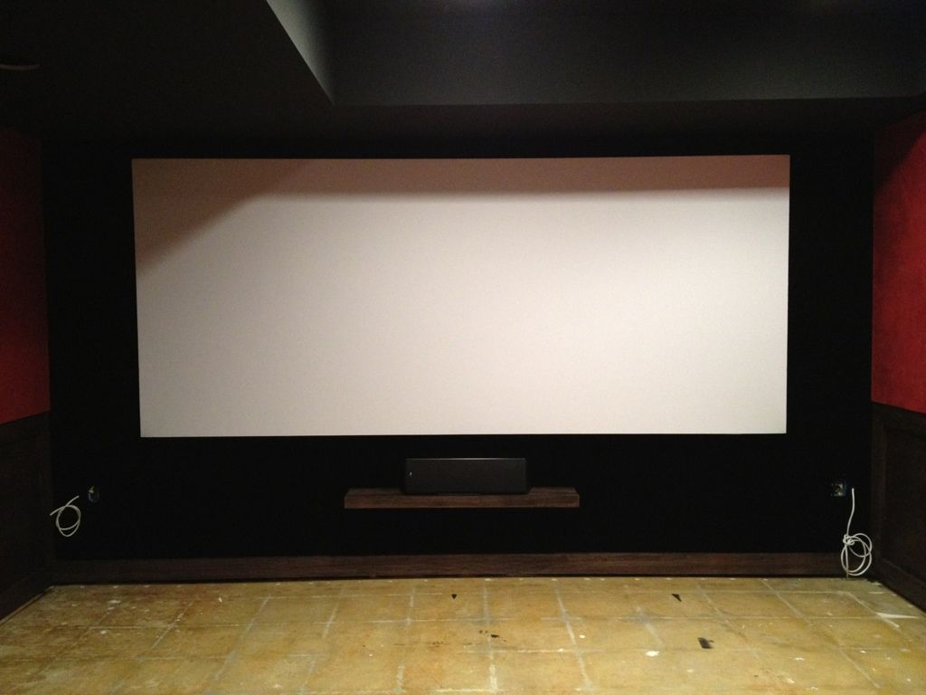

post #14 of 21 Old 02-23-2013, 05:21 PM - Thread Starter
design1stcode2nd's Avatar
Posts: 893
Quoted: 31 Post(s)
Liked: 44
Screen is wrapped and hung
It has three 31"x37" linacoustic panels behind it

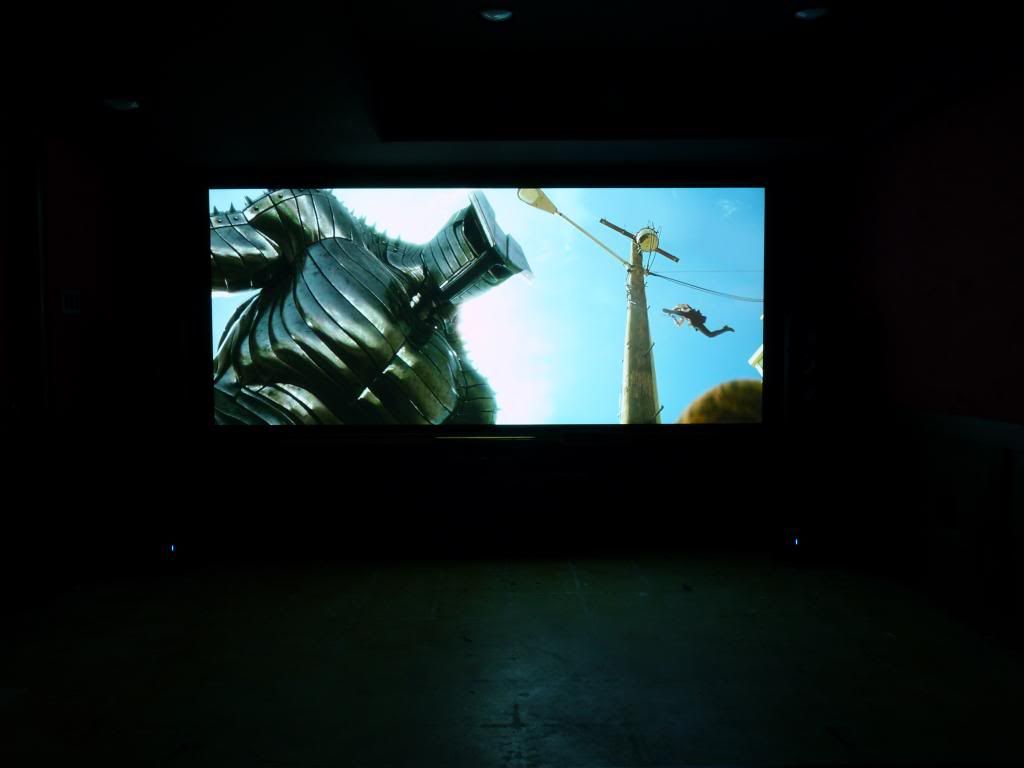

Quick and dirty, looks much better in person but I don't have a DSLR. I'll keep messing with the settings and see if my camera can take a better picture.
The black levels are much better than my old screen and the picture is crisper I think. It's been four months since I've seen a movie in my theater and my memory isn't that good.
I've done some eyeball level calibration on Color 1 for my Pan 4k and when I tested the New and Dynamic modes which really pump out the lumens it was just too bright for both my wife and I. I would only ever use dynamic if I had most of the lights on for some reason.

Try moving back further, then using Zoom to frame the image, leaving about 25% viewed content of the surrounding room at most. Put the camera on / use "Auto" everything else.

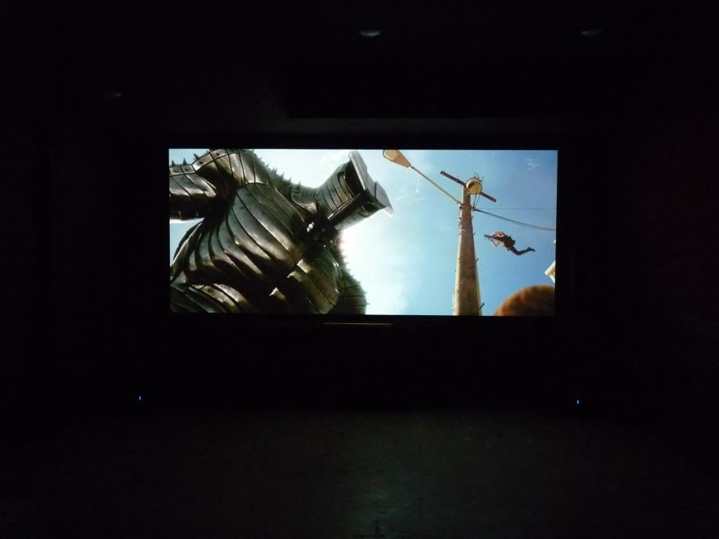

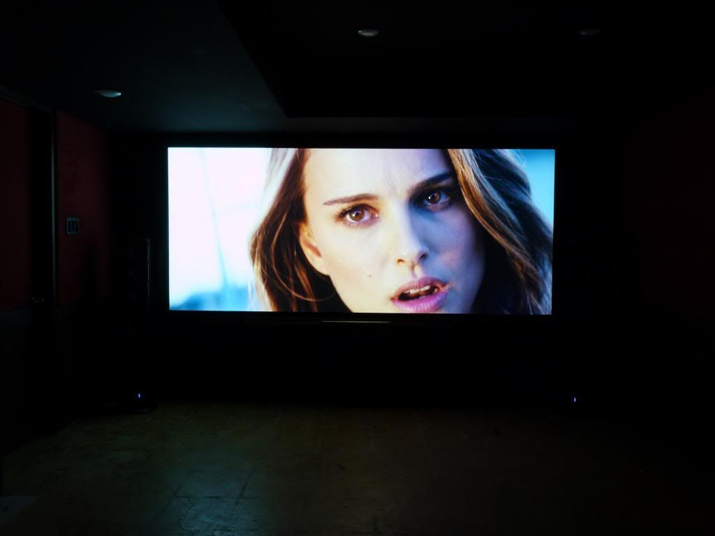

post #17 of 21 Old 03-02-2013, 04:56 PM - Thread Starter
Posts: 893
Quoted: 31 Post(s)
Liked: 44

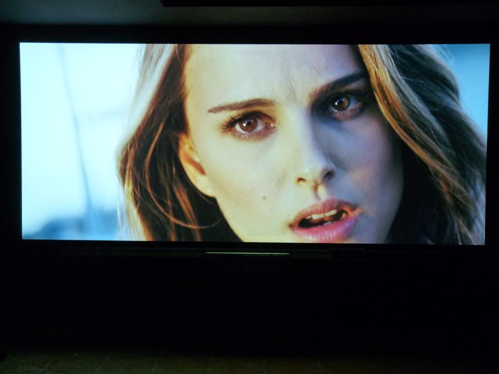

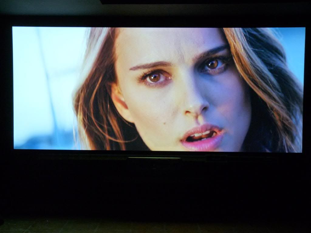

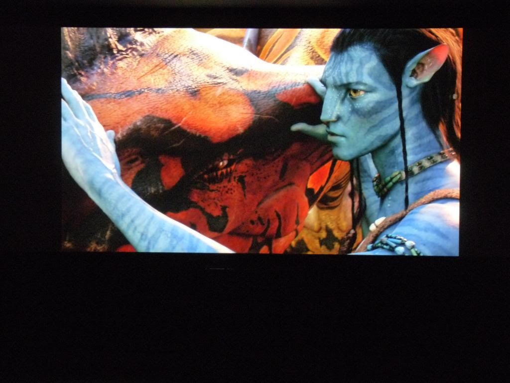

I took some new shots leaving the camera in auto. I'll need to borrow a good DSLR to get anything good the artifacts at 100% resolution are bad. Anyway here they're for what it's worth.
The PJ is a Panasonic AE4000 on Eco mode with 1030 ours on the bulb.
Color 1 550 lumens
New, 950 lumens
Dynamic 1300 or so lumens, I forget
I forgot what these were
Play like a Raven
design1stcode2nd is offline
