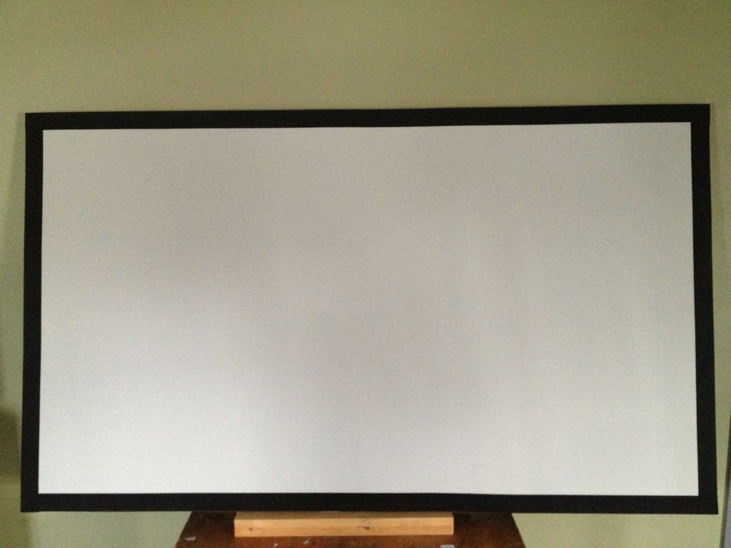

First-time PJ owner here who needed a TAUT/rigid screen to hang in front of my existing 60" Kuro until I have my new dedicated space. After looking at the budget-minded $100 to $300 commercial offerings, I decided two things:
1. None of them seemed guaranteed to offer me the frame rigidity/screen uniformity I demanded.
2. Your mileage may vary of course, but most of them seemed slightly to very overpriced for their build quality/performance (yes, even at ~$150).
Looking at the cost/performance ratio of DIY screens, I knew I had to at least give it a try.
My goal here is not to reinvent the wheel with the construction, per se, just provide some feedback re my experience and results. Please ask questions or provide commentary as I'd appreciate the input.
Scenario:
VERY well-illuminated 15x14 living room with ample southern-exposed windows. As I said above, until I have a dedicated space, I need a screen that can hang in front of my existing display. This also limits the sheer size of what I can take on, as the both the screen itself and screen border (even if I went with the acoustically transparent route) would cause sonic issues. It took a bit of brain (and leg) work, but I rearranged this (all iphone pics, sorry you'll have to suffer):
like this:
to accommodate a larger screen. I now could fabricate an ~85" screen which is, handily, almost exactly TWICE the size of my 60". wink.gif
PJ: Panasonic PT-AR100u. PLENTY of lumens and 5 star reviews all over the place.
Materials:
22' of 1" x 3" $26 (but free for me, already laying around, lol)
4' x 8' sheet of hard board: $11
Quart of Flat SW 7071: $15
22' 3/4" trim: $20
25' of velvet adhesive tape: $10
roller/hanging hardware: $8
Call it ~$90 for joe six-pack.
Since I wanted a rigid screen that looked decent NOT hanging on or mounted directly to a wall, it seemed like a 1x3/4 constructed frame and a hardy board screen was mandatory, so that's the route I took.
With a "smaller" screen I deemed 1x3 with suitable corner and center bracing to be more than adequate. Sorry I do not have pic of my frame-job, my dum-ass deleted it off my phone. But after affixing the scuffed front-side hardboard, I was looking at this:
I then propped it like so to take the SW 7071:
I lightly hit the surface with some 320G before applying the 7071 with a quality foam-roller. Rolling off the surface and back-stepping just a single column, I can tell you to expect EXCELLENT results on this surface, with this roller, and this paint. There is nary an imperfection to be found. It is true, fantastically even and uniform. I'm not saying this to beat my chest, I'm simply relaying it for those who are interested in (or timid about) getting superb results. Just take your time, be mindful of the paint you're putting on (and applying) off the roller, and I'm certain you'll enjoy comparable results.
Pictures of which I'll post later as I have to go for now...
thanks all,
James

Really couldn't ask for things to go any better. So pleased I went this route...
James

Border on.
James

Half of the border trim on. Should have the second half on tomorrow and ready for hanging!
James

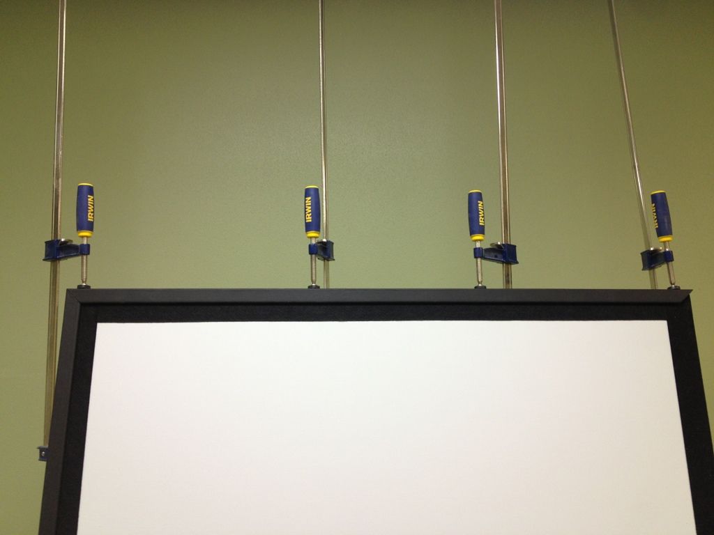

Question:
I have a white ceiling...no I cannot paint it, lol.
What you do think regarding hanging the screen?
Use white eyelets at the top of the screen (really no easy way to hide them) and white hooks (into joists) from the ceiling (like these: http://www.amazon.com/Panacea-86202-Ceiling-Hook-White/dp/B001B42CT6)
Or use white hooks with black eyelets? My feeling is that white on white may be less noticeable...even if the white eyelets look a bit goofy in the top of a black screen, straightaway. I suppose I could titebond a couple of small mounting blocks to the rear of the plywood corner braces a bit lower than the top of the screen to hide the eyelets (that would be great!), but then I think the weight won't be centered when hung and the bottom of the screen will want to tip in (read: away from the viewers). ???
I do have pretty easy access to my attic and I've considered using 50lb test fishing line- allowing two loops to hang from tiny holes (which hooks in the top of the screen frame would hang on) in the ceiling and then anchoring the line somehow in the attic- but I just anticipate that being a real PITA as far as adjusting to ensure the screen is level/tying it off just so.
Other options?
thanks

I went back and forth with hanging a screen before deciding to mount it.
Of the options you gave I would suggest using the fishing line with the white hooks. No need to get into the attic, easy on/off. As for leveling just use the test pattern to make sure everything is straight before you tie off the line. Once its tied off, it shouldn't wiggle. From my experience, and based on the number of speakers in that room eek.gif you'll need to adjust your PJ every now and then from lense shift.

^ Yes, good point about the fishing line from the screen, not the ceiling...duh, lol. That was my original plan and then I fell in love with the "nothing in the ceiling" look.
This whole thing prolly sounds goofy to people, but I really want it to look as clean as possible.
I think I'll anchor the hooks, paint them white (or buy white ones if I can find them) and simply figure out a good way to fasten the line to the screen. I wish I could find VERY strong, thick (read: not very stretchy), clear rubber bands, I'd bet they'd work great.
James

For hanging the screen, try using french cleats. They are low profile and can hold way more than what your screen weighs.

Here's what I ended up doing (pics later)...
I sunk a pair of robust eyelets into the top of the frame...then was proceeded to be completely baffled by the sheer lack of narrow, long hooks. Long (~3 1/2"), narrow, eyelets EVERYWHERE, of course.
Why did I need real long narrow hooks? Well, the former owners had the brilliance of adding a 1/2" layer of drywall over an old chipboard ceiling (about a 1/2" +) and then another layer of 1/2" drywall, so I needed a very long shaft if I was going to be able to have the hook get through all of that, hit a rafter, and still protrude far enough away from the ceiling to be usable.
Well again that hook doesn't exist. Trips to (3) hardware stores and an online search made it rather clear. 2 different clerks laughed right along with me.
So what did I do? I bought one of the long, narrow eyes of course, and used a channel lock to bend the loop into a hook. Looks decent, but I'm going to pick up a pair of stainless jobs and simply cut the loop with a hacksaw for a much cleaner look.
I have to say I was literally blown away by the fact I simply could not walk in and buy the hook, but this will work in the end...should be easy on and off with absolute certain holding strength.
One of those times you just laugh at when it's all over.

Unless I am seriously underestimating the guage of eyelet you'll be using, it will almost surely be easier to cut the eyelet ring with the cutter in a pair of linesman pliers, I'd imagine it will be difficult to use a hacksaw on something so small?

It's (the eyelet) pretty thick my man, trust me. I'll post a pic later. I'll tap it into a piece of wood and cut it in 30 seconds.

Well it's finished and I'm extremely pleased...I'll post better pics, this was the best I could do with my iphone. It really looks much better than I thought it would, even with a very good amount of ambient light.
Seems nearly impossible to get decent pics of it with my iphone at dusk/darkness, but I'll try. My regular camera is MIA right now.

Thanks for the compliment. I'm a bit shocked that there's not a bigger issue with reflections actually...it's a VERY white ceiling, but at least it's matte so that prolly helps. Still, I get them, but not really enough to be bothered terribly.
I have another room a few steps away where I can store the screen by simply hanging it on the wall, but it's been working so well thus far that I've not even been inclined to take it down.
Re the swaying: since the eyelets are mounted near the rear of the top of the screen it wants to tip "in" towards the bottom (read: towards the front wall) so I simply placed a couple of decorative rocks behind it atop of the subs to keep it perfectly vertical...you can nearly make the left one out on the bottom of the screen if you look close (my floors not level so it's harder to see the one on the right wink.gif ).
If I do this again down the road and don't have this option I'll simply ensure that the eyelets are mounted in the middle of the frame, as it doesn't sway on its own when it's "centered".

Snapped a quick one of this moron yesterday afternoon. You have to understand that this room is just getting PUNISHED with light- the curtains are WIDE open at 3:30 in the afternoon- the screen is much more "contrasty" than it appears in this image. I'm still very much impressed with this PJ and screen combo.
