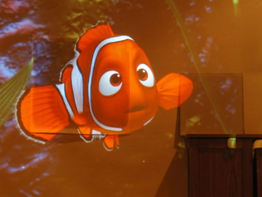

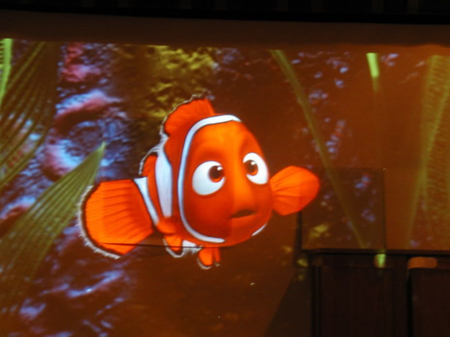

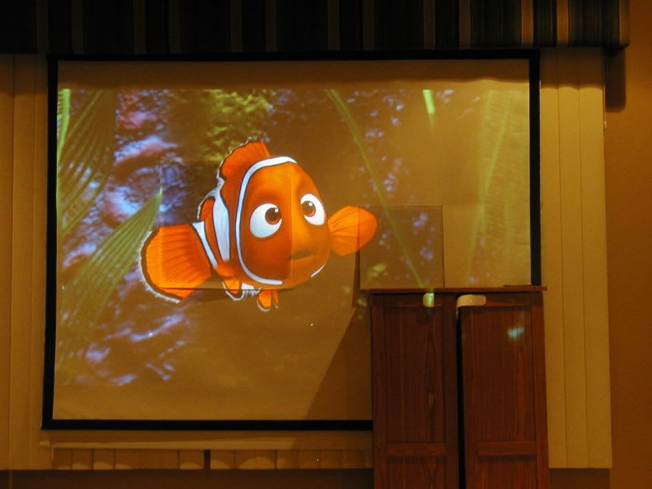

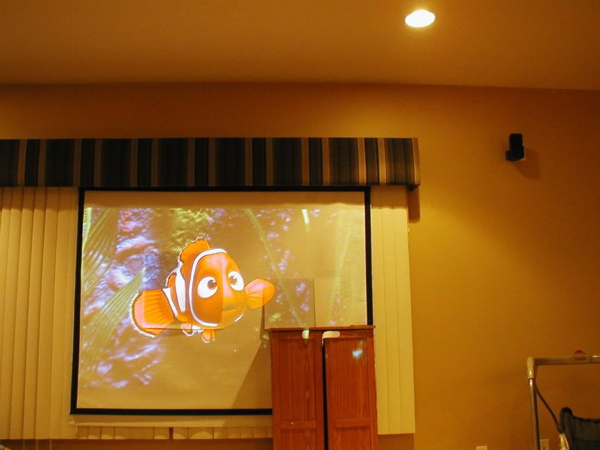

Old 11-28-2005, 07:40 PM
Richum's Avatar
Join Date: Jul 2003
Location: Houston
Posts: 860
TBL Screen
The Big Lyle.

I kind of screwed up my formula a little bit--it can be salvaged, but I forgot to pick up, what I think is, a key ingredient--the Delta metallic silver, which is a large portion of the mix. I doubled the amount of Sterling silver, but have a hunch that the Delta metallic silver imparts a much darker grey to the formula. I rolled a couple of samples anyway to see what would happen to the image. What I found was a slight to moderate increase in ambient viewing, but a much improved picture with lights out. The substrate I used is a very thick white vinyl material (I would describe it as semi-glossy) that I picked up from Joanne's. I plan to use this for a DIY roll-down. The sample that I painted (about 1.5'x1.5') rolled up nice and tight without any problems with the paint, so would most likely work with a DIY application.
One aspect I was really impressed with--although the screen appears as a grey color, the whites really stand out in this formulation (although there appears to be a slight shift to blue in the pictures, especially in Nemo's stripes).
(Incidentally, I also rolled a 12"x12" mirror with the stuff, and was not impressed--I'm sure others will most likely point out that I probably did it wrong, and did not achieve the light fusion effect, but the image was a bit softer than the other vinyl sample I did, and also did not seem to improve the ambient light properties as much compared to the vinyl sample).
SO--I plan to pick up some Delta metallic silver tonight and finish the formula, and see what I get. It may be that I want to darken the formula even more. Any suggestions on what would allow me to do that?
Despite the incompleteness of the formula, I did take some pictures:
This shows the screen, with the vinyl sample center-right, and the mirror sample propped up on the cabinet--taken zoomed out to show the canned lighting.
This shows a closer-up view
Even closer (You can really see where the formulation was painted onto the substrate in this one--there is about an inch around the vinyl that is not painted:
This one is another close up, with the overhead light off, and only some light coming in from the side:
(One thing I thought as I looked through the pictures--the mirror itself had to be propped up, so it in ever-so-slightly angled toward the canned lighting (thereby reflecting more light back from the canned lighting--not to mention it is directly below the canned lighting, as opposed to the vinyl), so that may explain the ambient lighting differences between the mirror and the vinyl. But I still think the mirror picture looks softer than the vinyl picture)

i'm not so sure that darker is the key. in fact, the delta silver metallic is both less metallic and lighter in color than the folk art sterling silver. your vinyl sample should look good as a full screen.
