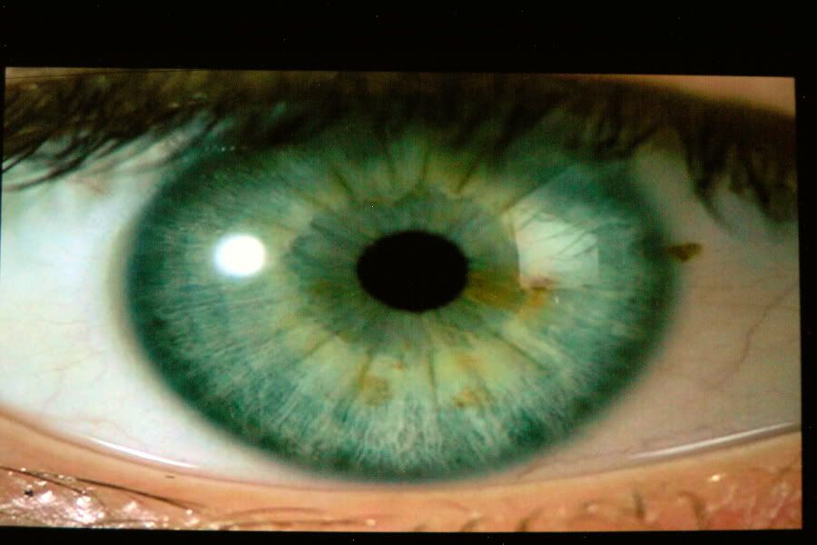

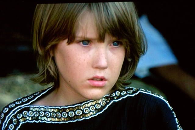

I didn't seem to have any problem getting my coating to stick to mylar. Check the first pic.
On the second surface, I stick by my experiments. The second pic is a cross hatch pattern. A Silverstar is on top.

You want to improve your contrast ratio?
http://www.avsforum.com/avs-vb/showthread.php?t=637107
Check out this guys solution. After reading this MMan may try lamp black in his eyes before a movie. Did you notice MMan's screen shot of the kid DOES NOT have black pupils? Where is the black MMan? Is this child actor a freak of nature?

Your seeing a reflection in those pupils. Look to the right side of the left eye to see the black that lies outside the central curvature of the eye.
Then look at the Tunic.
Black. No Eye drops needed. Here. Let me help you out.
