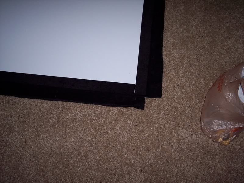

Well, I built my designer white screen this weekend and couldn't be happier. Scoring with a utility knife is a snap, by the way, both literally and figuratively
I made the frame out of 1x4 pine boards, and covered it in a stretchy velvet fabric. I attached mirror hanging looks on either side and just used heavy duty picture hanging wire. I put two molly bolts in to the wall and hung it from there.
I have one little problem in that I made a mistake in how I attached the laminate to the boards, so I ended up not getting it tight enough and there is a little distortion.
It's a simple fix, though - I just have to take the screen down, undo the screws and reattach it, being more careful. I didn't bother yesterday because I was sore and tired from making it and I just wanted to enjoy football all day (go Seahawks).
Thanks to everyone who helped in this thread, as I ended up with a great looking screen for about $150 all told. I'll get some pictures up soon. Final dimensions ended up being about 100x56, plus the three and a half inches on all sides for the frame.

I wrote this in response to a Pm and I think might help others so I'm going to repost it here.
I bought 4 1x4 pine boards and carried them home. I then used a manual miter box (just a plastic guide with a saw you can get at Lowes for $8) and cut the ends of each board to 45 degrees at the correct spot. So now I had four boards with 45 degree cuts on the ends. Two were 106" long, the other two were 63".
Then I layed them out on the fabric I bought and cut the fabric in to strips, leaving an inch or two on either side of the board. I used a good staple gun and attached the fabric to the board, stapling once on one side, then once on the other and working my way down. Wrapping the fabric around the corner was tricky and messy, but as long as it was tight on the front I didn't care.
Then I took metal brackets and attached the boards together, just using wood screws directly in to the wood. Then I laid the laminate down on the back of the fram and used those same wood screws to attach the laminate.

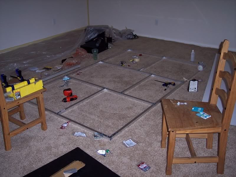

Here's my screen frame:
Here's the screen before masking (that happens tonight):
I accidentally punched a hole inside of the frame with the drill when I was installing the screws, but it's fortunately covered by the masking.
The masking laid on the screen, and some extra cloth, which I wrapped around the aluminum frame instead of painting it:

JosephShaw, First, that looks really impressive how you mounted your laminate. But a couple questions: where did you get that square aluminum tubing? And what kind of cost do you have into the screen mounting with that?

Nice work, JosephShaw! I presume you're using 1" sq aluminum tubing? Can you estimate how much the frame weighs and how rigid is it? I want to construct a similar frame except I plan to pivot mine from brackets on the wall so that it swings up to the ceiling and out of the way when not used. BTW, what material are you using for the screen?
