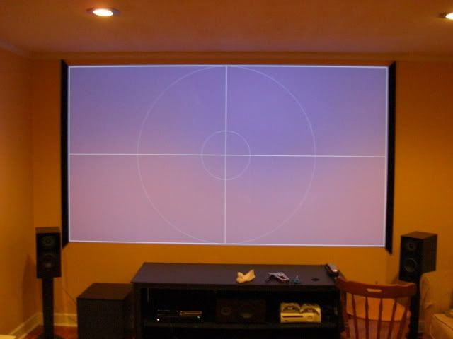

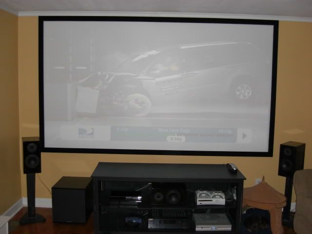

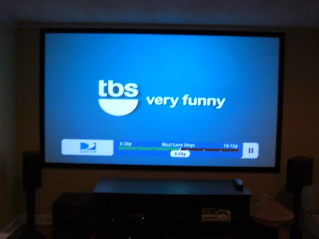

Hey guys...
I've had a 4'6" x 8' (110" diag) 1:78 Designer White screen fastened to the wall with mirror clips for about 2 years. I also made a black velvet border that works quit well. The only problem: the laminate is pretty wavy. So, after getting sick of the waves, I got a bunch of straight poplar wood from HD, left it laying in the HT for a good month or so (to acclimate to the humidity to avoid warping later on), and finally cut the wood today. After sanding the wood, I will put the frame together with wood glue and pocket screws (with the help of a Kreg Jig... look it up on Amazon). Now, I plan on priming it and painting it black, but besides that, should I do anything else to seal it from moisture to keep it from warping? I'll post photos later (my wife is out of town with the camera), but the design of the frame should minimze the chance of warpage, plus I'm going to mount it to the wall with dual French cleats (top and bottom). As for gluing the laminate to the frame, I got contact cement and a bunch of dowels to make the process easier... and I know I'm only supposed to use the contact cement around the edge of the screen. One more question, as stated above, I plan on priming and painting the frame, but should I avoid painting and priming the part of the frame that the laminate will be glued to? Seems kind of obvious but better to ask before than after. I'll be sure to post photos after my wife gets back. Thanks in advance.

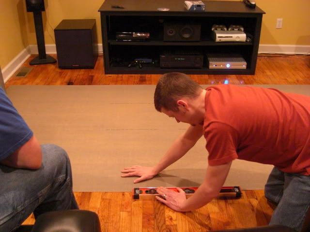

Just thought I would share with those looking to make a screen with laminate and are hesitant or unsure about cutting it.
I cut some Wilsonart laminate this past weekend for a countertop, using a tool like the on this link except it had a plastic handle.
http://grizzly.com/products/Laminate...ng-Knife/H4207
I gotta say that it worked quite nicely. While it was face down and using a level I was able to score in a few passes a nice grove. Then I was to just kept going in that grove without the level. I kept at it until it made the cut all the way through. It made a perfect cut and straight line. I was also able to cut an angled edge for a better fit in a corner. Just be patient and you'll make it all the way thru.
Not sure if anyone has posted this before, just want to help out anyone who may be thinking about this and is kind'a leary about the cut. Go for it, just measure twice...

I made my frame and then glued it to the frame. I used a ROTOZIP Laminate Trim Bit to trim the laminate to the exact fit. It left a very smooth clean cut. I got the bit at Lowes for around $14.
I started by using the laminate cutter and straight edge, it was much easier with the router bit.
Just my two cents.

Well my DW laminate sheet came in today. I quickly realized that I would have too many waves with mirror clips and don't have a vehicle that can transport the lumber required to build a frame and didn't feel like spending the cash on an aluminum one so I did something kinda crazy.
I velcroed the entire sheet to the wall. Mind you this isn't the best idea because in places where I had to remove it and put it back up there to get it straight I have holes in my wall from the industrial strength velcro...but its up there. I guess I would have to patch the holes from screws and stuff from a frame so it's just a bit more mud when I decide to take it down (will be a while). Anyways, thats my quick and crazy DIY solution. I did call a few friends and counting me had 4 people to put the screen up as it needed to be level the first time it went up.
All in all I spent $20 on 15ft of velcro and $110 on the sheet of laminate. My velvet came in today so once I buy some trim and put it around the screen (also going to velcro it to the wall) I will have spent less than $200 total for a screen roughly 125" diagonal...not too bad! The sheet I received was 61 1/8 tall so I'm using all of the heights and merely trimmed one of the sides.

Originally Posted by Fredster4 View Post
I have a 4 x 8 sheet of Wilsonart designer white on order. I want to build the largest screen I can with it. My hope is that if the factory cuts are square, I will only have to make one cut. If a 4 X 8 sheet of Wilsonart laminate is in fact 4 feet by 8 feet, according to my calculations, I should only have to cut 10 1/2 inches off the 8 foot length, making it 7' 1.5". This would make a screen that is 48" by 85.5".
I read someone else's post who said they bought a 5 X 8 sheet of laminate and it was 61 inches on the short edge.
Can anyone verify the actual measurements of a (nominal) sheet of 4 X 8 wilsonart DW laminate?
Also - what about my idea to try to use 3 factory edges without cutting? Do they come square?
Also - I would like to go frameless - essentially a floating screen. What I have seen someone else do but I can't remember where I saw it - was build a frameless screen (clarification: there is a wooden frame behind the laminate - there just isn't a frame in the front of the screen like a picture frame) and then attach it to a wall painted with very high emissivity paint - something like Ralph Lauren black suede paint. Essentially avoiding the fun of building a frame and covering it with black velvet. So here is my question: How far off the wall should the screen be in order to acheived that floating screen look sufficent that any light spilling off the sides of the screen are lost in the blackness of the wall behind it? 2 inches? 3 inches? 4 inches?
Thanks for reading,
Fredster4
Here are some build pics from mine, hope it helps...

Just got mine done tonight! Luckily the wife helped alot so although time consuming, went pretty smoothly. Here are some pictures. I hoped to of had enough velvet for a masking system, but I overcut on most of my frame and trimmed alot of excess off so I only have enough velvet left for one mask. So if anyone has a 10' long piece of velvet roughly 12inches or so (at least) wide let me know, would save me from having another 4 yards from sy's.!
