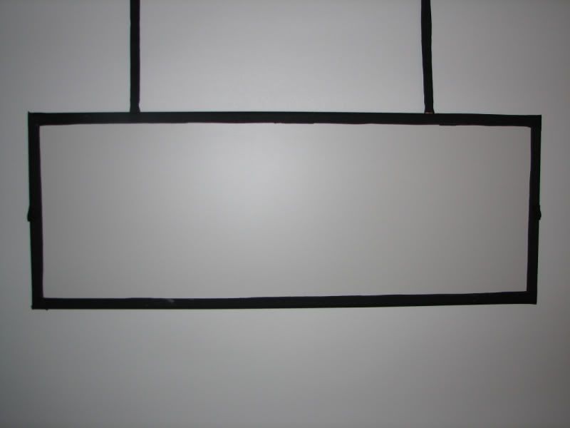

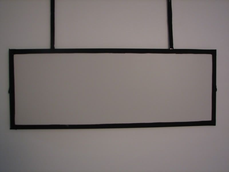

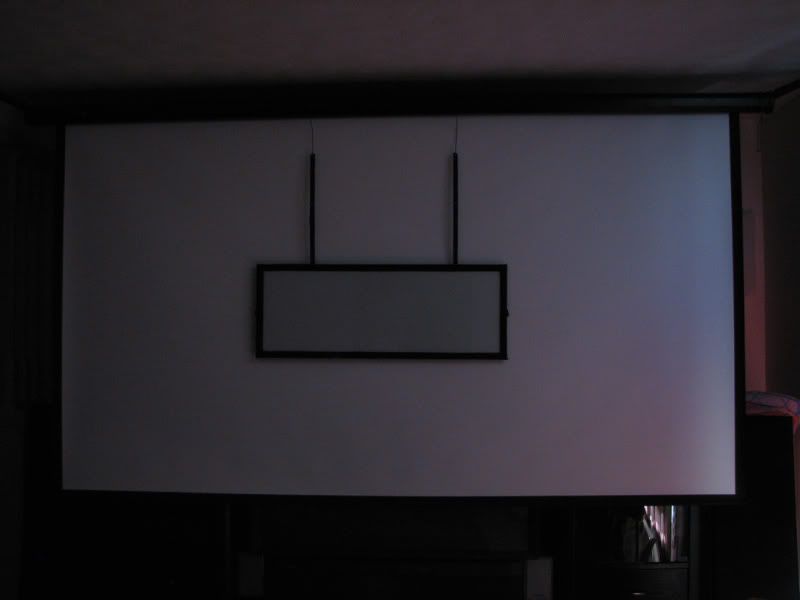

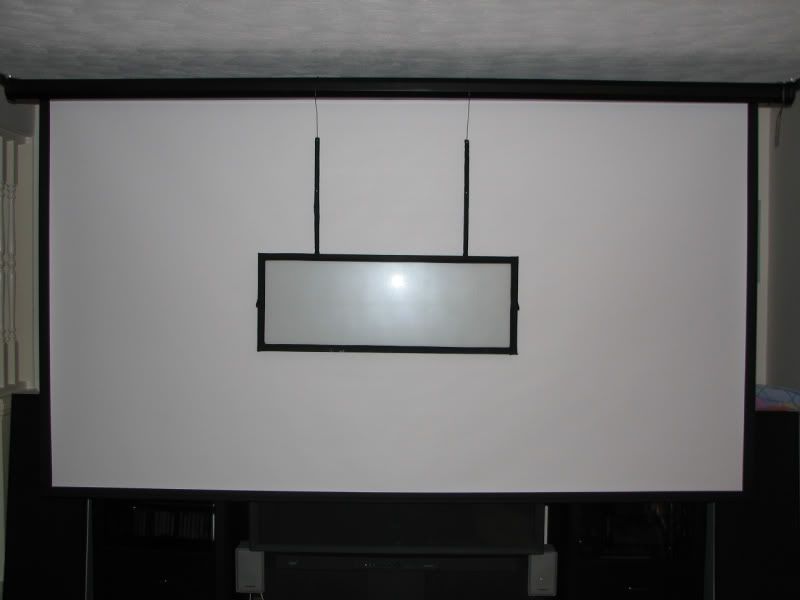

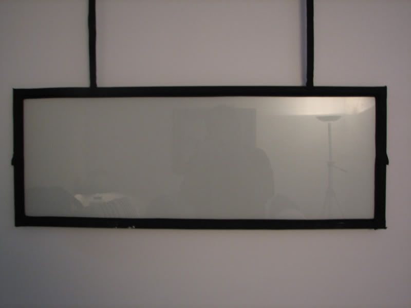

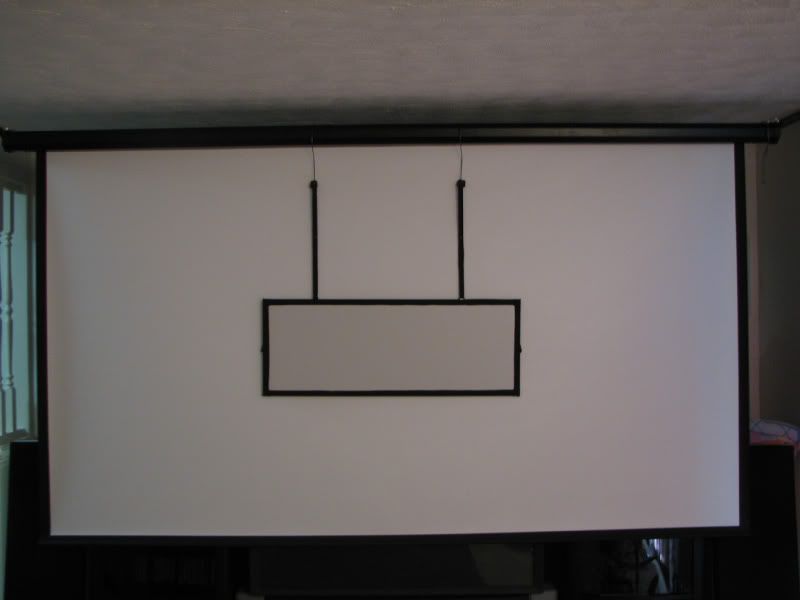

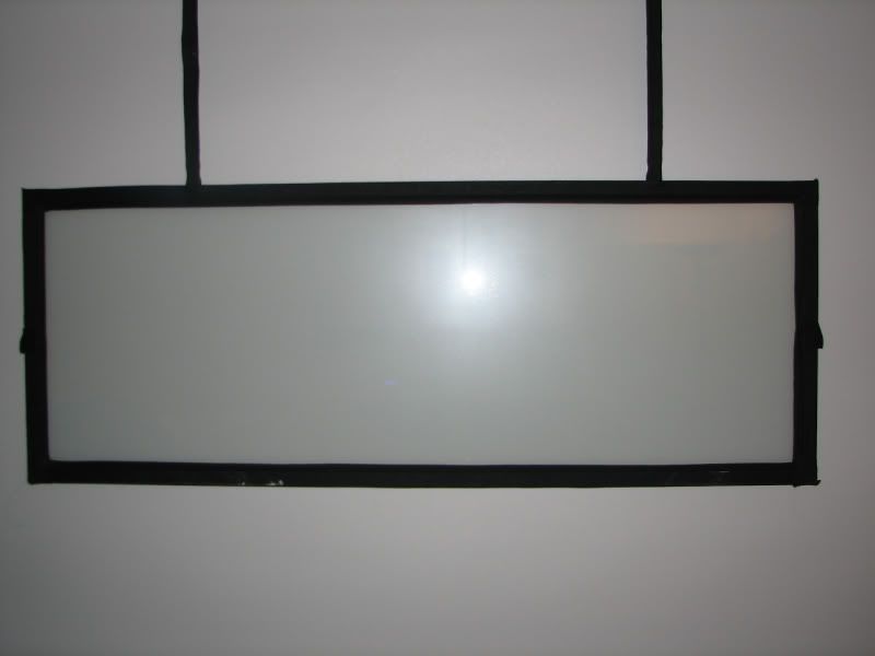

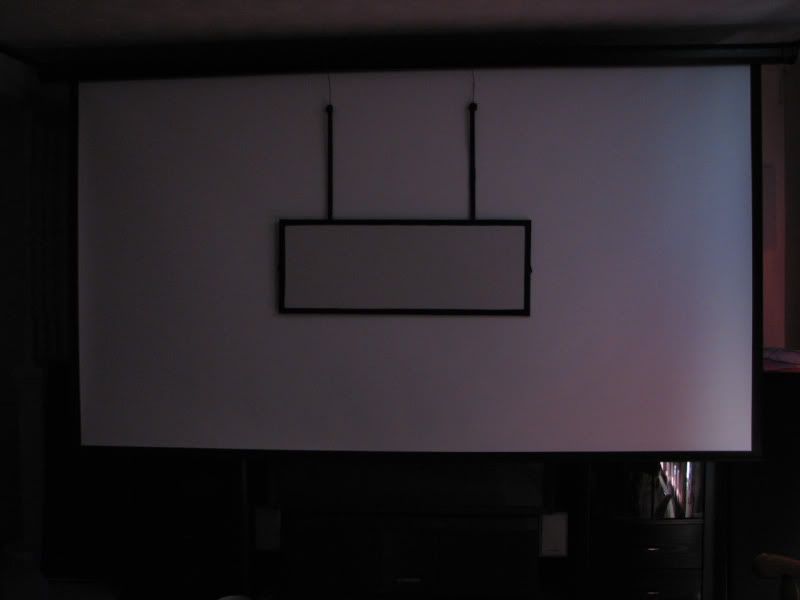

Here are a few more photos. They are in pairs, front (paint side) and rear (glass side).
Room Light, Front
Room Light, Rear
Room Light Closeup, Front
Room Light Closeup, Rear
Flash, Front
Flash, Rear
Flash Closeup, Front
Flash Closeup, Rear
Ambient Light Front
Ambient Light Rear
tiddler is offline

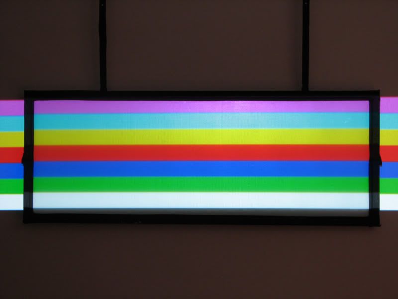

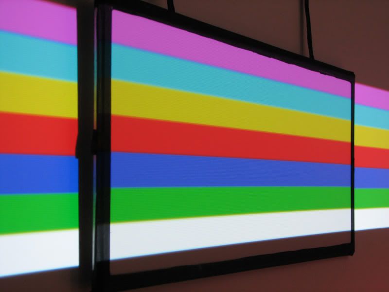

Some more front and rear shots:
Color Bars, On Axis, Front
Color Bars, On Axis, Rear
Color Bars, Side Seat Front
Color Bars Side Seat Rear
Color Bars Off Axis Front
Color Bars Off Axis Rear
tiddler is offline

As far as your latest window shots, it was interesting to see the backside of the glass. As you guys said, the flat paint looks like a gloss from the back.

Introduction
There is no doubt that similar or better performance could be achieved using other ingredients but pb_maxxx elected to stay true to the spirit of DIY. Therefore he strove to create a screen solution that is doable by the vast majority of regular folks using ingredients that are commonly available. RS-MaxxMudd can be successfully applied with some practice and standard paint rollers. Ingredients were restricted to those available off-the-shelf at retailers such as Home Depot and Michaels.
In order to explain RS-MaxxMudd we need to start looking at the off-the-shelf ingredients. Once we break the off-the-shelf ingredients down into the component parts we can discuss the purpose of each of the components.
Delta Gleams Silver Metallic #02603
Contributing Components:
Mica Flakes: These are tiny flakes of mica that act like tiny mirrors. If you dissolve some of the Silver Metallic in water you will see that there is a high concentration of mica in the paint. These flakes will sparkle silver red and blue on the stir stick. I think they are actually clear and the color you see due to the way the light reflects off the mica surfaces.
Pigment: The silver grey color comes from the grey tinted pigment. It is likely that the tint used is Lamp Black or something similar. The Delta Silver Metallic is the lightest of the Silver Metallics available from Behr, Folkart, Decoart
Clear Base: The clear base makes the paint translucent. This allows the mica flakes within the paint film to reflect some light. The combination of the mica flakes and translucence is what produces the specularity we expect from a metallic paint.
Primary Contribution: I believe the primary reason for including the Delta Silver Metallic was to contribut large enough quantities of mica flakes without adding too much Lamp Black. Pb_maxxx posted many times that other Silver Metallic paints were too dark to start with. I often wonder if pb_maxxx, in hindsite, might have looked for an off-the-shelf source of mica flakes that did not include any grey pigment at all.
Delta Gleams Pearl Finish #02601
Mica Flakes: Pearl finish paints also contain some tiny flakes of mica. If you dissolve some of the Pearl in water you will see that there are flakes but not anywhere near the concentration seen with the Silver Metallic. As far as I could tell looking at the flakes, dissolved out of the paint, the same mica flakes are used in both the Pearl and Silver Metallic.
Pigment: There is some white (or near white) pigment that give the Pearl its white color.
Clear Base: The clear base makes the paint translucent. In the case of the Pearl it is almost transparent. This allows the mica flakes within the paint film to reflect some light. The low concentration of pigment normally allows the mica to produce some color effects. Once combined with the Silver Metallic this effect is obscured.
Primary Contribution: I believe the primary reason for including the Pearl was to introduce some white pigment to balance off the gray pigment from the Delta Silver Metallic. I suspect there was also a hope that by using the Pearl the concentration of mica would be maintained. Or it may be that pb_maxxx wanted to reduce the concentration of mica but that would have been easier with additional Poly and UPW.
Delta Gleams Metallic Pale Gold #02624
Mica Flakes: As a metallic paint the Pale Gold contains a high concentration of mica flakes.
Pigment: The pale gold appearance is achieved with a yellow pigment. The color yellow is made up of Red and Green so the inclusion of a yellow pigmented paint is similar to adding some red and green pigment.
Clear Base: The clear base serves the same purpose as for the Silver Metallic.
Primary Contribution: It has been stated that the Pale Gold was intended to improve the flesh tones. Screen paints that contain Lamp Black often result in grey looking flesh colors. I believe the Pale Gold (Yellow = Red+Green) does this by balancing off too much blue introduced by the Silver metallic grey pigment that contains some Lamp Black. Or in AVS terms the Pale Gold Metallic counters the Blue push commonly seen with Lamp Black and UPW.
Behr Interior Flat Ultra Pure White (UPW) 100% Acrylic Latex No. 1050
Minwax Clear Satin Polycrylic
Distilled Water
tiddler is offline

Could be my monitor (or my eyes ), but I thought the Gray-Poly-Pearl (1:1:1) looked just as good, overall, as the RS-MaxxMudd (on whiteboard)...
-T
T-Bone is offline
post #117 of 143 Old 10-27-2006, 09:21 AM - Thread Starter
tiddler's Avatar
Location: Ottawa, Canada
Posts: 5,676
Originally Posted by T-Bone View Post
Another bump...
-T
If you look at the bright scenes you will see that the RS-MaxxMudd outperforms the Gray+Poly+Pearl. I should also point out that the Pearl used was Behr White Opal Pearl. The WOP does not contain a very high concentration of mica flakes. For the most part it is simply making the overall shade of gray lighter.
Both panels perform well with regard to black levels but since the RS-MaxxMudd has brighter whiter whites the overall contrast is improved.
It may well be that your monitor needs some adjustment as well.
One advantage to the Gray+Poly+WOP is that it is much easier to roll. Due to the low metallic content it does not require down rolling.
Like many things in life there are diminishing returns. You may reap a 5% increase in picture quality for a %50 increase in skill required when going from a Gray+Poly+Pearl to RS-MaxxMudd. The jump from a flat gray latex to the Gray+Poly+Pearl requires a %5 increase in difficulty for a %50 increase in picture quality. The biggest variable in all this is you. In the end you have to decide what you are willing to do to get a result you will be happy with. Be warned though that once you start messing around with this stuff it may never end, Eh!
tiddler is offline
