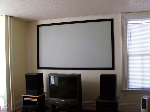

wbassett, that looks pretty good. What were your steps? I know you put down a base coat of Gray Screen. Did you mix anything in with it? Did you put a top coat over it?
Topher is offline
post #92 of 611 Old 11-15-2006, 07:51 AM - Thread Starter
wbassett's Avatar
Location: Been all over. Currently living in upperstate NY in the Capital District area.
Posts: 1,797
No steps, this is just two coats of Sherwin William's Gray Screen in the matte finish.
I got the clears for some top coating experiments and test, but I haven't used them yet.

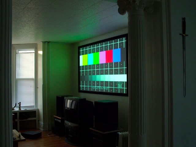

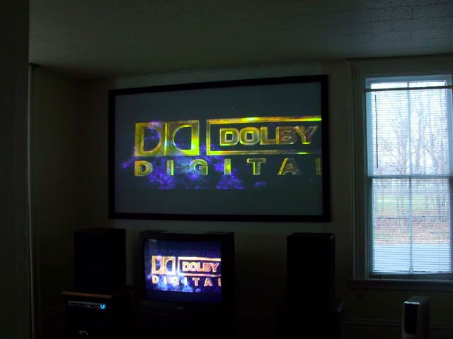

Yes it is Sherwin Williams Gray Screen SW7071
BAC Colorant 02 32 64 128
B1-Black - 20 1 -
Y3-Deep Gold - 5 - 1
RGB is 199 203 203 Munsell N8 is 202 202 202
There is actually a closer match, True Value's Winter Mountain at 200 201 201, and even though there is a True Value in my town, I was really curious about the matte finish that Sherwin Williams has.
The screen size is 54x96, the projector is a Sharp Sharp PG-C30XU. It's rated at 1700 lumens, but it's less than that with this setup-- reversing the fL formula (Lumens/screen size in square feet = fL) comes out to 972 lumens. Since the calculators always err on the side of manufacturers specs, I'd guess 850-900 lumens tops.
Right now this is the only daytime shot I have right now. I know it's not a movie image, but I'll get some of those up in the next few days. Keep in mind this picture was taken while the paint was still wet. The screen dried darker than the wet color.
Blacks are absolutely black. Like you have stated with your screen, there is no need for a masking system with this color any my projector.
"Make everything as simple as possible, but no simpler." - Albert Einstein

post #98 of 611 Old 11-15-2006, 07:32 PM
Patrick Mckowen's Avatar
Location: Oak Ridges, Ontario, Canada
Posts: 23
I dont care if you were obducted by little grey men and you are trying to find an outlet for it -- thats ok, go with it !
I am convinced and you havent finished your experiment yet. I will be going up to the store this weekend or next and getting a can.

post #107 of 611 Old 11-25-2006, 06:26 PM
Posts: 23
hi
Looks great -- I am 70% for this method and 30% for BOC --- I have not seen to many pics of BOC if any at all -- memory failure!
Watching Harry Potter on the new panny -- ax100 --- pic is on the wall with builders off white paint -- looks great -- cant imagine how fantastic it would look with your grey.
Later Patrick
Patrick Mckowen is offline
post #108 of 611 Old 11-25-2006, 06:41 PM
Moderator
Moderator
prof55's Avatar
Join Date: Oct 2002
Posts: 1,466
Mighty fine shots, Bill. I think this proves that the right gray can do very good things, even with fairly high ambient light.
prof55 is offline

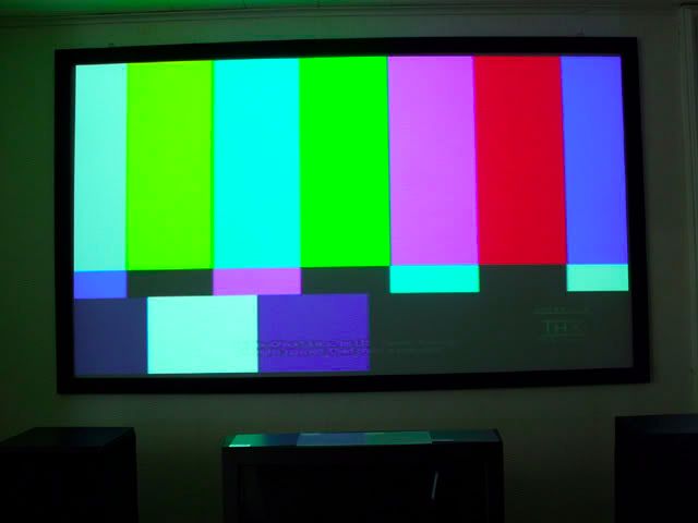

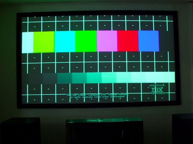

post #109 of 611 Old 11-25-2006, 08:52 PM
idf_reuben's Avatar
Posts: 12
I do see a lot of green cast in your images. Im working on something right now, and the forums wont let me post any links until i have 5 posts under my belt, this being number 5 I should be able to help with the color cast on your pics
idf_reuben is offline
post #110 of 611 Old 11-25-2006, 08:54 PM
idf_reuben's Avatar
Posts: 12
Wow! I really like how this came out. Im looking at getting a projector, probably the Mit HD1000U due to teh 1500 lu and price. Painting a screen is what I will have to do to keep the costs down. Thanks for all the hard work and constant updates!
I do a lot of photography and noticed your pics did have a green tint to them. This is more than likely a white balance issue. Since I dont know anything about your camera, the only way I could help out is removing the green tint from your pics. I used one of the pic with the gray scale and went off that. You should try Adobe Lightroom, its in beta now and free. Under the develop tab you can choose your eye dropper on the right and click the nuetral gray square in the pic, then apply them to the rest of your images.

Okay here are some more pictures now that the screen has had a solid week to dry. I made a quick border for it as well (my DW screen was just tacked up, I am working on a frame where I can load test panels and am still designing that one)
First let me start with a request for help. If anyone has a FinePix S3100 that can help me with my manual settings (or anyone that knows digital cams) PM me please, or better yet post any setup in the standards thread-- That will keep this thread from getting way off topic. I bought a tripod and that fixed my blurry images. I have tried every setting I can think of, but obviously there is a certain combination of settings I need and I still don't have the camera portion down yet.
That isn't a copout or making excuses. I am getting nice camera images, but they aren't anywhere near as good as the screen looks in person. I just want to get the best pictures that I can get. (In bright white scenes, they are white on the screen, but my camera is adding either a blue or green tint depending on what settings I pick)
To start here are a couple of shots with the screen now 'dressed' with a temp. border. I started taking pictures today around 2:30PM. I took this from the doorway to my second living room looking in from the hallway, that way I could include a window to give an idea of what time of day it is and the brightness in the room.
The first set of pictures are some colorbars and gradient bars. It is still the same time of day, but the camera is making it look darker in the room, and that is where I need assistance. These pictures were taken within minutes of the first one, so there has been no change in the light from outside coming into the room. In fact I actually opened the blinds to try and make it brighter in the room.
Same color bar, but from the doorway leading to the second living room. I intentionally included the window to show how much light is coming in.
This is from the second living room at approximately a 45 degree angle and around 22 feet away.

The good ole Dolby Digital logo (it's off center because I didn't wait and paused too soon). I actually turned on my 36" CRT set for this picture to try to give an idea of brightness as compared to a normal TV.
Before taking any movie shots, this time I am going to change my gama setting ON THE PROJECTOR. I do not see in anyway how that can be manipulating the screen image since it falls more in line with projector calibration. I will then list all settings and the exact chapter and frame the image was from.

wbassett,
First let me say bravo. I have been following the work that you and Tiddler have been doing. It looks like you are both finding solutions that the average Joe can put up with limited muss or fuss. I like it. I have been meaning to paint a board or two for comparison for about 9 months now, and haven't. I can't justify the time it would take when I consider I could be sitting on my duff enjoying me theater instead. With these solutions, that excuse is starting to wear a bit thin. Also, my nieghbor has decided to paint a Goo/Digital Grey screen. Once he has his completed I'll paint some test panels and do some comparisons of the various mixes. That is worth spending a bit of time on.
Secondly, in the Dolby Digital picture with the CRT below ... are the colors between the two that stark (Yellow vs. gold) or are you seeing something different?

There is a slight difference but not as much as in the picture. Both look gold, but the CRT leans more towards a copper/brass tone. They are being fed by the same DVD player, but they projector is using component and the TV only has SVideo connected right now.
