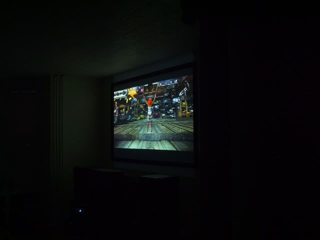

Here is a shot before any paint and with the Samsung logo screen up.
After the skim coat is sanded prime and put up any paint application you prefer.
I use this as my test screen for painted screens. This is after the first coat of Gray Screen.
After the second coat and remasked.

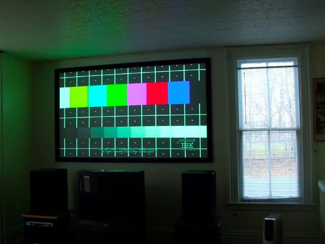

My test screen dressed out with a black suede border trim and the wall finished with a decorative/textured paintable wallpaper and ready for painting. Total time from start to finish a week and a half.
Calibration stage for my test screen...

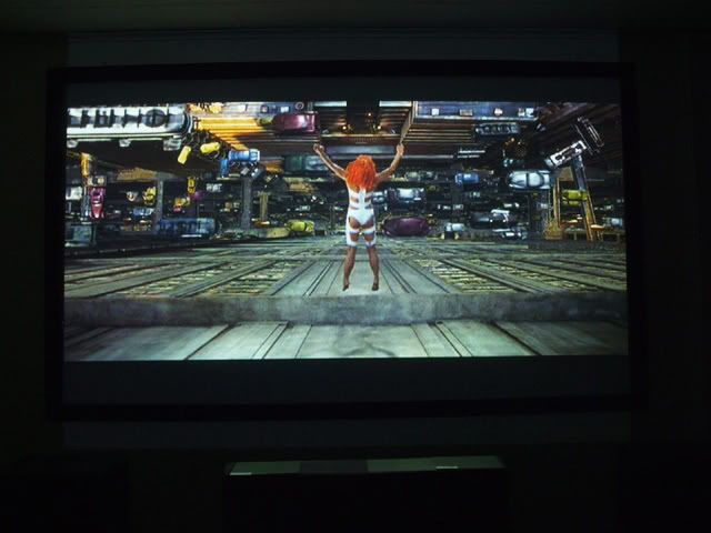

Some images after the second coat was fully dry and the test screen was trimmed and dressed out... on axis and off...
