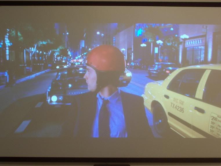

Room Condition: white walls, cathedral ceiling, wide viewing area
Light Control: little to none, tons of ambient light
Projector: Evo, 800x480, 300:1 contrast, 1000 lumens
Projector Mount: Ceiling, pointing about 5 deg downward, 7-8 ft in air
Screen Make: DIY fixed
Screen Material: White Parkland Polywall, black felt wooden border
Screen Size: 96" diagonal (15:9)
Height off Floor: Roughly 4 feet
Approx DIY cost: 1x3 wood, paint, poly, parkland, brackets, felt, glue = $65
Alterations: 2 coats gray paint, 2 coats polyurethane
Recipe if applic: Behr quart #1050, lb 0 4 0, yo 0 1 0, Behr quart poly
At night, low lights
At night, w/room lights on high
During day, worst conditions possible
Fifth Element, no lights

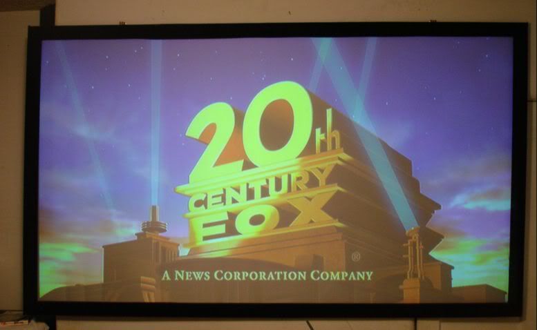

Room Condition: Room is 12x16 with 6'4ceiling height, basement in a circa 1870 walls are tan and ceiling white soon to be black 8'back from screen, wall behind screen flat black
Light Control: 100% light control (6) 60 watt ceiling cans on 3 dimmer circuits, viewing ranges between zero light for movies to moderate ambient for family viewing or sports.
Projector: Sharp XR10X projector 2000 lumens 2000:1 CR XGA
Projector Mount: Ceiling mounted DIY mount 14'6 throw zero keystone adjustment
Screen Make: DIY canvas painted screen 120 no masking self tensioning design more details in signature links below.
Screen Material: Canvas painted neutral gray
Screen Size: 4:3 72x96 constant width setup 16:9 54x96
Height off Floor: 2 inches
Approx DIY cost: $120
Alterations: painted and top coat see threads below in signature
Recipe if applic: white base with 22/48 oz lampblack as pigment, same paint blended with poly as top coat
thumbnails click for larger images

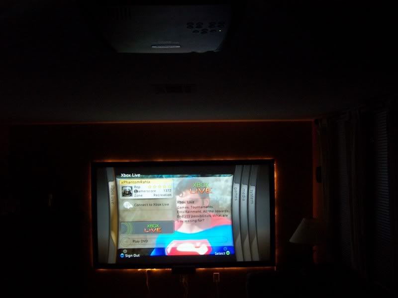

Room Condition: Wall color is "Brown Paper Bag". The room is my main living room. There is a Westinghouse 32W6 in the Armoir to the left of the screen for television watching. The screen is used for Xbox 360 and movies.
Light Control: Three 5ft windows on the adjacent wall to the right of the screen with curtains and blinds. Two lamps in the room (one immediately to the right of the screen in the corner, and one in the rear of the room). Overhead ceiling fan lights in the dining room to the left of the screen. All light can be controlled.
Projector: InFocus 4805
Projector Mount: 14ft from screen, 8 ft up. Connected via homemade mount with 6in tube.
Screen Make: DIY
Screen Material: Do-able
Screen Size: 100"
Height off Floor: 22" off ground
Approx DIY cost: Do-able= $14 Frame=$20 Felt=$15 Rope Lighting behind screen=$10 Total=$59
Alterations: Rope Lighting behind frame
Recipe if applic: N/A
Camera used for screenshots was a Kodak Easyshare 3.1MP
All lights on:

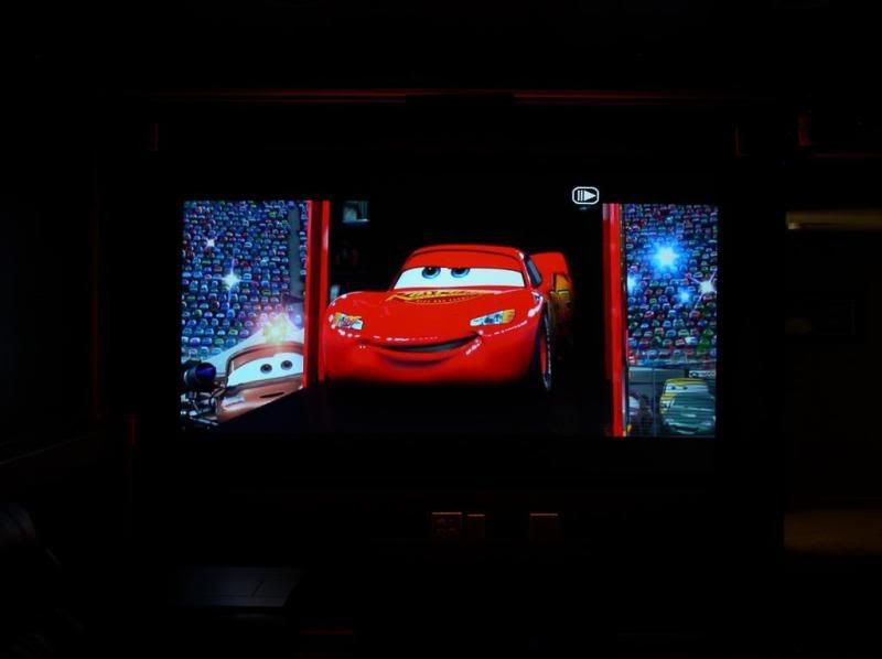

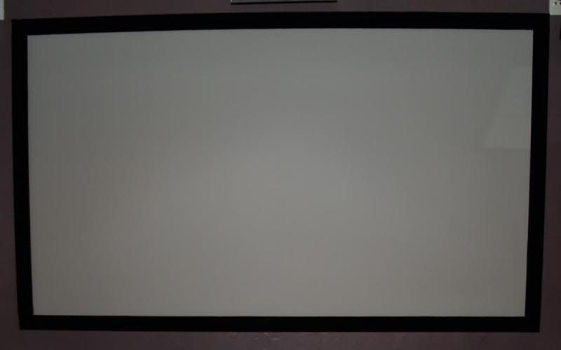

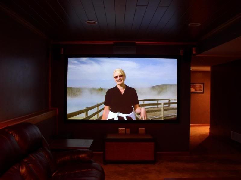

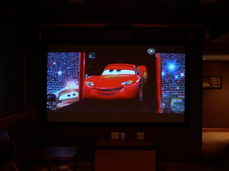

Room Condition: Purple Venetian Plaster walls, Armstrong Woodhaven Ceiling Planks - Cherry
Light Control: complete yet lights are always on at least 50%
Projector: Mitsubishi HC3000 4000:1 contrast 1000 lumens
Projector Mount: eBay $20 generic mount
Screen Material: Wilsonart Fashion Grey with 2 coats Behr Clear Matte Poly - Velveteen trimmed border
Screen Size: 100" diagonal (16:9)
Height off Floor: not sure - I'll get back to this one
Approx DIY cost: ~$200 - FG $95 - Wood frame, rope lights ~$100 - this was cabinet grade wood that I used.
Alterations: 2 coats Behr Clear Matte Poly
Recipe if applic: none
A quick shot of normal viewing ambient light
The screen
Space Shuttle
NASA guy
Cars
normal lighting
dark
DiscoveryHD Yellowstone normal lighting
zoomed in a bit
off axis

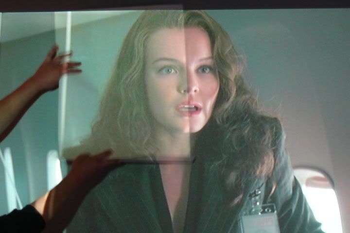

Ambient light , with white posterboard on screen for comparison
all lights on
lights off
off axis viewing
upconverted sd dvd
superbit fifth element
finiding nemo

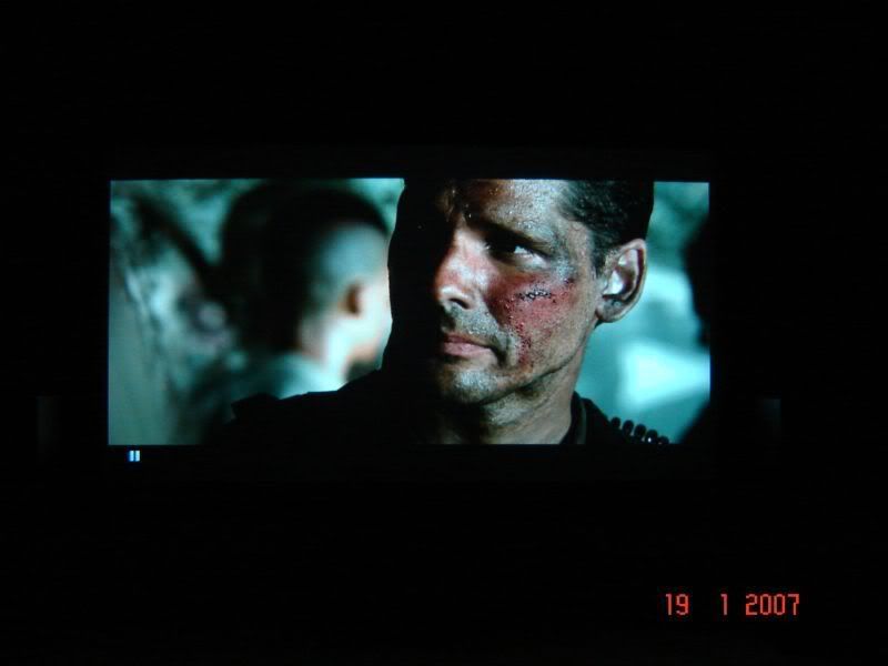

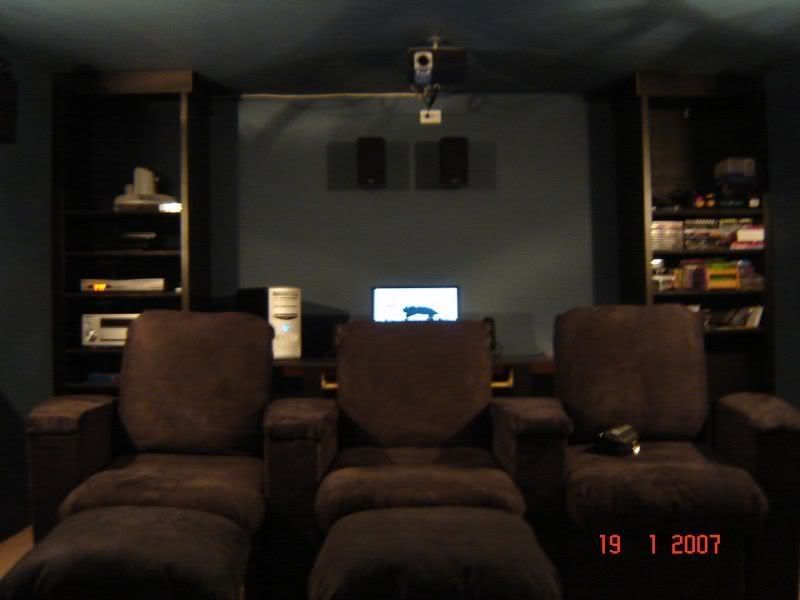

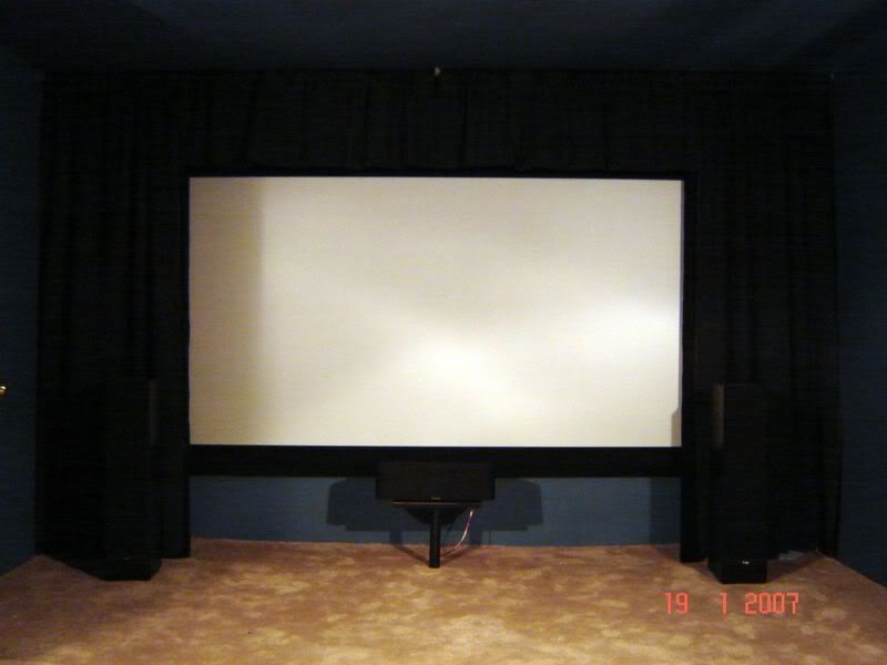

Room Condition: 24' x 12' x 7.5', dark blue walls and ceiling, biege carpet, remote lighting, DIY seating.
Light Control: 100%, no windows.
Projector: Benq PB6100 svga in 16:9 mode=800 x 450 resolution. 1500 Lumans, 2000:1 Contrast (Manufacturer Specs)Upgrade in the fall.
Projector Mount: DIY ceiling , 16'2" throw
Screen Make: Fixed
Screen Material: 3/4" MDF , RS-MaxxMudd (slightly modified to be a bit darker )
Screen Size: 100", 16:9
Approx DIY cost: Around $80
Alterations: On my fourth DIY screen
Recipe if applic:
GTHD on PS3
Nemo DVD
GTHD on PS3
BHD Bluray
Nemo DVD
Screen Lights On
Seating

10 oz. Distilled / Tap Water
(color components)
60 ml (2 oz) Distilled / Tap Water
50 ml Delta Ceramcoat Silver Metallic #02603
50 ml Delta Pale Metallic Gold #02624
30 ml Delta Cardinal Red #02077
17.5 ml Windsor & Newtwon "Galleria" - Pthalo Green (PG7)
15 ml Delta Ultra Blue #02038
BLACK FLAME SL (SUPERLITE)***
*** use 2 oz. of the 'color components' and add/mix it to the 'base & viscosity components'
Applied 5 coats of white gloss base coat (1:.5:.5 UPW Gloss:MinWax Poly:Water) then 5 coats of BlackFlame DIY Mix to ½ MDF substrate.

I haven't checked out this section in a bit.. but I'm game. I'll upload photos shortly.
[size=3]
Room Condition: Room is in a basement with daylight windows. On the wall to the right of the screen I have a dark red on the bottom half of the wall below the windows, a light "popcorn" color on the top half. Screen sits on an 8' tall "popcorn" colored wall. Left wall is same as front wall. Light brown(ish) flecked carpet on the floor. Ceiling is currently open to rafters, will have a drop ceiling shortly.
Light Control: All lights are behind the project. I use room darkening shades to cut out the light from the daylight windows. I'm thinking of adding some fabric of some sort to the edge of the window to cover up the slight light leakage. Only bothersome during the mid-afternoon hours... but doesn't land on screen.
Projector: Panasonic AE-900U. I don't recall the details...
Projector Mount: Ceiling mounted, approx. 14' back from screen
Screen Make: WilsonArt Designer White Laminate. Affixed with mirror clips. Boarder done with MDF baseboard wrapped in double black velvet from JoAnn's.
Screen Material: See above
Screen Size: 16:9, 122" diag.
Height off Floor: Screen sits approx. 3' off of the floor. Just high enough to clear the small entertainment center I built for under the screen.
Approx DIY cost: Hmm... ~$110 for the laminate. ~$20 for the frame. ~$40 for the velvet (I think)
Alterations: Designer White laminate as is... no paint, no poly
Recipe if applic: Buy it, hang it, enjoy it
[/SIZE ]

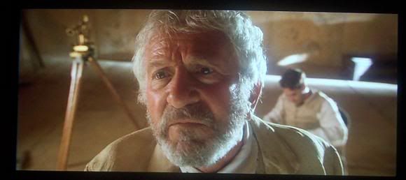

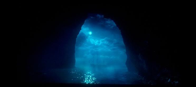

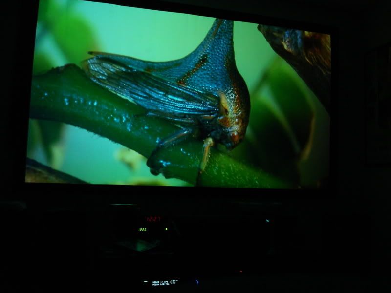

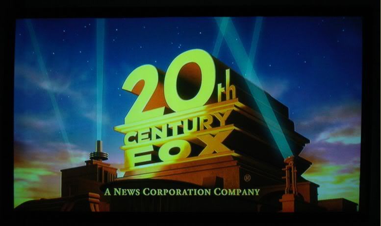

Room Condition: Wall colors are Sherwin Williams Cobble Brown, ceiling is white, and floor is beige carpet.
Light Control: Very good light control. Back wall has 3 windows with pleated blinds with black out material backing with curtains over the blinds. Screen wall has a 4 foot opening that goes from the floor to the ceiling (10 foot) with no door. This has a chocolate brown floor to ceiling curtain. Not completely dark during daylight, but you can't read a book in my theater room either.>
Projector: Mitsubishi HC3000U
Projector Mount: Monkey man diy ceiling mount. 17 Inches from the ceiling to the center of the lens. I used two small bubble levels to level the projector once it was mounted. I projected an image on the wall and then mounted the screen.
Screen Make: DIY stretched black out cloth on wooden frame
Screen Material: black out cloth stretched over wooden frame
Screen Size: 102 inches 16:9
Height off Floor: Screen is approximately 32 inches off the floor
Approx DIY cost: I spent a little under $100 on the screen
Alterations: I rolled on a super super light and modified Silver Fire mix
Recipe if applic: I used the Silver Fire mix however I changed it a lot mostly due to inability to find as much delta paints locally. I used half of the quantity of base components but used a full quart of Behr UPW. To that I added the normal amount of viscosity components and then half the amount of color components. I also rolled two coats of Kilz onto the BOC first.
Here are a few screen shots that aren't the best. I don't have a great camera, but will get better pics in the future. The DVD player is an Oppo 971 and the projector is in low lamp mode with Brilliant Color off and iris off as well. Only brightness and contrast calibration performed using the GetGray DVD.
Nemo at School
Nemo Bruce
Non Superbit 5th Element
