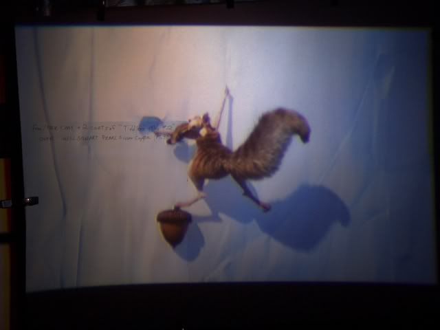

Hi folks-- I finally got some decent comparison shots of the PS90 and both coatings-- taken with a 3.2MP camera, at 2048 x 1536 pixels, auto white balance, and ISO 50. Camera was mounted on a tripod, and I used a time-delay to avoid camera shudder.
I picked a lousy frame ('skrat' was in motion, so he is slightly 'blurred'), but the gain and hotspotting comparisons still apply. First, a shot of the plain uncoated PS90-

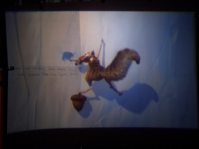

Secondly, a shot of a piece of PS90 with a 'fog coat', and 2 finish coats of "Behr Matte Poly" laid over the uncoated PS90-

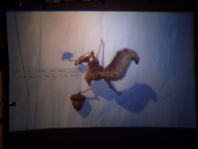

Thirdly, a shot of a piece of PS90 with a 'fog coat', and 2 finish coats of "UncleScurvy's Mix*" laid over the uncoated PS90-

The long and the short of it (maybe better seen in person than these photos) is that the PS90 hotspots, even with our anemic projector. Both "UncleScurvy's Mix" and the "Behr Matte Poly" kill this hotspotting, and reveal greater detail in white areas of the frame.
One of the attractions of the PS90 was the 'luminous glow, almost like a plasma screen' (yeah, but it hotspots.....) that the material displayed. Both coatings decrease the specular gain of the screen. The plain Behr matte poly seems to reduce the gain more than "UncleScurvy's mix". This is probably a result of the reflective particles in the mixture. As Tiddler's "fusion" experiments demonstrated, the particles in the mix 'glow' when lit from 'behind' by reflected light.
These particles are much tinier than an individual pixel (especially on our 30 year old PJ!), so we see no loss in focus-- in fact the consensus of the guys in the room was that there seemed to be 'more detail' in the UncleScurvy's mix side. (of course, we are NOT the connoisseurs that you guys are-- even after I pointed it out and tried to describe it, many of the guys couldn't 'see' the hotspotting, and liked the untreated screen better.
We plan to spray the whole screen with the Wagner and UncleScurvy's mix next week. Again, thanks to all. I'll be posting more shots as I get them!
-bob (UncleScurvy)

it certainly appears from the pics that the behr 780 and the unclescurvy are both removing the hotspot but also softening the pic and yellowing it as well.
the latter is good for better skin tones, yellows, tans, light greens but not so good on white levels and the rest of the color spectrum.
if you are going to use the unclescurvy mix... you might consider doing so without the folk art gold.
pb_maxxx is offline

Well, that's the beauty of photographs (and multiple viewers!). I didn't notice the yellowing, but looking at the photos again, I have to agree- there is a definite yellow-shift. THANK YOU!

Bob,
Did you white balance before shooting or are you on auto? They seem a bit out of focus too. Maybe it's my old eyes though.

Hi mech--
I had AWB on-- the focus does look lousy, but I think its my fault for choosing a frame where the animators wanted to show rapid motion and a fast pan-- I think it was deliberately blurred to look like 'motion blur' from a real camera filming a physical shot. I just paused the film at a point where there was a lot of white-- It didn't occur to me to pick a frame with the characters and background sitting relatively still.
