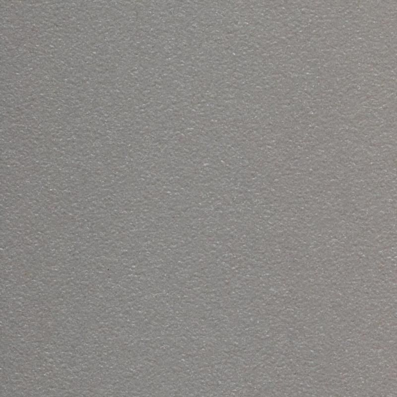

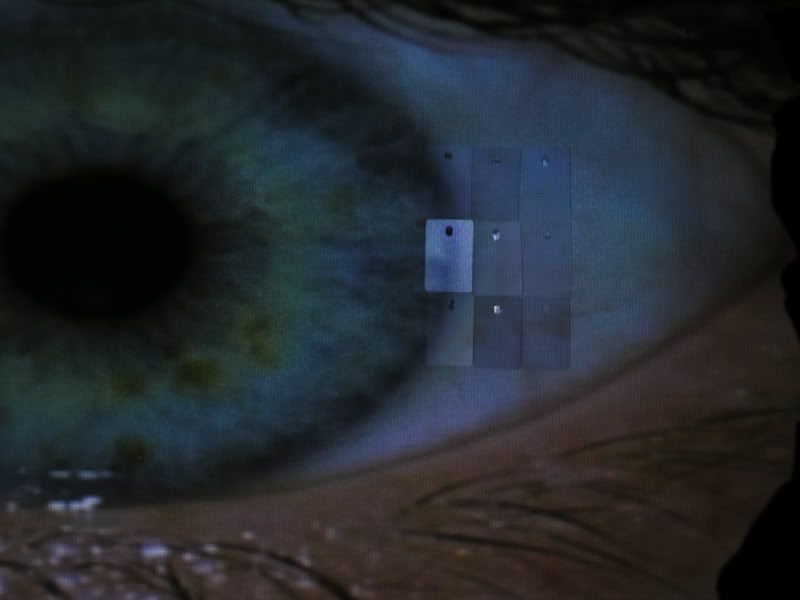

Okay, before anyone gets started on the "Pearl Silver LS is too glossy / we've tried it / do a search in the forums / this won't work" posts, listen to my story.
I called Wilsonart to find out if they produced (or could produce) a matte version of the Pearl Silver (D487-7). The rep told me he'd send me a nice, big sample of the most matte surface they made in that color.
Yesterday I received a large sample of sample D487-90 (along with a 8x11 of D487-7 for reference).
I will post screenshots soon. Here's an initial comparison (the D487-90 is the unmarked, larger sample):
It certainly doesn't hotspot nearly as bad as the gloss surface (no real surprise) and I like the color.
Another flash test:
You might see that the large sample arrived slightly bent / cracked (upper left corner in this picture). I'm somewhat annoyed, but it will not prevent this test from happening.
I'm hoping to do some screenshots of this color in action sometime this week.
What are your impressions?

WOW! I had no idea this would generate this amount of interest!
I know that, during my initial testing, people expressed interested in the Pearl Silver, but specifically pointed out that it was too glossy and reflective.
That's why I wanted to hunt down a less reflective version of this color.
I ordered the sample by calling the hotline number on the back of a Pearl Silver LS sample (800-433-3222). I didn't record the date of the call, but the samples arrived with a sheet showing the request was created 15 January 2007 and as I stated, I received the samples yesterday (Monday, 22 January 2007). I guess that's one week, flat! Not too shabby...
All my samples are downstairs, and I am seriously knee-deep in graduate studies (semester #2), so any off-the-cuff comparisons to FG and DW will have to wait, as will any photos. Spare time for me now is a premium.
One more thing: Does anyone mind if I use my existing CgS as a backdrop for this testing? I am considering mounting the samples with masking tape (it shouldn't harm the surface of the CgS, should it?).
Oh--and something interesting: The "matte Pearl Silver" (which I hereby christen mPS) appears to be vertical grade (which perhaps explains why / how it cracked during shipment).
-p

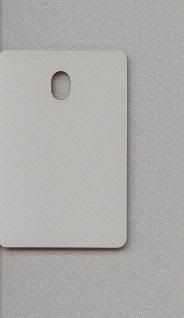

I found a small sample at Home Depot, so I tested it for color. Here's the results:
Pearl Silver LS D487-07
XYZ: 46.59 47.65 54.56
Yxy: 47.65 0.3130 0.3202
RGB: 188 182 188
Very neutral, and about the same lightness as Grayhawk. I'm including a pic of the sample to make sure I've got the right stuff. Tried to take an accurate pic of the surface, but it is very difficult to photograph - the pics consistently make it look like it has more texture and color variation than it does live. This is going to be a very interesting thread!
Garry

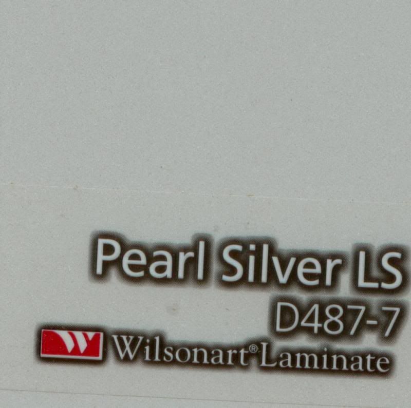

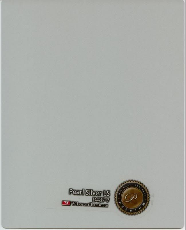

Here are some flatbed scanner grabs. I have some vertical banding going on with my scanner, so all grabs here best reflect what I see with my two, blue, 20/15 eyes.
Edit: Scanned to .tif (no compression), converted to .jpg (absolute minimum compression), imported to photobucket using Flock / photobucket uploader tool.
PS (D487-07)
PS, 600dpi
mPS swatch (D487-90), 75dpi
FG, mPS grab (D487-90), 300dpi
FG, mPS grab (D487-90), 75dpi
pjohnston007 is offline

Originally Posted by wbassett View Post
Wet1... just curious, but how can you tell the gain from just the pictures?
Especially this pic...
Left center is Pearl Silver. That's a pretty good indication of gain. But that small sample is the "-7 textured gloss" finish. A matte finish should really help reduce the glare. The color scan (and the measured 188/182/188 RGB values) in comparison to DG seems nice... the earlier pic looked waaaaay too dark.
I won't switch because CRT doesn't need gray to help with contrast, but I hope this matte finish has less hotspotting and less glare and better ambient light performance than DG.
