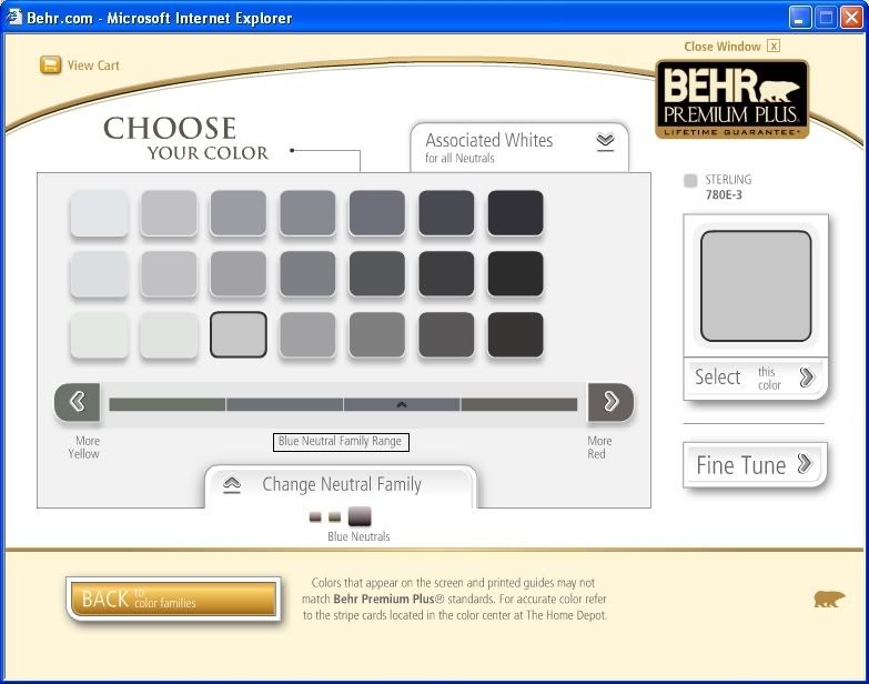

If you pickup the Silverscreen 770E and Sterling 780E color cards when at Home Depot getting some primer, then you can use them as a guide. Don't go any darker than the Silverscreen and I would aim for the Sterling.
Silver Screen? Why is this still being used as a 'staple' and being recommended to new people? Even as a reference... I understand letting people know about the poly coating if they already have a screen made with SS (but if they are going to take their border down and dismantle their screen to put up a coat of poly, why not just repaint at that point? I mean all that work to put the poly on, might as well revamp the whole screen if a person is upgrading or improving things...) ... but for new people that don't have a screen already I really don't know why SS is thrown around.
The family line is the 'Blue Neutral Family Range', same with Sterling.
Sterling is also in the same family line and on the same screen as Silver screen, go down one and to the right...
They don't look that bad on the color swatch or the online Color Smart program, but when compared to a real gray reference it is very noticeable that there is a dominate lean towards blue, which the testing showed and the Family line even confirms.
I personally take a couple of color swatches that have some nice grays that are close to N8 and N9 and compare other brands to them, but we all have our own methods...

Why would that be a last resort? There are a lot of brands of paint out there. Where I live (out in the sticks) there is a True Value right in town, and 9 miles away there is both a Home Depot and a Sherwin Williams. If I make the drive to civilization (Saratoga or Clifton Park) where there is a Home Depot there is always a Lowes close by (usually across the street), and within a shopping radius of a couple of miles there is also Sherwin Williams and Benjamin Moore paint shops. Behr is an 'okay' paint, not the worse brand, but there are better quality paints out there than Behr. Many people prefer Valspar to Behr. I don't know what it's like in Canada, but it is very easy to find paints over here. (For instance Dutch Boys is sold in Walmart as well as Kilz brand of colors... Dutch Boys and Sherwin Williams are the same company, like Glidden and Behr)
I think I understand your mindset, I think you're trying to keep it to one store shopping, I'm just suggesting that there is more out there than just Home Depot and Behr products.
The color cards that Silverscreen and Sterling are on are fairly large and as a visual reference for shade that's the best we have.
Not really, I have color cards from True Value and Sherwin Williams that I use for close matches for N8 and N9 shades.

When I first got my PJ, I was blasting it onto the brownish gray walls that were there, and I could see that while I was amazed at what I was seeing, that the colors weren't right, so I painted it with what I had available, which just happened to be Ben Moore Flat White ceiling paint(I like Ben Moore paints, they roll VG).
It seems to me that alot of the discussions revolving around some of these "Hybrid" incarnations, were based on AL performance, especially when using low lumen PJS (Especially LCDs, like I said, I have been reading this very forum for over the past year, as I KNEW I was getting one), and obviously my DT500 is pretty bright, even at 115", hence the questioning if I were going to be wasting time, going from Flat white(which should be close to even across the 3 colors) to a mix or grey tone.
I TOTALLY agreed on the Neutral reasoning, the first time I started reading that thread, I was actually looking to see if it would make a big difference, considering that I control the lighting in this room, and most of the time, all the lights are OFF.
I also agree that that ceiling MUST be dealt with, I realised that IMMEDIATELY the first time I turned it on, I even suggested above, that I may take some spare tiles I have, and paint them black, the Black tape IS a good idea, because she is already giving resistance to the idea of me painting all the grids black, so Black Elec, tape(or that thin black hockey tape if I can find it would be better) for the gridlines-Thx, great idea.
When I painted the 8" on the sides of the screen, and covered the adjoining wall with TBV, the effect was IMMEDIATE, the reflections on the sides were gone.
I used to paint for a living, both roll and spray(new homes mostly), so painting isn't an issue, more of a PITA than anything.
I looked at that Wagner gun the other day, I was considering buying a wagner anyways because of all the trim and 6 panel doors I have in this house(which are WHITE), 6 panel doors are a real pita, so I actually have a good reason to get one.
I am considering spraying, but it's kind of tight in here, I would have to mask off a large area(adjoining wall- 8" away, ceiling- 1-2" away, horizontal tongue and groove 1-2" below, etc..), and use drops and the like as well, the real problem is ventilation, or should I say lack thereof.
I have access to SW paints(I go there quite a bit actually), Behr paints( NOT my favorite, don't smooth as well as BM), as well as BM, Glidden, PP etc, so I can basically get just about anything I need.
Thanks for the help deciding guys, and sorry for the long post.
