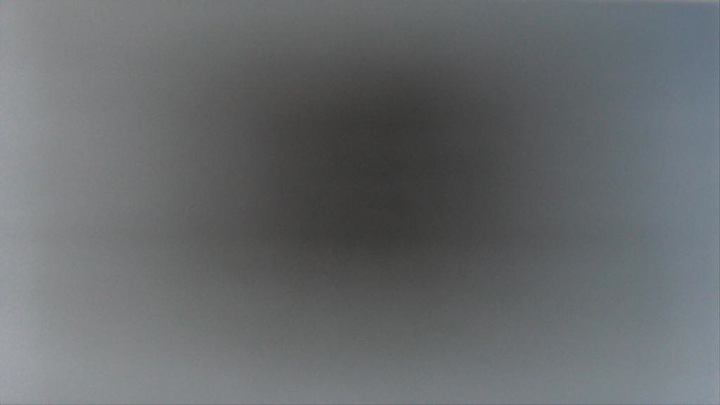

WOW! Here it is inverted or as a negative:
It would be interesting to see how it looks with a white light projected from the projector and no flash on the camera!
mech

Does the bright spot follow you around as you move to the left and right? That really seems like some serious hot spotting to me!!
mech

I think you guys are jumping to conclusions based on screen shots. There is no major hotspot and it certainly doesnt follow you around the room. The screen looks great to me. If you want to talk about hot spots you should have seen the untreated thrifty white before it was painted. It was like looking into the sun!

Flashes aren't going to give you much to go on. Realistically, neither is a white or blue screen. It may reveal uneven places or stripes like I had, but that's about it. Watch a damn movie and see how that goes. Be VERY careful of your source material. Something like LOTR or King Kong or a good Pixar flick will tell you more than a blank screen and a flash bulb.

Pablo,
You may want to do it over.
I put a circle around what would concern me.
mech

It looks like you are getting some hot-spotting with your S-I-L-V-E-R HG screen, but you said that you are happy with the result. That is truly all that matters! Enjoy!

I just thought I would weigh in on the hot spotting issue.
In the end the only way to know for sure if a screen will hot spot is to put it in front of a projector and shine some white light on it. There may be some variation in brightness across the screen as indicated in the various reviews on the projectors themselves.
If indeed there is a round spot that moves with you as you walk sideways across the screen then that is a hot spot. It can be as small as a foot in diameter on a semi-gloss wall or almost as tall as the screen on a low luster surface.
The use of the camera to get an idea of how likely a screen is to have hot spotting issues is valid but not definitive. Like mech I do use this as an indicator. After many sample panels and a few full screen one gets to recognize when a surface will be prone to hot spot under the conditions you have been subjected to.
Most critical is the distance from the sample that the camera is. Since the projectors are usually 1.5 times the width or more away from the screen then I would suggest that flash photos of 2'x4' panels should be taken around 8 to 10 feet away. But again this is only going to give an indication.
There is also the issue of the ability of the particular camera's flash to cast a wide uniform beam similar to a projector.
So while this is a good aid in recognizing if the screen surface will hot spot, it should not be considered the final answer. For that you need to use the projector.
I would also like to point out that hot spotting may not be an issue for some setups. The hot spot is direct reflected off the screen to the viewer. Therefore ceiling mounted projectors may produce a hot spot on a screen. The same screen with a table mounted projector may not have a problem since the direct reflected location is above the ceiling.
It is therefore possible that one person will have hot spotting while another may not.
As always this may be a reasonable compromise for someone's desire for the brightest possible image. Having said that I feel obliged to point out that where possible hot spotting should be minimized or eliminated by reducing the sheen of the screen surface.
P.S. I was also reminded by MM himself, that he used the camera flash to determine when an adequate number of coats of paint had been applied over the acrylic mirrors used as part of the Silver Fire screen solution.
