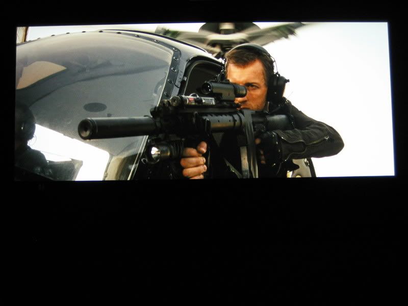

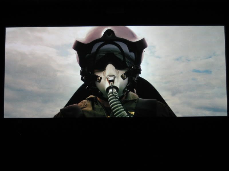

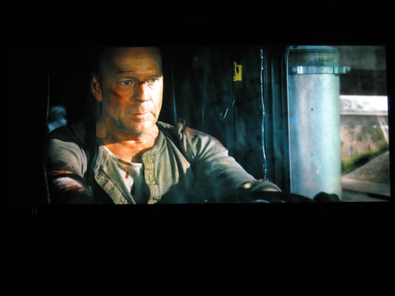

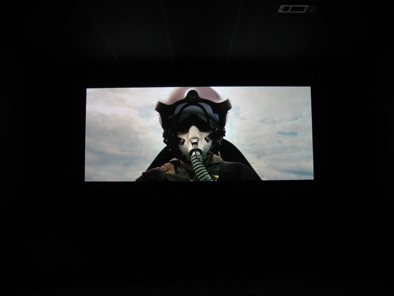

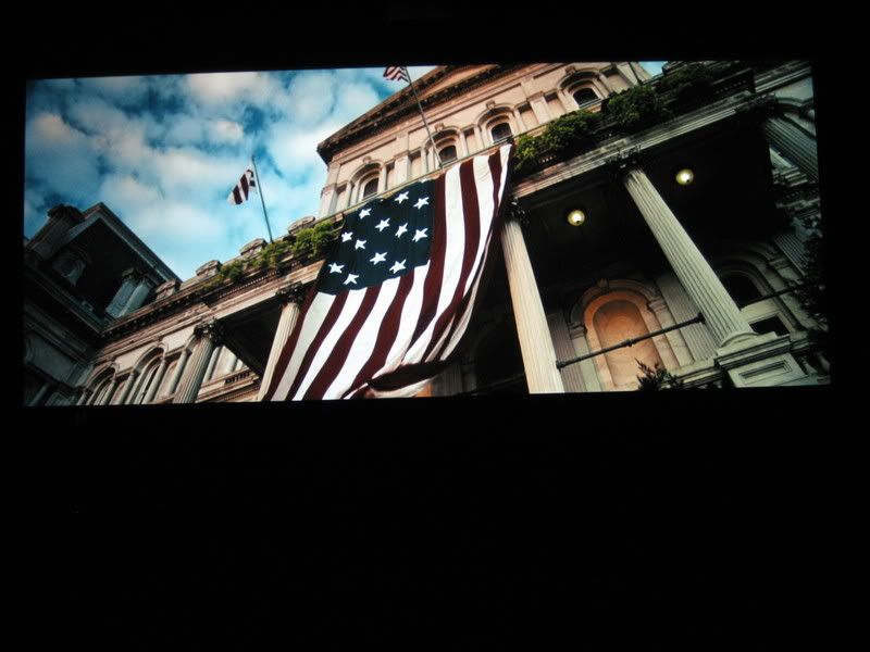

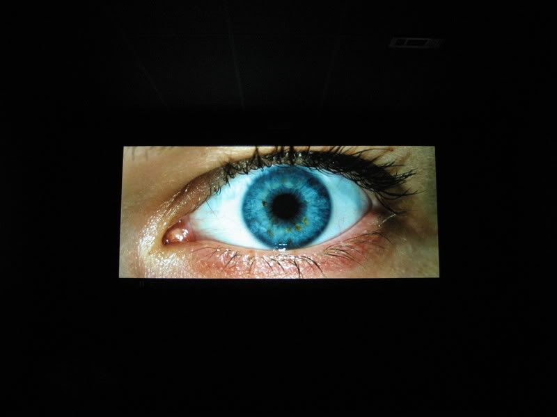

post #368 of 784 Old 04-16-2008, 07:38 AM
Turbo_Tech's Avatar
Location: Atlanta Ga
Posts: 83
Some new pics since I upgraded to bluray......Still love this screen, I'm about to do a new one for a bigger 2.35 scope picture....
S-I-L-V-E-R screen, hd1000 via hdmi from a ps3 spining a bluray disk...
close up
couch view 14' out
I like this one because the camera is shooting willis through the trucks windshield, and you can see the reflection detail in the glass...
I'm watching you, watch me.....
Turbo_Tech is offline
