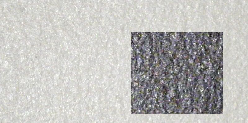

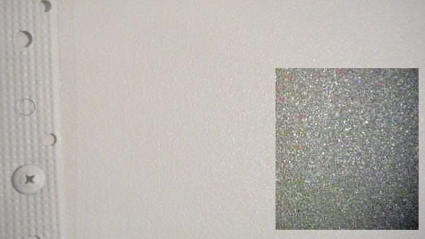

Here, before I start, is an explanation as to the "Salt-n-Peppa" reference that was made. PatWeber showed his proud Poppa colors in his response, and cannot be blamed one bit because S-I-L-V-E-R's performance is something to behold. I'm more critical than most, and a "detail-ist" to the extreme, as is PB_Maxxx, so Pat, you go on defending what you see as perfectly GREAT. 'Cause it is.
The Faux Glaze while acting as a suspending and glare muting agent for the silvered Mica lends a depth to the whole affair that allows one to see beyond and underneath the Mica particles, especially if the concentration of the Mica is sparse. Even after one has reached the 7th-8th coat, if you really REALLY try to notice, you can observe the screen's speckled appearance due to radical differences between the spots where the Mica is and is not. As stated before, this is apparent ONLY in the brightest content, and observable only under closer scrutiny.
This is the fine line you must not cross...to not try to get a surface that is completely coated with Silver Metallic. Or then, you have Hot Spotting, and a reduced viewing cone. and weirdly enough, an actual darkening of the image in some respects due to the reduction of effect from the underlying White surface.
The Behr SM has enough dull, black Mica particles in it to make possible to see 'em in areas where they land. With S-I-L-V-E-R, any such "dark" amongst the "light" is plainly seen upon close inspection.
I'm pretty damn sure CMRA used Behr SM because he had some around. Left over from eons past. He doesn't make many special trips to various stores. It (Behr SM) was the best choice among those SMs known at the time, and still is a good choice.
Strangely enough though, the darker Behr SM gives less boost to CR than the lighter Delta SM does, and while it significantly boost the depth and brilliance of the entire color spectrum, the amount of Gray hue it contains does slightly crush whites. This I believe because the concentration of Mica is greater in the Delta, while the overall hue of the Delta SM is lighter, so the good effects of Silver are retained and whites are even brighter while blacks still get a boost.
To get more gain from S-I-L-V-E-R without creating glare and adverse reflection was my goal. It has been accomplished.

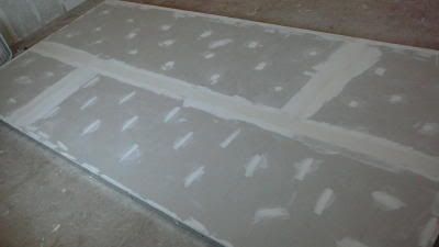

In trying to create a DIY Screen at the most extreme of sizes, I also had to face the lumen output limitations of the projector of choice, a JVC D-ILA RS-1 (AVS acquired)
Just how big is a 16' x 92" screen area?
Way big.
Let's put some clothes on it, shall we?
Here you see a complete covering of "Slurry thin" Drywall compound spread out with a 1/2" nap 9" roller to get a perfectly uniform underlying surface when sanded out. This was the first time I tried this "common sense" method, or rather had "Juan Carlos" do it, my 'Oh so Trusty and Erstwhile Companion from El Salvadore. A truly meticulous fellow who only real fault lie in his competing with me for the beer supply.
Juan Carlos, my fellow AVS'ers. Give him his propers for doing 90% of the surface preparation.

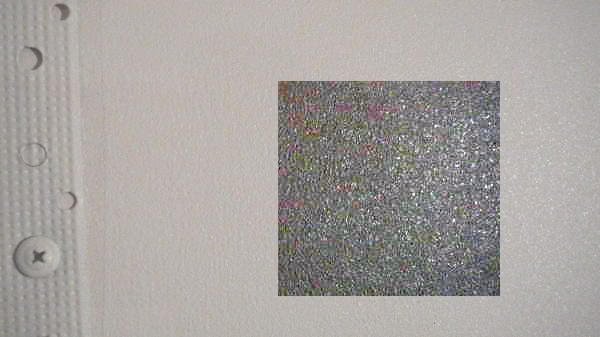

OK. Here are sequenced photos showing appearance and surface texture in the 1st 3 coats of S-I-L-V-E-R HG in normal and Enhanced CR mode to show surface detail and Mica concentration
1st Coat
2nd Coat
3rd Coat
Finial (7th) Coat

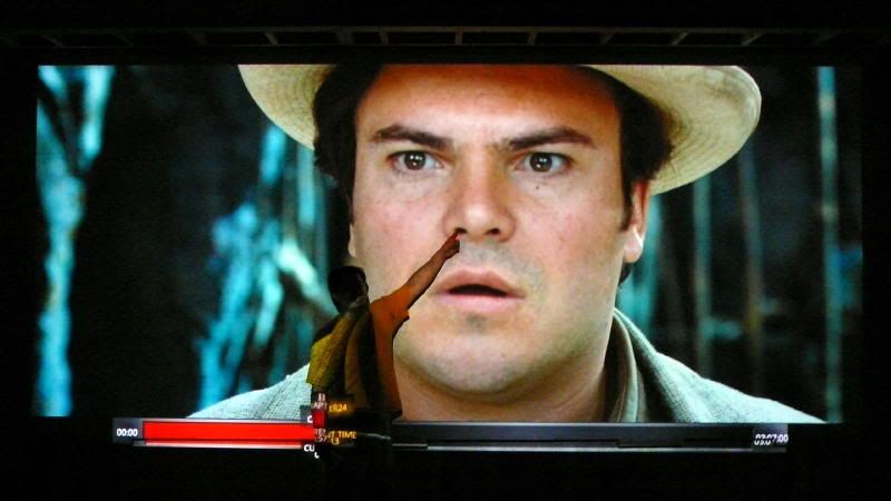

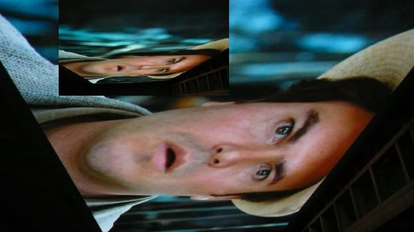

So here my Friends is the proof that lies in the Pudding. And it's brought to you at 16' x 92" of splendid 2.35:1 Eye candy.
I'd go "Ape" for this Lady too.
Don't anybody pick your nose at S-I-L-V-E-R, lest all you come away with is greasy buggers.
And of course, for those who came late to the "Show' and have to crowd along the walls, theres still hope.
I have a bunch of shots taken when I compared S-I-L-V-E-R against straight primer, as well as a Silver Fire mix that also has the highest gain of any so far introduced. Even with that, in dark room performance, the S-I-L-V-E-R HG held it's own on all fronts, and clearly was the winner in the "Blazin' Whites" department.
heresy from the lips of one who hold the SF/BF concept near and dear to his heart and soul?
No way! I'm always for, and always have been supportive of whatever works best, and for dedicated Theaters, I'm sayin' it's back to the 'ol Mixin' Pots fer PB- & I. But don't dare doubt that when faced with such a challenge to "Go to the next Level" that newer and better things are in the offing. 'Cause they are. already. Nuff said fer now about that.
CMRA, I know you've said to me repeatedly, "Why fix it if it ain't broke?" I'm not sayin' that S-I-L-V-E-R in it's original form is busted with all this, but rather, consider this adaptation as the NO2 canister under S-I-L-V-E-R's hood.
Zzzooom!

Originally Posted by tiddler View Post
Just wanted to bump this question before I hit the road. I'll be hoping for an answer when I get back.
RE: S-I-L-V-E-R HG Coats: Is it also possible that you can tune the depth of gray to your taste?
Say you start at some minimum number of coats and then add coats
making the screen very slightly darker each time. That would certainly
solve the how gray should I go. Just keep going until your happy.
I'll answer, and hopefully we'll hear from CMRA as well.
Tuning the Gray "downward" while boosting the silver by using a SM with smaller Mica Flakes is exactly what happened when the darker Behr SM was nudged over by the Delta SM.
But......................, the same advice originally given by CMRA still holds true. You do not want to use too high a concentration of Silver in the mix, and/or apply too many coats of either of the S-I-L-V-E-Rs or you'll wind up with a completely silver surface that is uncontrollable.
It's such a fine line between achieving gain and maintaining Contrast, and Silver solutions are as old as front projection. CMRA's S-I-L-V-E-R came closer than anything else ever has as far as utilizing Silver's benefits while avoiding the adverse attributes like Hot Spotting and narrow viewing cones. The ambient light high gain DIY screen solution, is just that, a solution that is already here, or is almost here. Maybe it will already be old news by the time you get back from the wilderness?
Maybe you otta take a Web-enabled cell Phone with ya?

Now that's what I call a BIG screen.
That's roughly 4 times the area of a typical 2.35 Home Theater. An incredible undertaking in its own right.
And, here I'm drafting up a puny 5'x12' pup. Show off.

Gain? I must use an estimate. Your seeing the first example on earth. But my guess is 2.0 minimum. I'm sure a defining test is in the offing soon however, for there are several souls on DIY Screens with both the time, inclination, and equipment to perform such a task. I choose to guess low, for if higher, redemption, not reproach can be in the offing.
MM, this is from the other thread in DIY Constant Height. If you had a gain of 2, would you not say there is a viewing cone?
Also, to get to a gain of 2, you would require an awful lot of mica in the mix, or an awful lotta sheen. From what I can see, there isn't near enough mica to make a gain of 2. So, there must be a whole lotta sheen. And on a big screen like that, a big hotspot.
Either that or the gain is nowhere near 2. A simple test would confirm both gain and cone.
The picture I posted above tells all, if you bother to examine it.
Do you see ANY hot spotting? I didn't think so. And after 7-8 built-up coatings, there is indeed a lot of SM related Mica in the surface paint, but it's not all on the top layer as in CGII, so it does a better job at reflecting light more evenly.
The "Cone" issue in proven. I believe I stated that a test for gain will confirm the specs. When that happens, we'll all know for certain. Until that occurs, I said I could only make an estimate. But try to extrapolate some common sense from what is being show. A 225" diagonal screen getting hit by at best 700 lumens. Do you think a 1.5 gain screen would do anywhere near as good a job as what is seen above?
The picture doesn't really show us anything about half gain viewing cone. The testing will show us. I hope you can share the results with us.
Again, can't tell from the pictures. You can certainly see it in person. If you didn't, then I will believe you. Again, based on my experience, you still will not have enought mica in 7-8 coats to make a dent in gain. The gloss base, that the silver mica resides in, is what gives you the pop, not the silver mica flakes. I have done alot of testing with silver mica powders and I haven't observed any gain increase by adding more powder to the mix. Actually, the opposite, lower gain, is what I see.
Again, can't tell from the pictures. Only in person. So, if you can attest to the fact that there is quite a bit of gain, I will have to believe you.
Sorry, quotes aren't working for me. Neither is bolding, italics or underlining. So, this may appear a bit jumbled.
And as for baiting, that is not my intention. I would really like to have an intelligent discussion here with good facts and data. Pictures can only tell you so much. Measurements, can tell you a whole lot more.
I will be going out to get the materials for SILVER and dust it on and see if there is any truth to the hype. I gotta see it to believe it.
Meow.
