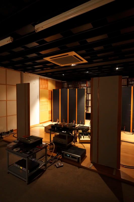

Originally Posted by zoltm View Post
Roger,
Let me show you a photo of a pretty insane friend's setup before we continue with our discussion. That was a massive nightmare seeing him doing the placement of the bass reproducing panels. This system is now performing admirably.
He spend huge amount of effort on the fine tuning and placement. He didi not use any EQ at all in this setup. I would not do that personally. The Antimod and Bob's comments got me re-think. I believe P-EQ is a good technology to help with subs integration to 2 channel.
The front speaker is a pair of Magnepan 3.6 while the back panel is TWO pairs of Tympani 4's bass panel.
Interesting set up.
With that great a distance (=delay) unless he has implemented a method to adjust timing (phase) relationships between the subs and the mains, he is not hearing accurate bass.
It has been said that even the AntiMode causes a small timing error due to the time it takes the DSP to compute the signal.
John
